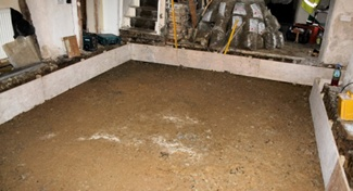

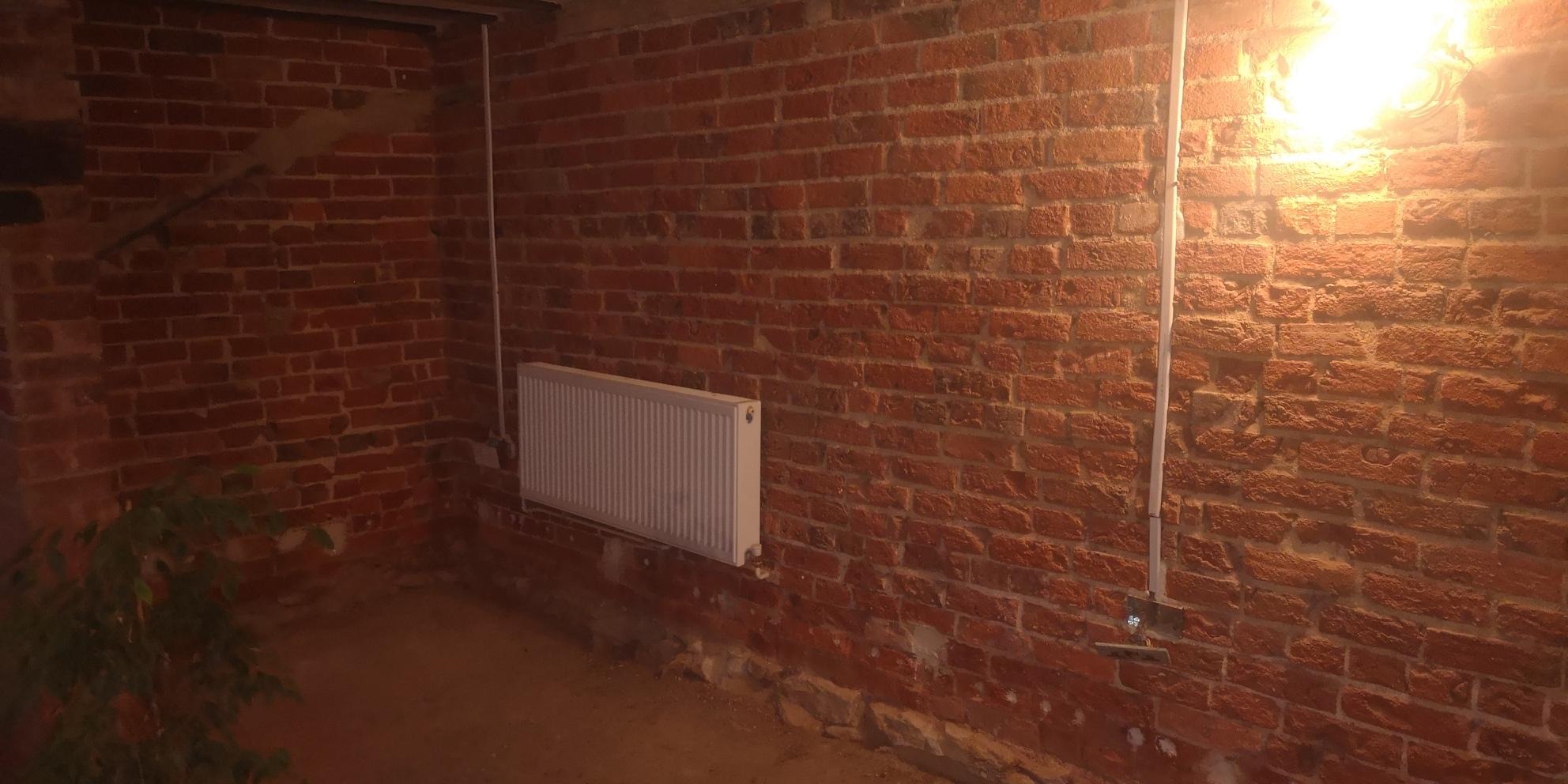

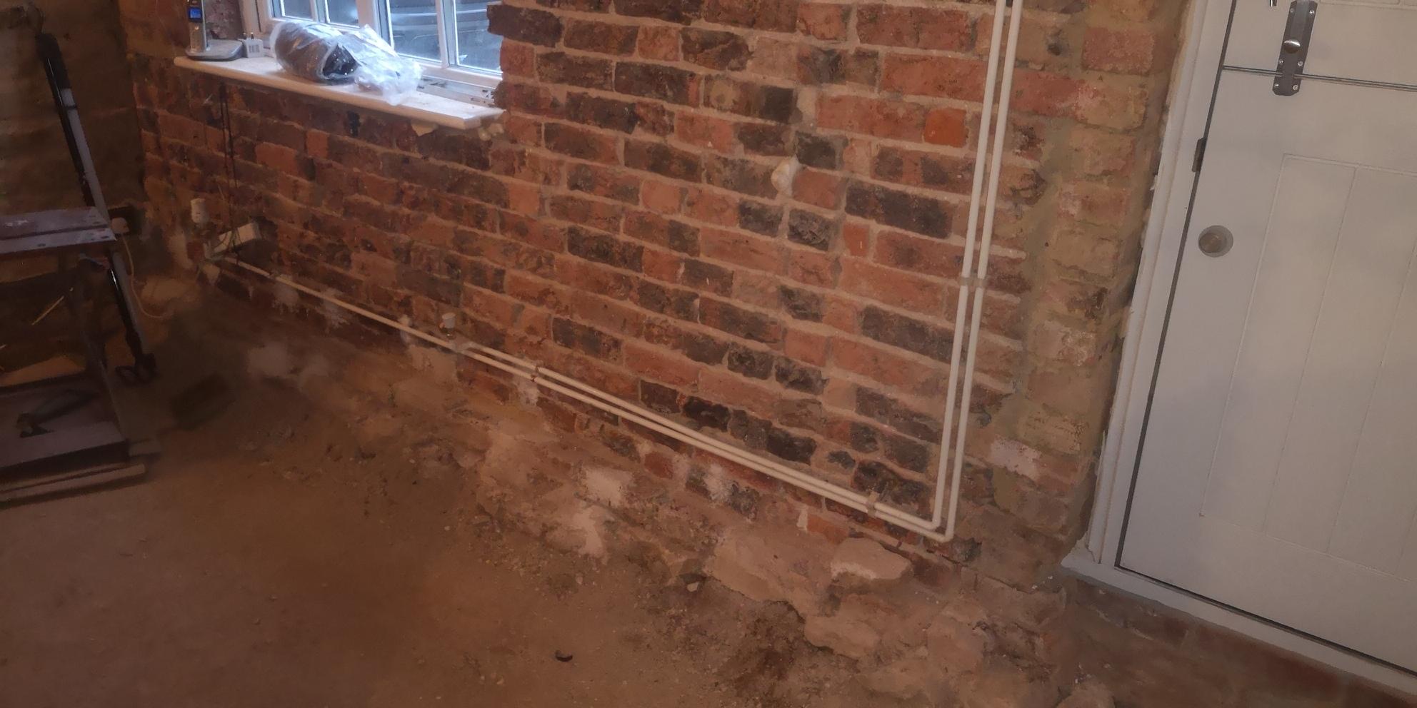

Took it all out. Trying to "blend" the plaster afterwards seems to generally be considered a bad idea. The lime is significantly thicker, and it will crack along the join. Also then allows you to use one of the lime based insulating products.
Ours isnt listed which obviously makes things easier.
Pics below as it stands today. As you can see, its had a chemical injection applied at some point. ABOVE the floor level. Which stopped precisely nothing.
