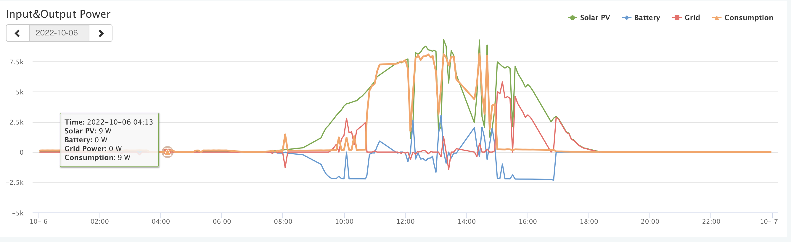

I'm so happy with my setup right now. this was yesterday where I managed to get 104 miles in to the car and then fully charge my 6.4kWh battery storage.
you can see where the solar PV dropped off the battery kicked in to keep charging the car (I have a Hypervolt EV charger) and then at around 3pm the car finished charging and so the batteries started charging while also exporting quite a bit to the grid. I'm hoping that once we actually move in to the house we'll self consume more but it's working well at the moment, even with the batteries in the basement!
