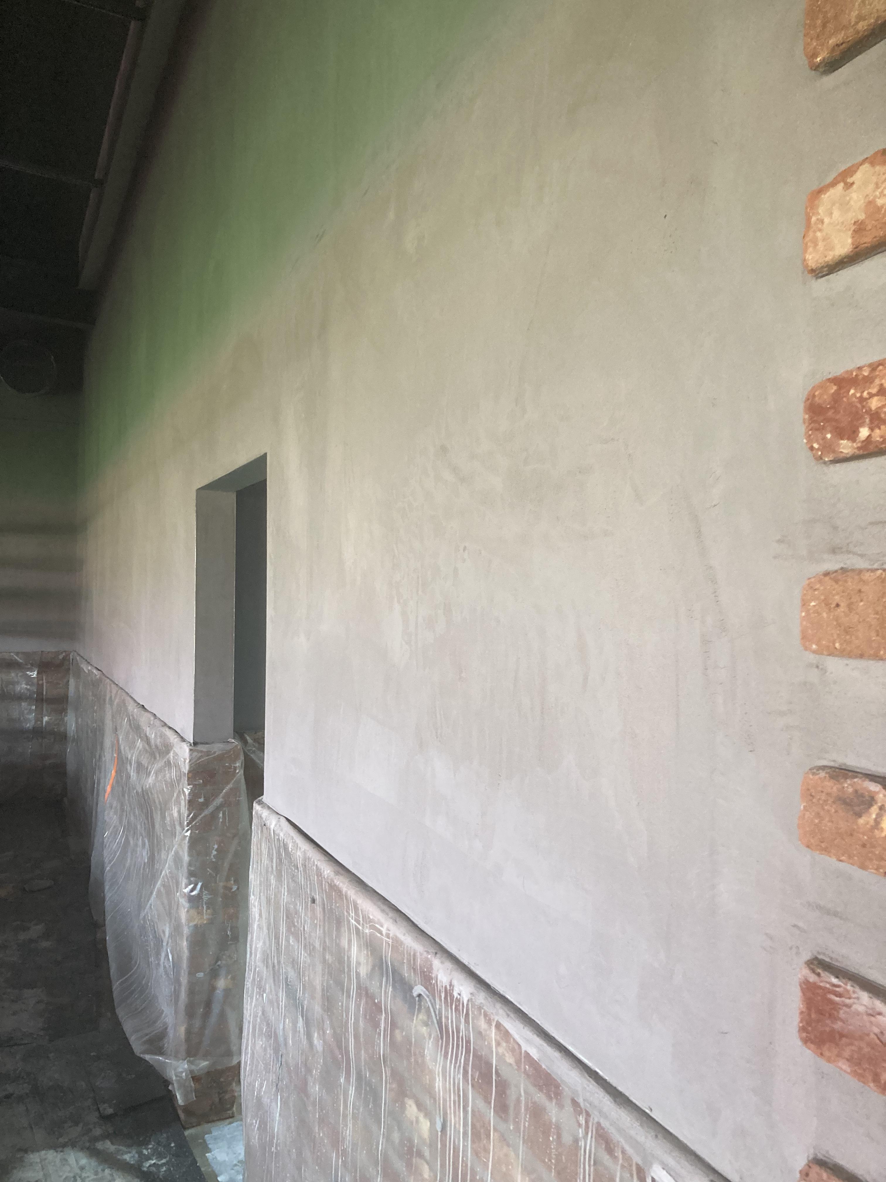

nod Posted November 26, 2021 Share Posted November 26, 2021 1 hour ago, luz624 said: A number of the plasters we plan to use (lime and clay) require temperatures over 5degrees. Our home currently doesn't have heating. We will have boarded up windows/doors until February. Is there any way we can still plaster internally, with the use of gentle heaters (and possibly a dehumidifier). If so, is there any advice for what type of heaters? And a solution for overnight - we are not living at the site, so I'm not sure what heating solutions can be left on while unattended. I’m currently using Clay works on one of our jobs At £80 a bag you need to be careful with the wastage 5d is a guide As long as it doesn’t drop below 0 during the night Definitely don’t use heat Clay needs to dry slowly Or will crack before you get a chance to splay the hardener on 1 Link to comment Share on other sites More sharing options...

nod Posted November 26, 2021 Share Posted November 26, 2021 The Clay works can be applied to plasterboard or fibre board Just needs CW primer first Definitely no heat The lime p and Clay W needs to dry naturally When we us it in summer we leave fans running to stop it drying to quickly Weve just done the boardroom at a football club Which is back in use tomorrow They are not happy that they can’t put the ASHP on till Wednesday When we go back to seal and harden it Be sure to see the installers work prior to them starting the job There are three grades of Clay Works Ive been using Clay Works Lime and Venetian for 35 plus years and still find it difficult to get experienced applicators 1 Link to comment Share on other sites More sharing options...

nod Posted November 30, 2021 Share Posted November 30, 2021 Exactly I’m going to spray the hardener on Clay works on Weds At a multi million pound extension on a football club They have had to delay firing up the bio boiler for nearly three weeks There not happy Your spot on You can’t have your cake and eat it The lime plasters shrink and crack if they are not left to cure Sealing or polishing to early effects the appearance Im lucky that most of this work comes via two very savy designers Link to comment Share on other sites More sharing options...
