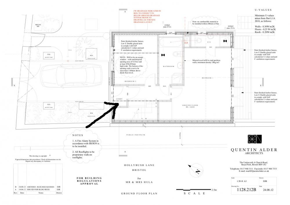

Pocster Posted April 14, 2017 Posted April 14, 2017 (edited) Hey all, Firstly happy Easter!; not too many eggs now ...... Please see plan attachment.My subtle arrow shows a floor 'nib'; but how do I construct this? There's a steel running parallel to it (can supply photo if that helps). But how do I build this self supporting bit of floor??? Also; opinions please. The architect has the bathroom door opening into the hallway and potentially someone's face as they leave the bathroom. Surely the bathroom door should open inwards? i.e. into the room. Or is there a potential reason he designed it like this that I am missing??? Thanks all!! Edited April 14, 2017 by pocster
Jeremy Harris Posted April 14, 2017 Posted April 14, 2017 Not sure about the "nib". The bathroom door is possibly to meet the requirements of Part M, specifically wheelchair access from the entrance level to the WC on that level. Our downstairs WC has an outward opening door for the same reason, as it avoids having to make the space larger to accommodate the requirement to be able to get a wheelchair in and close the door.
Pocster Posted April 14, 2017 Author Posted April 14, 2017 29 minutes ago, JSHarris said: Not sure about the "nib". The bathroom door is possibly to meet the requirements of Part M, specifically wheelchair access from the entrance level to the WC on that level. Our downstairs WC has an outward opening door for the same reason, as it avoids having to make the space larger to accommodate the requirement to be able to get a wheelchair in and close the door. Ok!. But if it opened inwards would the opening width not be the same??? By the drawing I would *assume* with a door inwards you could still get a wheelchair in. If I do change this am I likely to get in trouble from BCO?????
Jeremy Harris Posted April 14, 2017 Posted April 14, 2017 (edited) Best check the space available in the bathroom after taking away the door swept area. The required spaces are here: https://www.gov.uk/government/uploads/system/uploads/attachment_data/file/506503/BR_PDF_AD_M1_2015_with_2016_amendments_V3.pdf Note that the regs also normally require an outward opening door. Edited April 14, 2017 by JSHarris
Pocster Posted April 14, 2017 Author Posted April 14, 2017 6 minutes ago, JSHarris said: Best check the space available in the bathroom after taking away the door swept area. The required spaces are here: https://www.gov.uk/government/uploads/system/uploads/attachment_data/file/506503/BR_PDF_AD_M1_2015_with_2016_amendments_V3.pdf Note that the regs also normally require an outward opening door. Crumbs!; there's some reading there!. Thanks for that!. I do see that the door usually opens outwards .... straight into the face of the occupant leaving the bedroom! Though I could integrate a sliding i.e. expensive door for the bathroom.......
Ian Posted April 14, 2017 Posted April 14, 2017 42 minutes ago, pocster said: Crumbs!; there's some reading there!. Thanks for that!. I do see that the door usually opens outwards .... straight into the face of the occupant leaving the bedroom! Though I could integrate a sliding i.e. expensive door for the bathroom....... It's worth asking your Building Inspector first as they have the authority to allow variations to the requirements laid out in the Approved Documents
Pocster Posted April 14, 2017 Author Posted April 14, 2017 (edited) 2 hours ago, Ian said: It's worth asking your Building Inspector first as they have the authority to allow variations to the requirements laid out in the Approved Documents OK; I will - thanks Now guys!; this Nib!!! Edited April 14, 2017 by pocster
Pocster Posted April 14, 2017 Author Posted April 14, 2017 What about a steel sheet bolted across to make this extra floor? Surely I don't need an SE for this - cost more than the steel...... Oh architect! ; please design stuff; not just nice pictures.....
