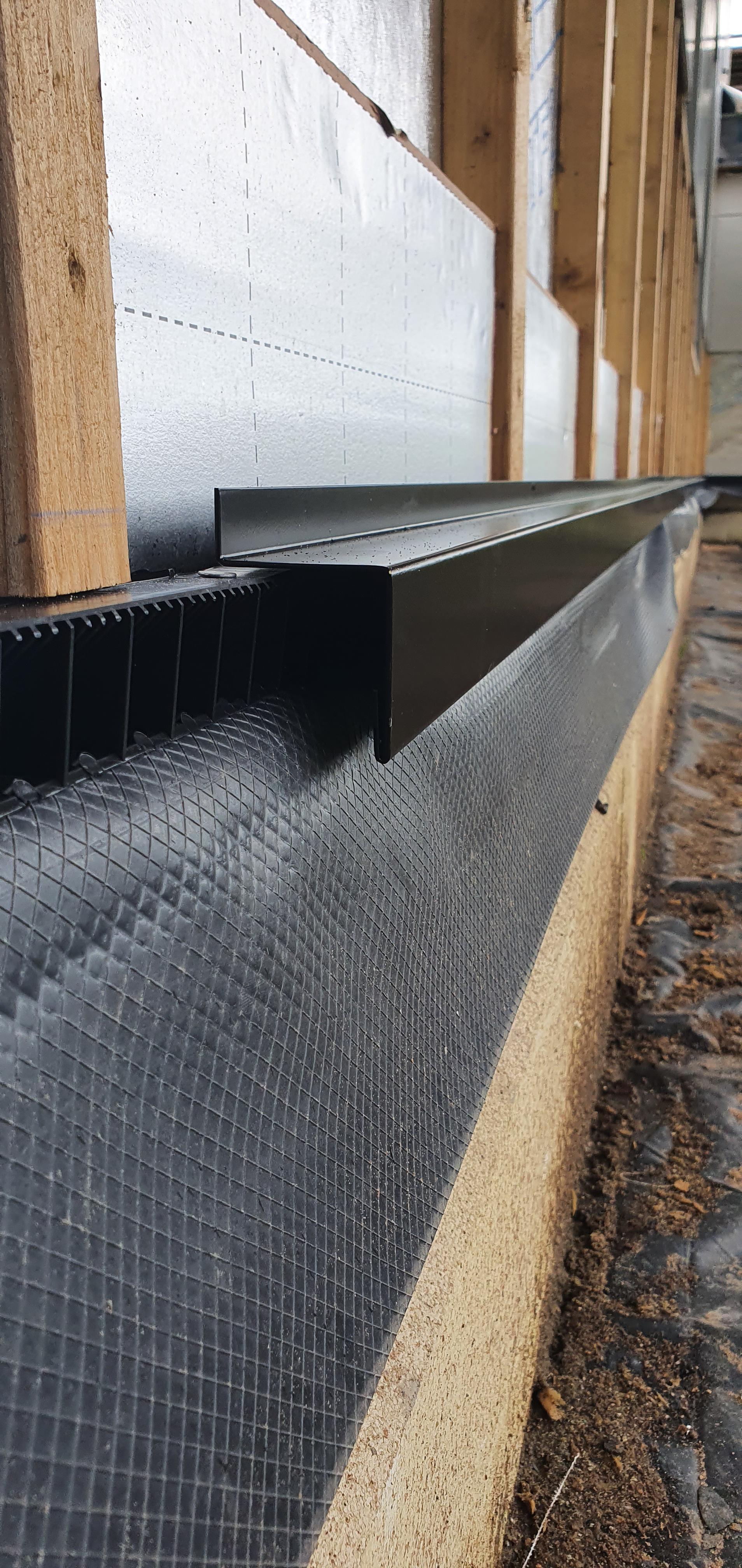

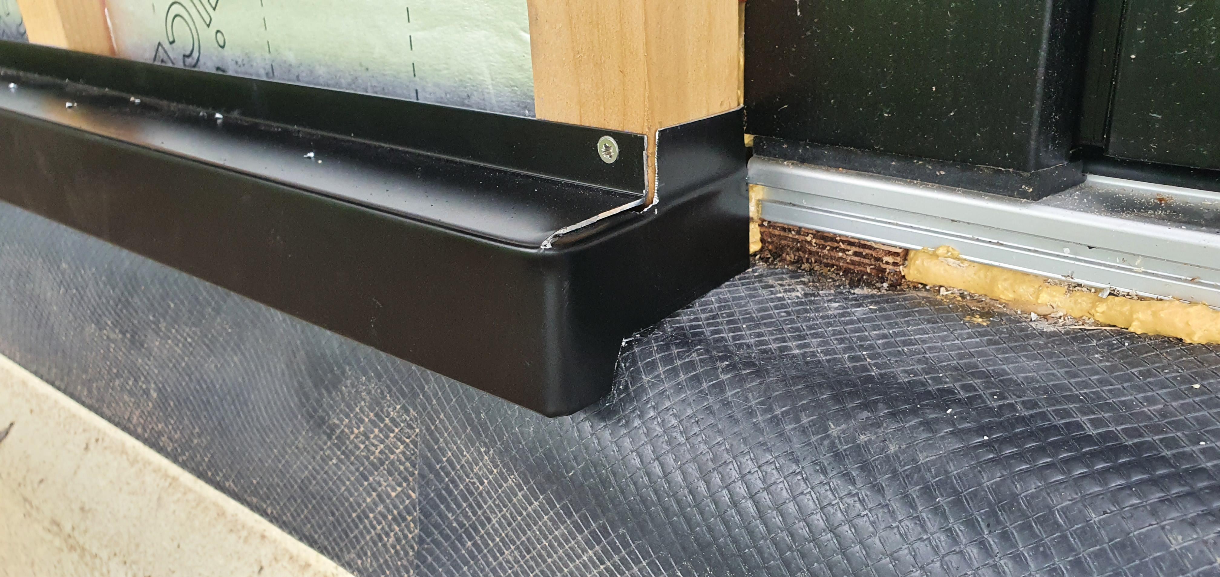

iSelfBuild Posted November 15, 2021 Posted November 15, 2021 Does Anyone know of a company who can make custom aluminium window/door threshold extensions. Bit of a fudge up with a couple of entrance doors and I need to extend it 80mm - a 3 bend system. Looked online everywhere and can't find anything so looking for recomendations.
SuperJohnG Posted November 15, 2021 Posted November 15, 2021 Any fabrication shop can make what you need likely. I had custom trims made for around my insulated slab, which had 3 bends.
craig Posted November 15, 2021 Posted November 15, 2021 3 hours ago, iSelfBuild said: Does Anyone know of a company who can make custom aluminium window/door threshold extensions. You need to have a robust extension that can take the weight of someone standing on them. Standard 2mm aluminium profiles are not strong enough, you need to have what is referred to as a balcony profile and 4mm thick. If you google "Archital", they'll be able to help you and should be able to match the colour to your requirements.
