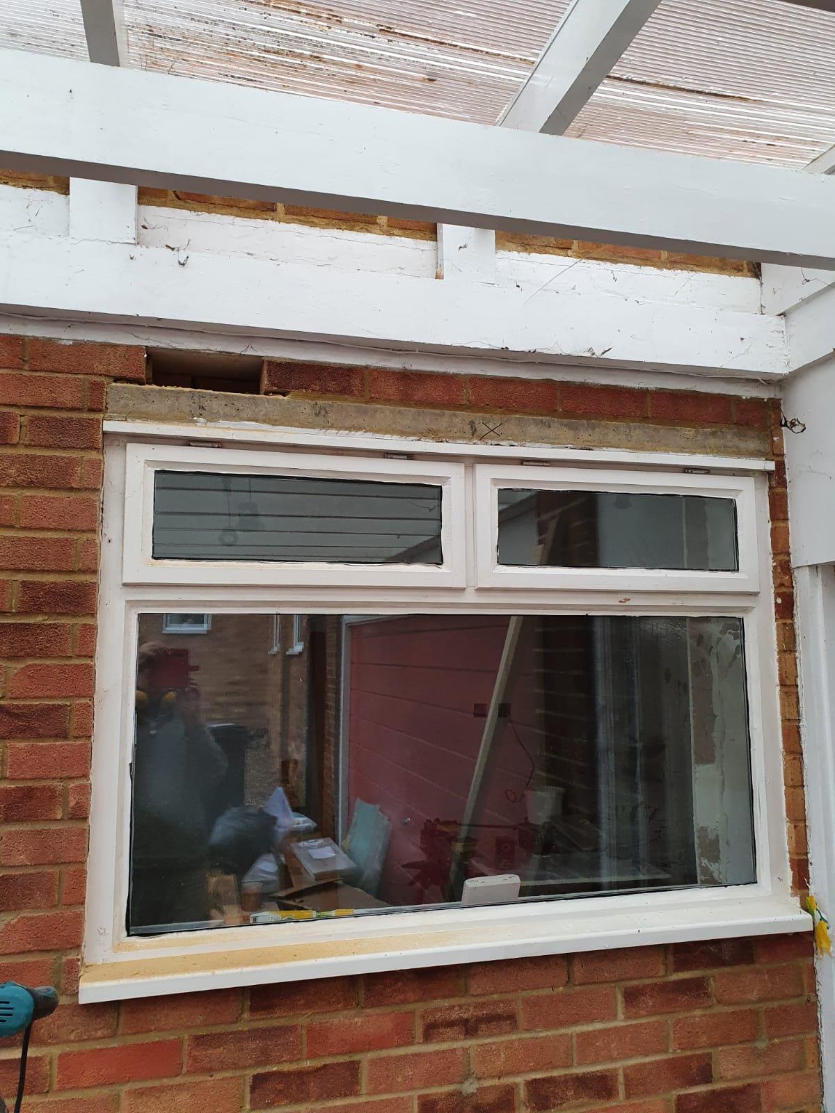

Marvin Posted November 12, 2021 Share Posted November 12, 2021 Any one who doesn't know what is wrong with this picture needs to learn some basics. Link to comment Share on other sites More sharing options...
Mr Punter Posted November 12, 2021 Share Posted November 12, 2021 Could be a concrete boot lintel. Link to comment Share on other sites More sharing options...
keith65 Posted November 12, 2021 Share Posted November 12, 2021 The lintel should extend 100mm each side of the window unless there is another one above, but a lintel needs to be supported on something not on the window Link to comment Share on other sites More sharing options...
Mr Punter Posted November 12, 2021 Share Posted November 12, 2021 1 minute ago, keith65 said: The lintel should extend 100mm each side of the window unless there is another one above, but a lintel needs to be supported on something not on the window The boot lintels are supported on the inner leaf and don't have an overhang. I think they fail quite often though. Link to comment Share on other sites More sharing options...
Marvin Posted November 12, 2021 Author Share Posted November 12, 2021 (edited) Yes... and now.. with think it was a filler.... Edited November 12, 2021 by Marvin Missed a word Link to comment Share on other sites More sharing options...
