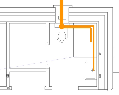

I’m having a real brain fog moment with the layout of our ground floor WC/Shower.
The wastes are going to have to be in the slab so I’ll need to create a channel former so I can run the wastes.

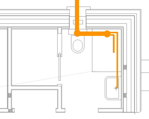

I’n my rather crude drawing below I’ve got a section of soil pipe that runs underground and then two separate wastes (50mm for the shower and 40mm for the basin) going to that stub (which will be below the slab level).
Or could I get away with extending the 50mm and 40mm wastes to just the one stack used by the toilet. The run would be circa 3.5m for the sink.
All this is going to be slab level so will be inaccessible so I want it to be right.
Input hugely appreciated.

I'd be tempted to go with the 2nd option and run the small diameter wastes direct to the WC soil stack. Could you not take a direct route to the WC stack instead of introducing 90 deg junctions?

Its an interesting point. I did think that but some some reason I have this thought that services should always run round the outside of a room. What that thought is based on though I'm not entirely sure :)

Option 2 is fine, but I'd use 2 x 45* bends instead of 1 x 90* on each run.
Youll be able to rod back from the shower to the soil with ease, and if you do the same at the invert for the basin you'll be able to back rod that all the way to the soil too. :).
