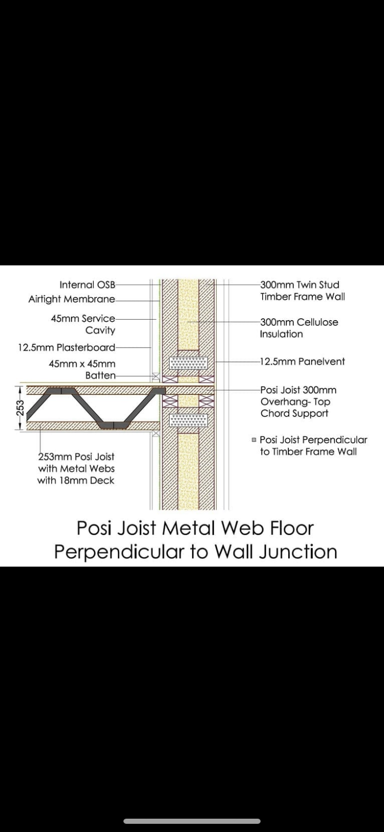

my timber frame, I believe the order of materials to be:
cladding
25mm batten
breather membrane
osb
145 cls stud containing 140mm frametherm.
then inside:
50mm pir board?
25mm service batten
plasterboard.
the inside layers is maybe the ‘grey area’ for me, certainly where I would put the  airtight layer?
also- around the joists, fold a strip around the end during construction or cut around afterwards?
joists like this but not the passiv wall.
Tony tray
Like on the drawing, first layer on the OSB
Do a Tony tray trick : continue the membrane under the overhang and then over with the same continuos piece of the membrane. Cutting and sealing around joists is a bitch, hours of faff with the tape not worth £5 spent on extra stretch of the membrane.

Ah - Tony Tray sounds like what I had in mind :)
I won’t have the internal osb layer so airtight over the studs, behind the pir and service void :)
Make sure removal of OSB skin will not affect structural properties of the wall, it may be there not only to keep the cellulose in place
Internally I'd go 50mm PIR fixed to the 140mm timber frame, airtight vapor layer, 25mm battens and then the plasterboard.
You don't have to have OSB on both sides. You do on twin stud walls and in some other cases but if you've only a 140mm stud then you generally don't need it. Obviously check with your engineer. The reason I'd go this route with the airtight vapor control layer is you can see it and patch it. eg if an electrician drills a hole for an external light you can seal the penetration or if an area wasn't taped correctly you can easily see and repair it. If you use an internal OSB layer as the airtight layer, then have PIR and the battens forming the service cavity you'll have to rip a chunk of the PIR off to enable you tape the electrical cable to the OSB or repair the poorly taped joint, etc. Also the airtight vapor control layer is a lot cheaper than an additional unnecessary layer of OSB.
