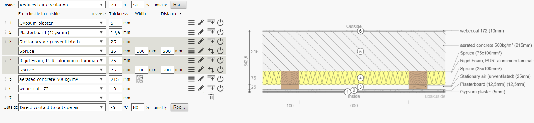

tvrulesme Posted November 8, 2021 Share Posted November 8, 2021 I'm in the process of planning a detached garage conversion. The wall will need to hold some pretty heavy and important things like: Boiler Consumer unit Wall mounted server cabinet So strength of fixings is going to be important as well as insulation and U/R values. Reading up it looks like fixings for insulated plasterboard are a bit of a pain and don't get great reviews so leaning towards Stud walls with PIR between and plasterboard on top making sure I have extra timber where needed. Given the construction (from planning permission history) is rendered 200mm lightweight block-work. How do I go about calculating the construction for insulation? I seem to be reading conflicting info on whether you need a void depending on whether you have a vapour barrier or not so my initial thoughts from outside-in are: Render 200mm block-work Damp Proof Membrane (any reason why not?) 100mm studs filled with 100mm foil backed PIR Vapour Barrier 12.5mm Plasterboard Skim Layer Is this going to achieve the 0.30 W/m²·K to satisfy Approved Document L - England, Existing Buildings - Refurbishment requirements? Block-work looks like this currently Link to comment Share on other sites More sharing options...
MikeGrahamT21 Posted November 8, 2021 Share Posted November 8, 2021 Couple of points... Your 100mm studs, should be installed with 75mm foil PIR to give a 25mm air gap to the inside so the foil works. Don't put a vapour barrier on either side. The Foil will act as the barrier, just tape over the studs with foil tape. Link to comment Share on other sites More sharing options...
tvrulesme Posted November 8, 2021 Author Share Posted November 8, 2021 12 minutes ago, MikeGrahamT21 said: Couple of points... Your 100mm studs, should be installed with 75mm foil PIR to give a 25mm air gap to the inside so the foil works. Don't put a vapour barrier on either side. The Foil will act as the barrier, just tape over the studs with foil tape. Awesome thank you. So: Render 200mm block-work 100mm studs filled with 75mm foil backed PIR Foil tape for joints 12.5mm Plasterboard Skim Layer Any idea where to get the U-values this would generate? Link to comment Share on other sites More sharing options...
MikeGrahamT21 Posted November 8, 2021 Share Posted November 8, 2021 Blocks will be 215mm, look to be aircrete from the photo. u-value will be as follows: 1 Link to comment Share on other sites More sharing options...
MikeGrahamT21 Posted November 8, 2021 Share Posted November 8, 2021 36 minutes ago, MikeGrahamT21 said: Blocks will be 215mm, look to be aircrete from the photo. u-value will be as follows: Sorry just realised that didn't even include the u-value! It came out at 0.23U Link to comment Share on other sites More sharing options...
tvrulesme Posted November 8, 2021 Author Share Posted November 8, 2021 (edited) 18 minutes ago, MikeGrahamT21 said: Sorry just realised that didn't even include the u-value! It came out at 0.23U Thanks a lot Mike. You missing it off actually prompted me to use www.ubakus.com. What a fantastic site. Will be using this again and again Edited November 8, 2021 by tvrulesme Link to comment Share on other sites More sharing options...
