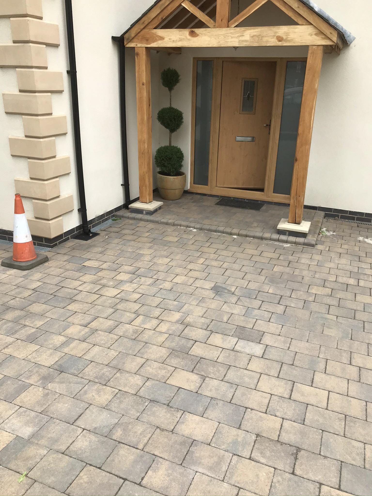

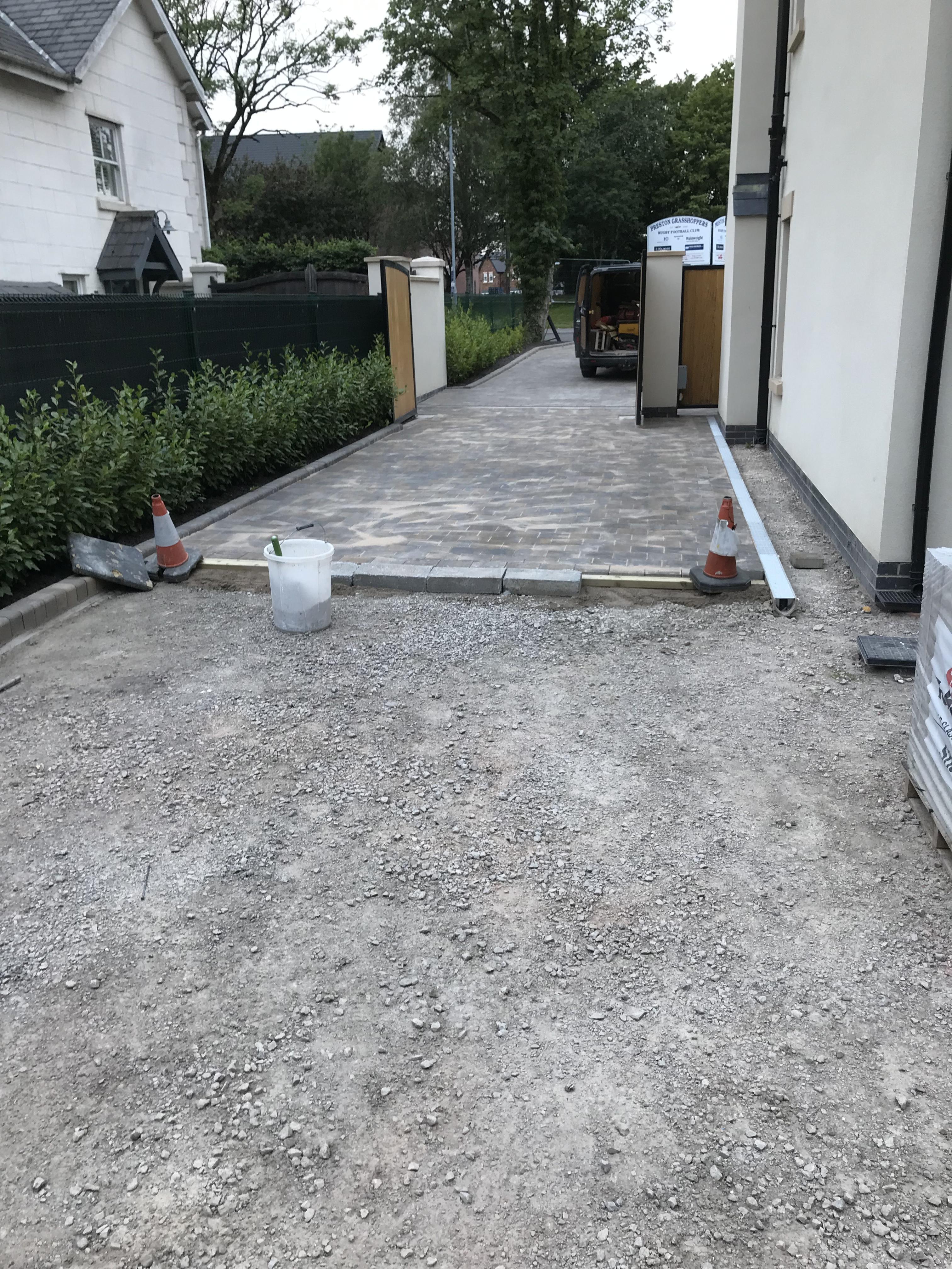

We used 400m2 of Toblemore
Rock solid mot with 50 of grit sand on top
BC where  fine No probs with drainage
