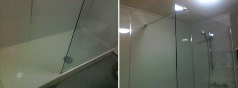

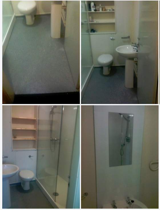

Ferdinand Posted April 9, 2017 Posted April 9, 2017 (edited) I guess you could use a sacrificial or washable insert cut to size. Horse matting or the trad rubber material for matts used in baths to prevent a-over-t slippage by grandma springs to mind, but I am sure people have better suggestions. I second the use of commercial but aesthetic wet-room or changing room lining materials. I have these in bathrooms in student houses refurbished in about 2012 for the entire bathroom floor so they cannot inundate the room below easily, and 4 years later they seem to be as solid as a rock. (Update: so I remember we used Polyflor Polysafe Hydro in Woodland Grey and it cost about £300 for the floor in a compact bathroom, fitted. They key was finding someone who was inexpensive to fit. And we did 4 bathrooms :-) ), http://www.polyflor.com/jh/products.nsf/products!open&family=saf&prodcode=fxsc151 A related point is perhaps to make sure that there is a grab rail or handle available. Once a year spriing clean with a pressuree washer? Ferdinand Edited April 12, 2017 by Ferdinand

Ferdinand Posted April 12, 2017 Posted April 12, 2017 (edited) @MAB Are those plastic trays, or stone resin? I have bought my recent showers from sources discovered via ebay. The last ones were from UK manufacturers who maintained an ebay shop. For example, here is a stone resin one with a drying area which is about £250 in your size including raised legs and fastflow waste http://www.ebay.co.uk/itm/Rectangle-Shower-Tray-with-Drying-Area-Low-Profile-Stone-Resin-Acrylic-Capped-/262453435127?var=&hash=item3d1b719af7:m:mjHGTupoOJkD72qT2tt-ckQ (Free delivery E&W :-) ! You need to dig a little for the one you want. There also seem to be antislip ones too. If you are planning a fixed screen (you want the 8mm type with a bracing bar at the top) then they are from around £300. eg Stone Resin 800x1700 bnut not drying area with side panel and flipper panel (which I would leave off) for £250. http://www.ebay.co.uk/itm/Wet-Room-Walk-In-Shower-Enclosure-and-Tray-Glass-Screen-Cubicle-Flipper-Panel-/282194371739?var=&hash=item41b418649b:m:mMClUuukEIRK0pd2nvCOt1g (Buggers to carry upstairs - ours below in a student house took 4 people to move the screens up 2 storeys) Ferdinand 'orrible photos but show what I mean. These have been in a student house since 2013 without a tremor. The screen and tray were about £300 each incl. waste and delivery. That floor is Ployflor Polysafe Hydro (hotel spas, shower areas, swimming pool surrounds etc) at about £300 a pop fitted in 4 bathrooms at once. http://polyflor.com/jh/products.nsf/products!open&family=saf&prodcode=fxsc151 Edited April 12, 2017 by Ferdinand 1
