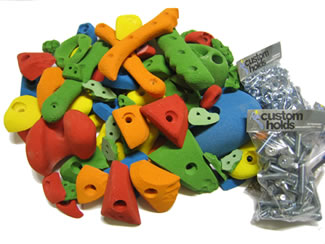

SteamyTea Posted October 25, 2021 Posted October 25, 2021 Don't do any pointing and get some of these. Then do some proper climbing.
