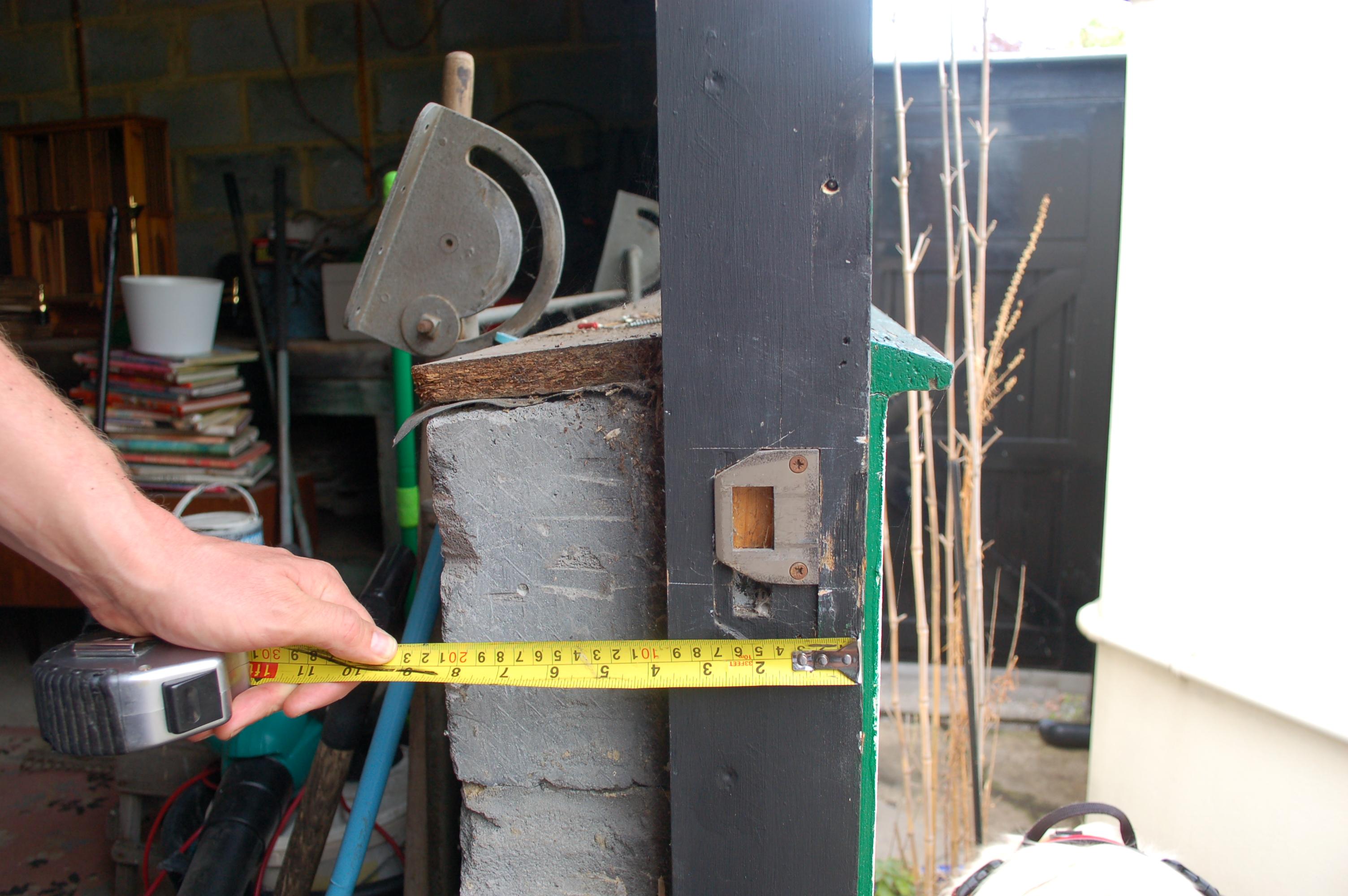

I'm looking in to converting a detached garage to a living space. The wall construction is 200mm lightweight blockwork rendered externally.
As the garage goes right up to the boundary my only option is internal wall insulation. I will need multiple things attached securely to the wall (toilet, boiler, sink etc) so I think insulated plasterboard is going to be too much of a pain to use.
If I use internal studwork with foil backed PIR between studs does anyone have an idea of the best construction for this which will achieve a 0.28 u-value or lower to satisfy building regs?
I was thinking of 100mm studs with
  • 75mm foil backed insulation pressed up to block work
  • 25mm void
  • OSB board pattress where strong fixings are required
  • 300GA Vapour Barrier
  • 12.5mm Gyproc Wallboard
  • Plaster Skim
Questions are:
  1. Does this sound sensible?
  2. Would it be better to have insulation flush with front of studs?
  3. Can I use the 25m void to run cables/pipes?
