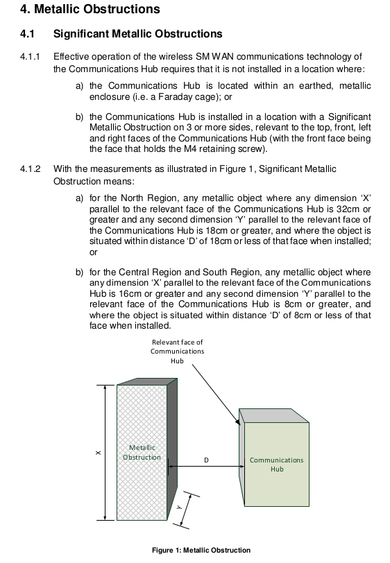

Hi guys quick background
Self build house - dno installed power to plot boundary in a metal kiosk that houses our smart meter, (supply then runs to our cu in the house)
Desperately trying to join Octopus go as we are on ASHP but can't as our smet2 meter wont communicate with DCC
They seem to think its due to the meter being housed in a metal cabinet apparently there was a some small amount of data sent which they guess was when door was open - which im going to do a another test with them to see if this is the case
we are in North Yorkshire so meter works with arqiva on radio waves
anyone had this issue with their smart meter not communicating due to metal cabinet , if this is the cause how and who would i contact to get it rehoused , is this even possible?
