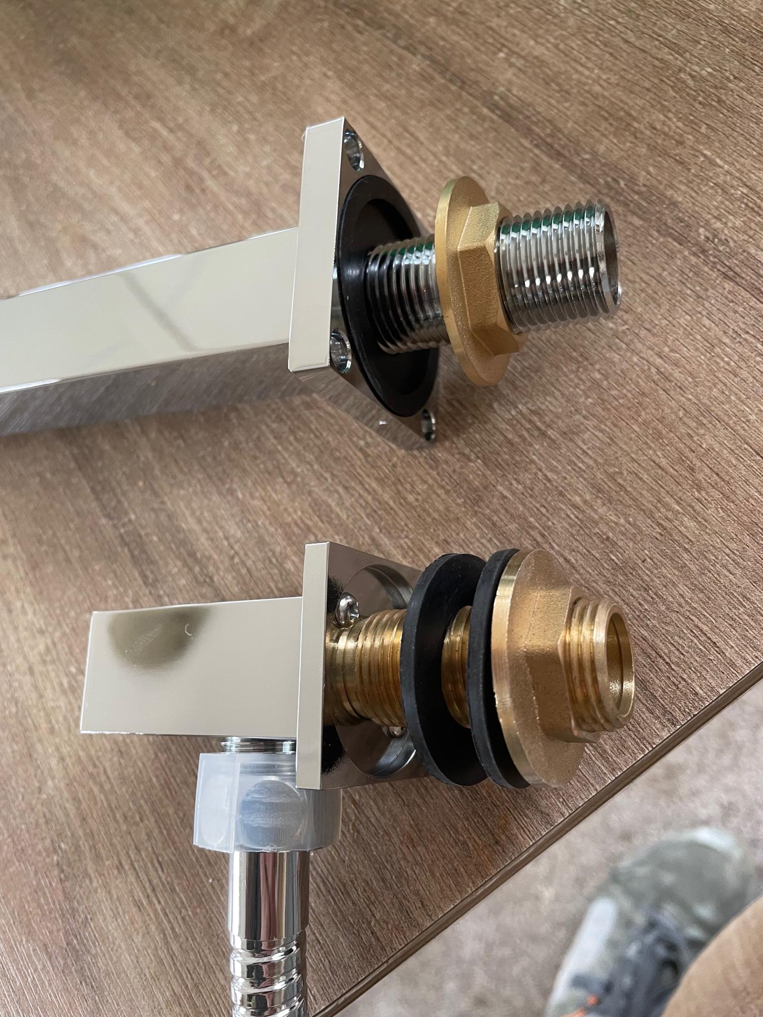

Hi, just finishing installing shower mixers and trying to stay one step a head of the plasterers. the shower mixers have two wall mounted outlets - one rainfall head and one shower hose. They both have half inch threaded connectors for the pipe which has washers and a nut that fixes to the rear of the board that will be tiled. I was saying to the plasterers we can't board the back of the stud wall behind the showers until we have tiled the shower area - as there will be no way to access the nut to fix the shower outlets. Plaster said in all cases the plumber just exposes the threaded fixing through the wall and the outlets (chrome parts) are fixed from the front later, after tiling. Here is a pic of the kit I have...
Does anyone know if the brass threaded parts unscrew from the chrome parts - so the brass item can be pre-fixed to the wall?  If yes, how can the brass parts be fixed in place - a second nut?

The plumbing in the wall should be fixed now, with a connector that protrudes from the wall to accept your fittings.
That connector should be fixed very hard to something solid, and it is normal to have board backing or a stud to do this, in case anyone hangs off the shower.
I also came across a very handy adjustable fitting for the valves,  as getting the protrusion length right is important, and there areboards and tiles to come.
btw I discovered 'Hardybacker' and will always use it in future.
All that was 2 years ago and I have forgotten details as you can tell.
these may be the things, but experts with better memories are  needed, and I am happy to be corrected.

Sort of, just don't use a compression fitting like that but a solder one.

Thanks @saveasteading and @Onoff. Have you got a name or link to these fitting please? The right hand one looks like a regular outdoor tap bracket. Trying to figure out how they will attach to the chrome parts I have.
There's usually a little grub screw you can undo with an allen key.

Can't see any grub screws, but looking down inside the threaded section it has a hex shape opening, so will try to remove from the chrome fitting. Thanks also for the link - much appreciated.
My wall fittings had grub screws - but they have brass threads.
The ceiling one with a chrome thread didn't come apart at all.
