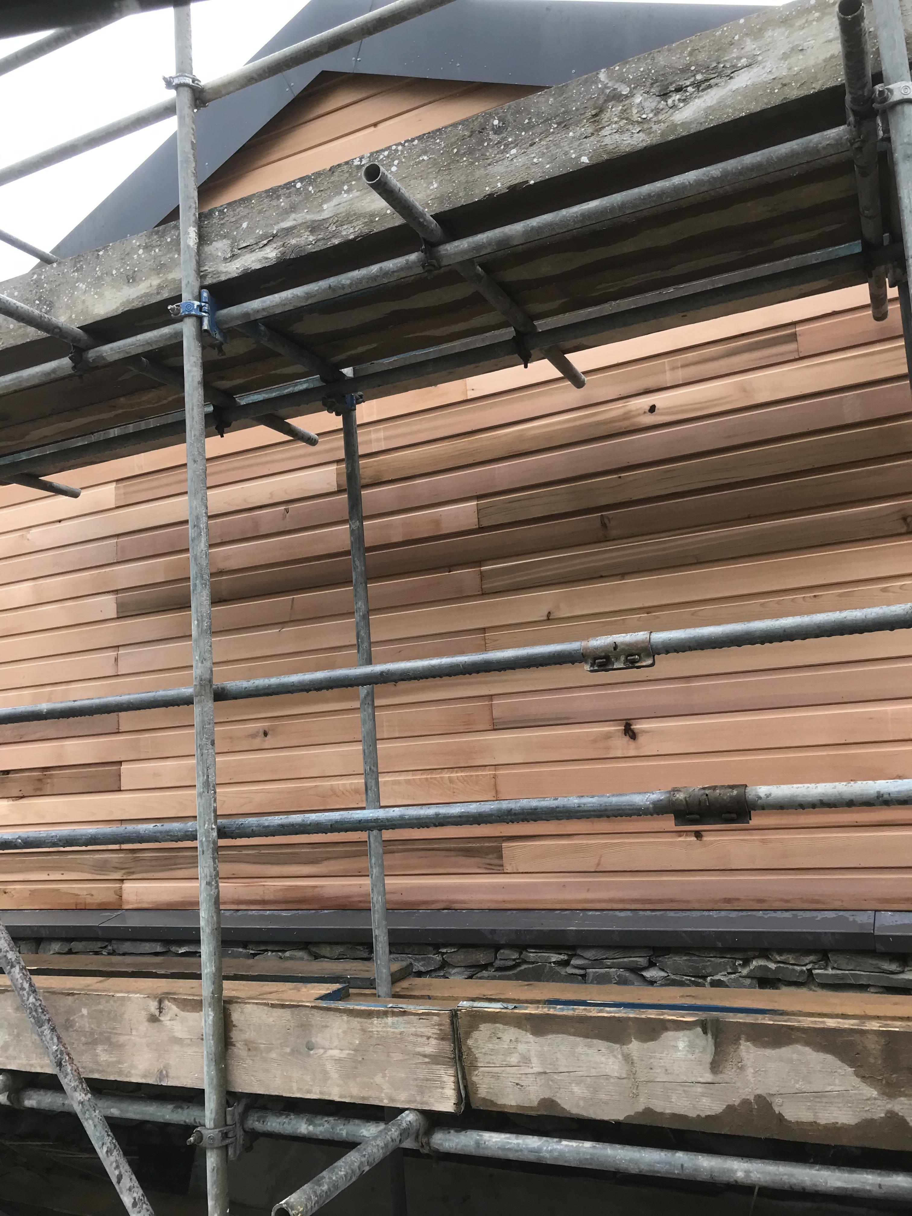

I used cedar over lockdown Looked great But I suspect the price has doubled since
