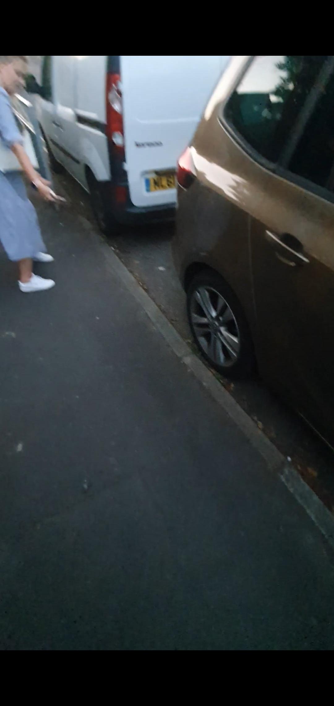

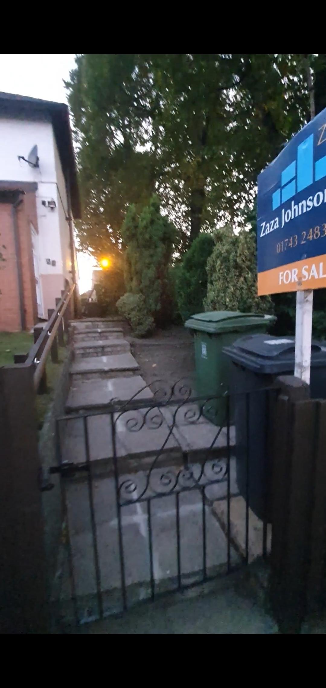

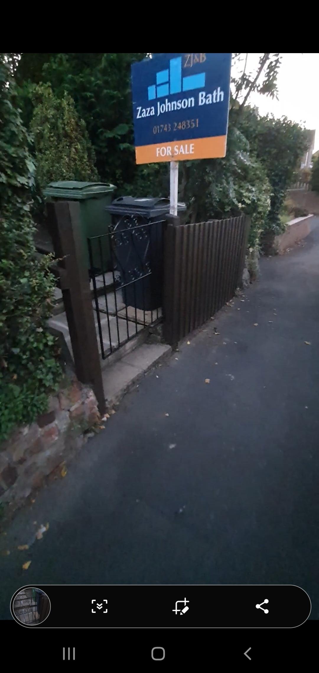

We have recently put an offer in on a house and keen to convert a section of the front garden and side of the house into a driveway. The approach up to the side of the house will be pretty steep.
I have uploaded a little video to give an idea. Excuse the quality of the video, it was recorded to show some family the property and I had to crop and speed it up because of limited file size on here.
The kerb is already dropped for the section we want to create the entrance, though the video does not show this very well. Not sure why it's already dropped. Would this section be too steep for an approach/drive way up to the flat ground at the side of the house? And will we need planning permission if the kerb is already dropped and we use a permeable surface?

It may not be a dropped kerb for your drive.
It could, for example, be to allow lorries to swing wide for a corner by putting a wheel up the kerb.
On the drive, you are probably best to check the regs with your local highways section of the LA as to max gradients etc, or website, or to ask an approved contractor (which you will need to do the pavement crossing anyway). There should be a list of such on the relevant Council website.
The Council will be Shropshire, I would think.
If space is short, consider doing the drive like this or similar:
