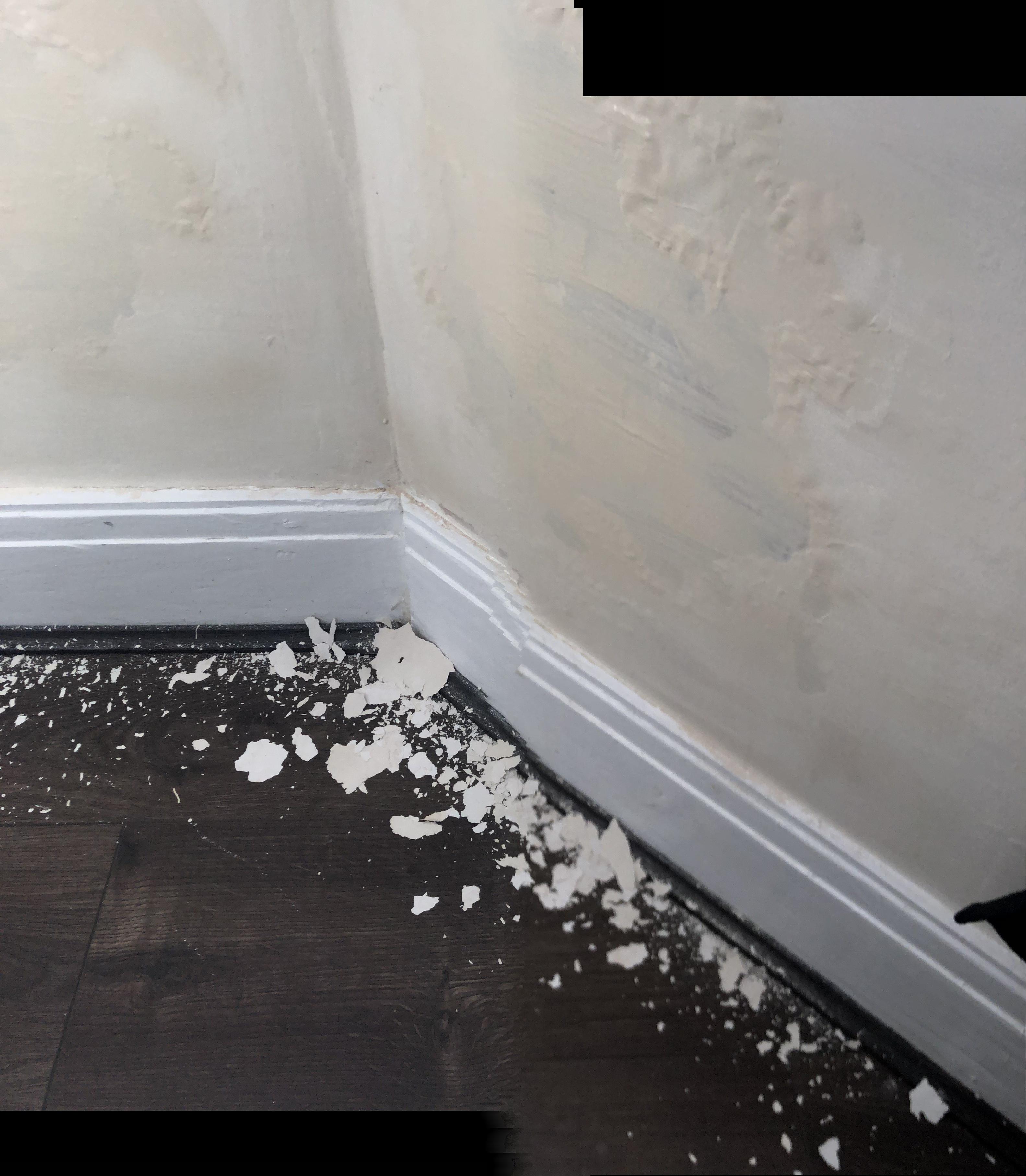

Bubbly paint
Pocster
Tenant wiped this as due to mould ( assume caused by condensation as no leak found ) ; taking paint off the wall .External wall below windows.
I knocked off any loose paint and then weak pva painted over it .
Trying to paint it now and the old paint just peels or bubbles .
What should I use to presumably seal the wall and allow me to paint it ?

If the old paint isn't sticking well to the wall you will probably end up taking a lot of it off no matter what you try to seal it with.
Think I would try a primer like Zinsser Gardz rather than PVA.
Anyone got a better idea?

Thanks will order some Zinsser Gardz

Nothing to do with paint or method. More to do with mould. It is like trying paint can of can of Coke taken from the fidge-impposible
