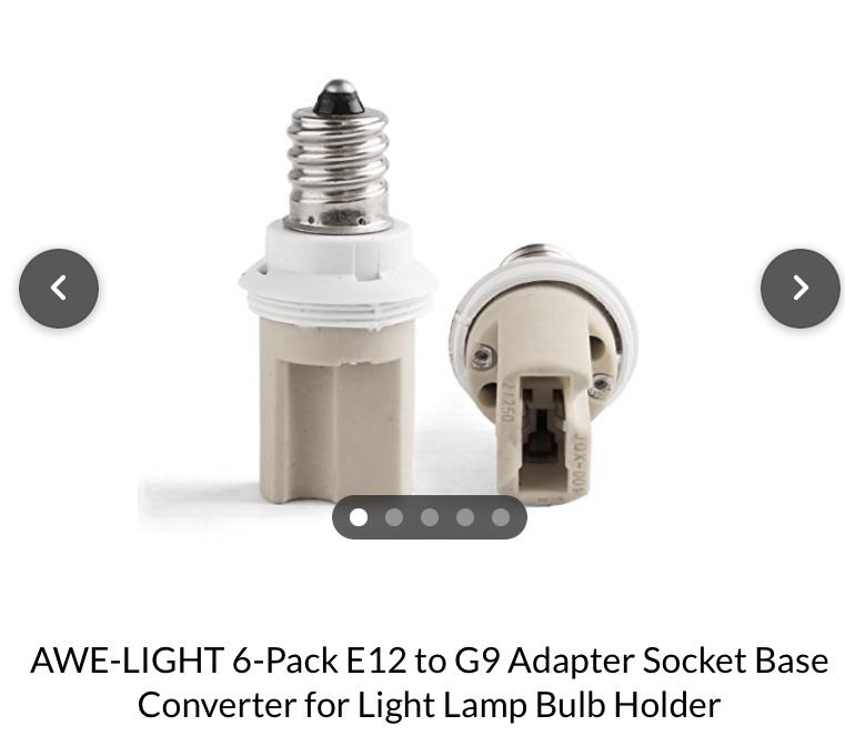

So you can buy the G9 globes on eBay for £5-15 depending on size, and e12 to G9 adapters are readily available so you could do this with some bits. G9 halogen are also available for a while too - the LED versions aren’t the best.

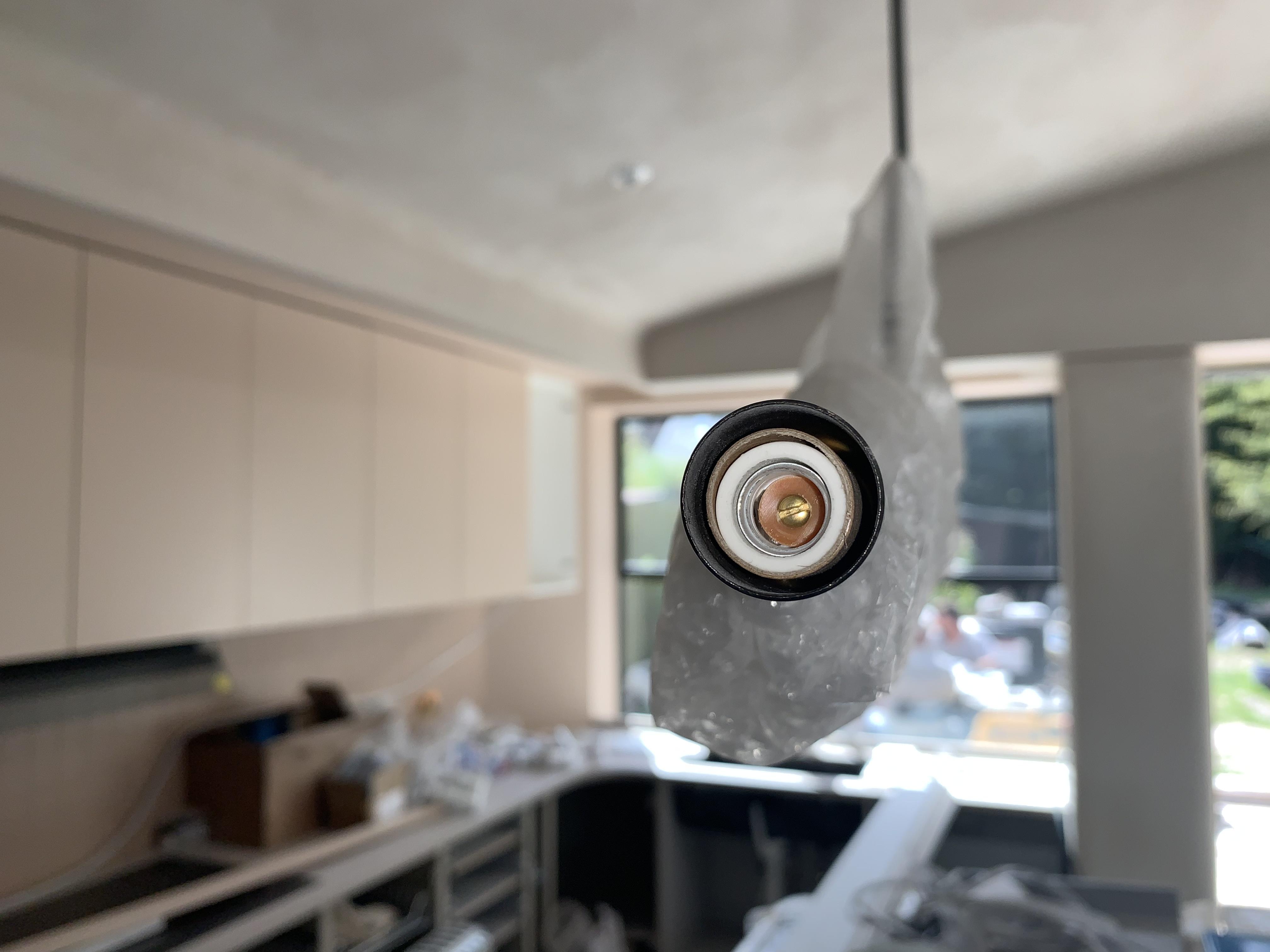

This won’t raspy solve the problem unfortunately. The light fitting (see picture above) has exposed bulbs. ie one is meant to choose decorative bulbs which form part of the aesthetics of light fitting.
what I think you are suggesting, looks like this:
but if I were to insert that into the end of the light fitting, which looks like this:
the biege plastic G9 socket/holder would stick out and be very visible alongside the black light fitting.

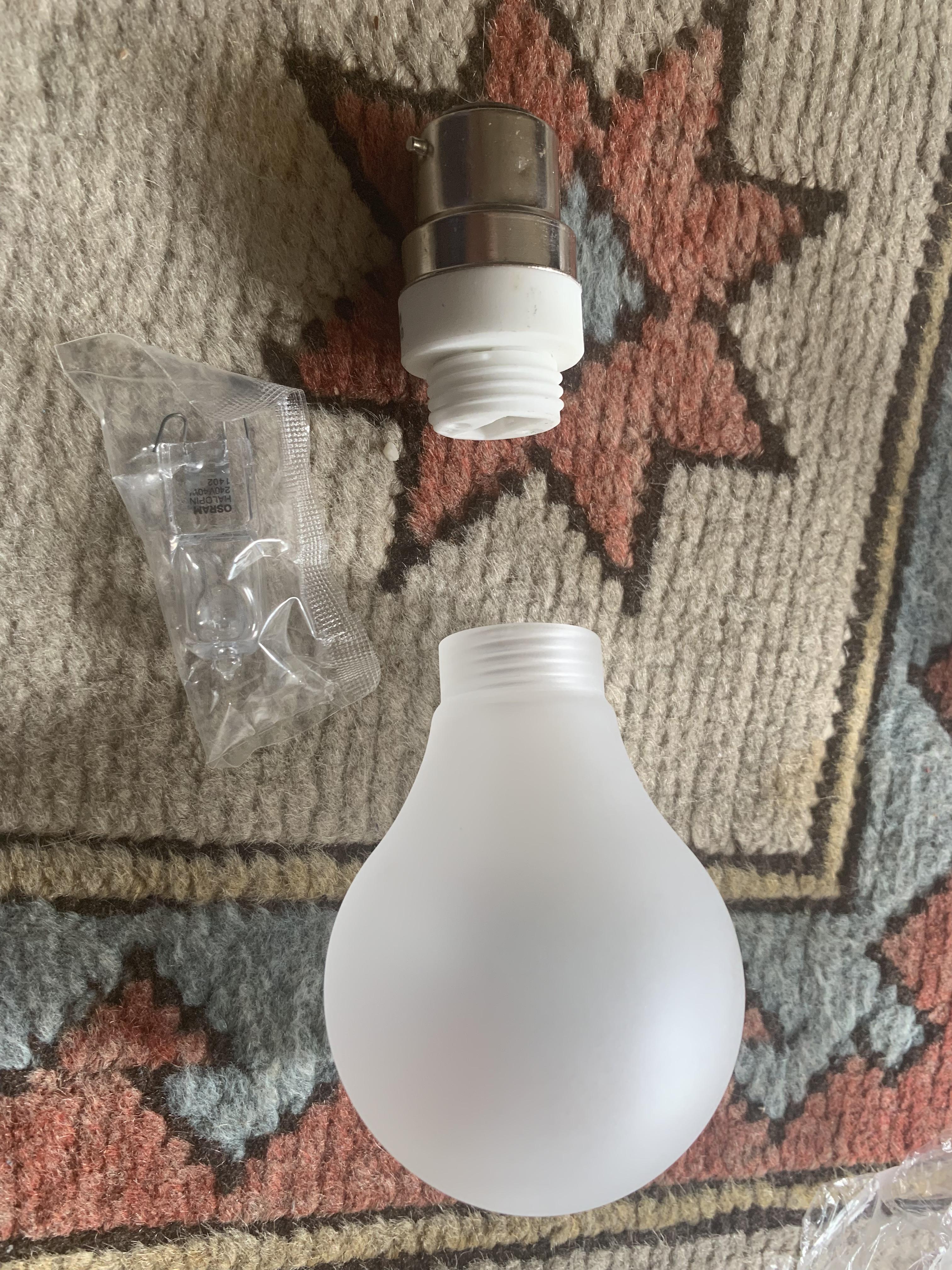

I did look at Bell adaptors (see post below) since at least most of the plastic base would be covered by the frosted glass bulb cover, and the portion that isn’t could be spray painted, but I struggled to find an e12 one.

thanks, but whilst I can find plenty of g9 to e12 converters, the inverse is harder to come by, particularly in a threaded version. Maybe my googling skillls are lacking.
