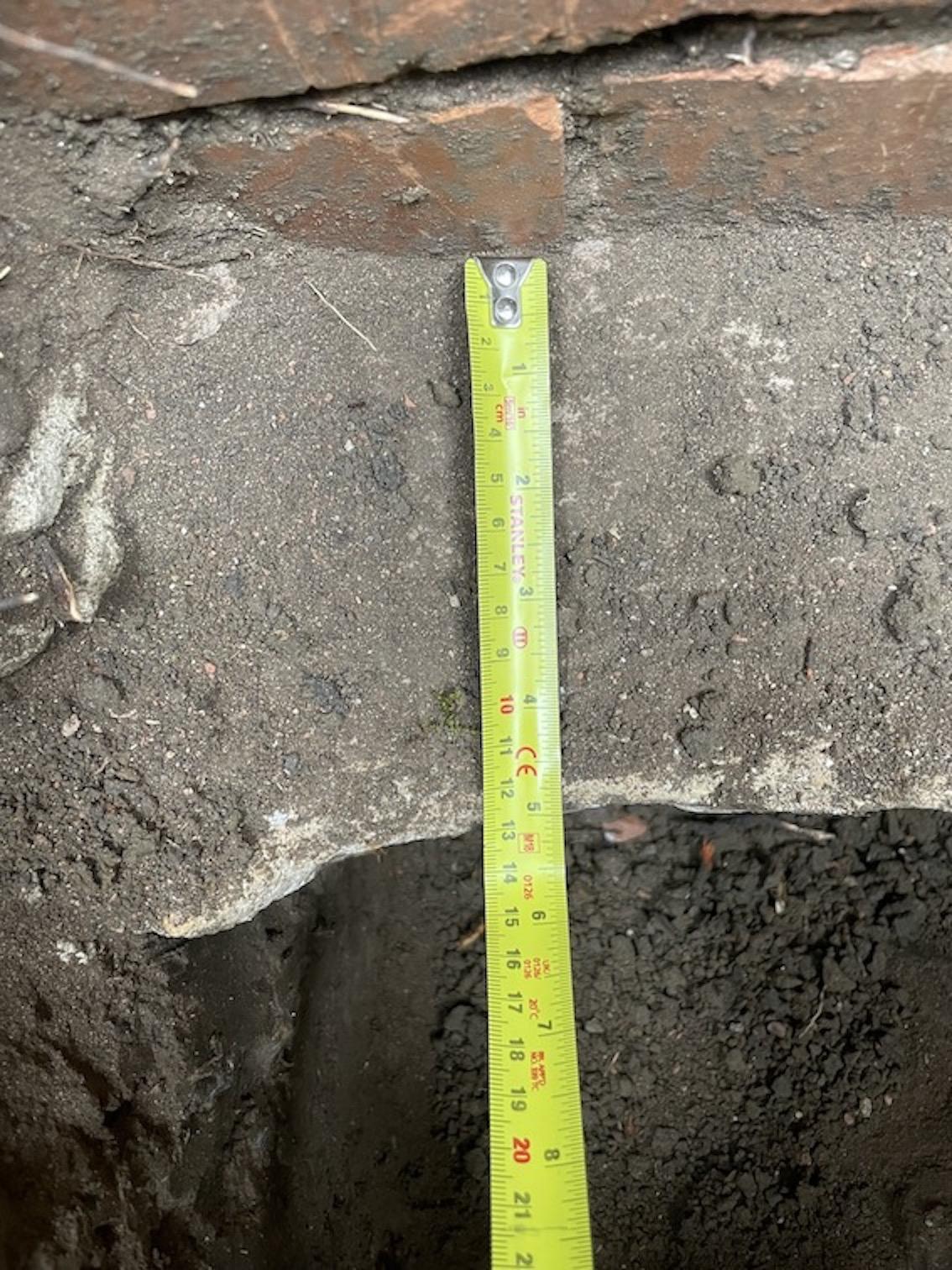

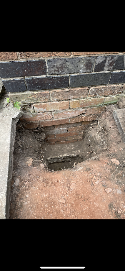

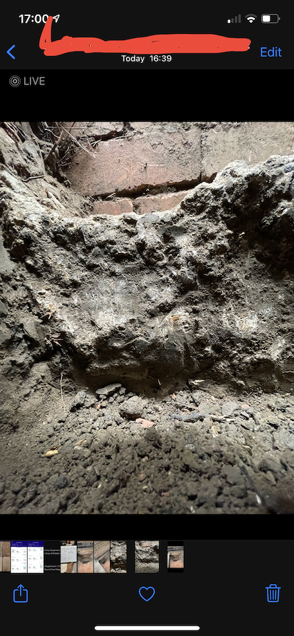

richo106 Posted September 1, 2021 Posted September 1, 2021 Hi I have now exposed the foundations for our bungalow we are hoping to add another storey to. There are 9 brick layers below the engineering brick line then 8inch of the concrete foundations below that. This protrudes 5inch from the brick line. (see attached photos) I have spoken briefly with my builder and he is under the impression that even though the foundation is not as deep as desirable the fact that's its around 450mm in width he thinks we will be able to get away with the existing foundations for adding another storey I will be trying to contact my structural engineer tomorrow to confirm this but I just wondered if anybody on here has any experience with these kind of footings and if my builder was right? All advice and information greatly appreciated
nod Posted September 2, 2021 Posted September 2, 2021 200 mil is very shallow I would think your SE will tell you to beef up The foundations Ex specially where there are trees or hedges As I’m guessing you are on compacted clay
tonyshouse Posted September 2, 2021 Posted September 2, 2021 Should be OK, they have been there a good long time which proves that they are ok. Need SE to do calcs and a soil survey for them to work with.
nod Posted September 2, 2021 Posted September 2, 2021 2 hours ago, tonyshouse said: Should be OK, they have been there a good long time which proves that they are ok. Need SE to do calcs and a soil survey for them to work with. A long time with a single story on them ?
