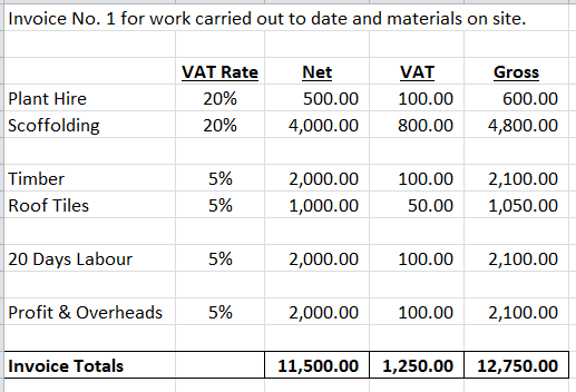

Old Bat Posted October 31, 2021 Share Posted October 31, 2021 I am in a similar situation having just started the conversion of an agricultural barn for myself and family to live in. Our builder is very transparent about his costs and has listed out various items on his first invoice to us in a similar format to that below. Will this be acceptable to HMRC for reclaiming the VAT charged at 5%? I know VAT on plant hire and scaffolding can't be reclaimed but will everything else be OK? I would love to hear from anyone who has reclaimed the VAT on a barn conversion. What did your main contractor's invoices look like? Any tips would be greatly appreciated. Link to comment Share on other sites More sharing options...
Temp Posted October 31, 2021 Share Posted October 31, 2021 I believe his invoices should state his company details, VAT number and your name and the property address. Wouldn't hurt to have any planning reference numbers on there as well. Link to comment Share on other sites More sharing options...
Old Bat Posted November 14, 2021 Share Posted November 14, 2021 What I really wanted to know was how much detail HMRC will expect on the invoice. What should a typical builder's invoice show in terms of detail? Any examples from conversion jobs (redacted, of course) would be helpful. Link to comment Share on other sites More sharing options...
