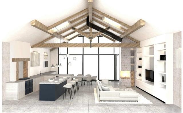

Hi,
I’m not sure if there is an obvious answer to this question but I attach a CGI showing the layout of our kitchen/living area where we are planning on having a wood burning inset corner fireplace(to the right) where the flue cannot go straight up out of the roof so the plan is to either have the flue run along side the internal vaulted ceilings and then out the top on the opposite sloped roof side.
Is there a regulation limit to the length of flue internally? Can it have bends? And finally could this flue be buried between the rafters/insulation board? There is 100mm gap between rafters and then another layer of 100mm insulation of top of the rafters so plenty of room but I’m not sure of regulation it safety. I’ve outlined the potential route in black if it’s exposed. It would be approx 3m.

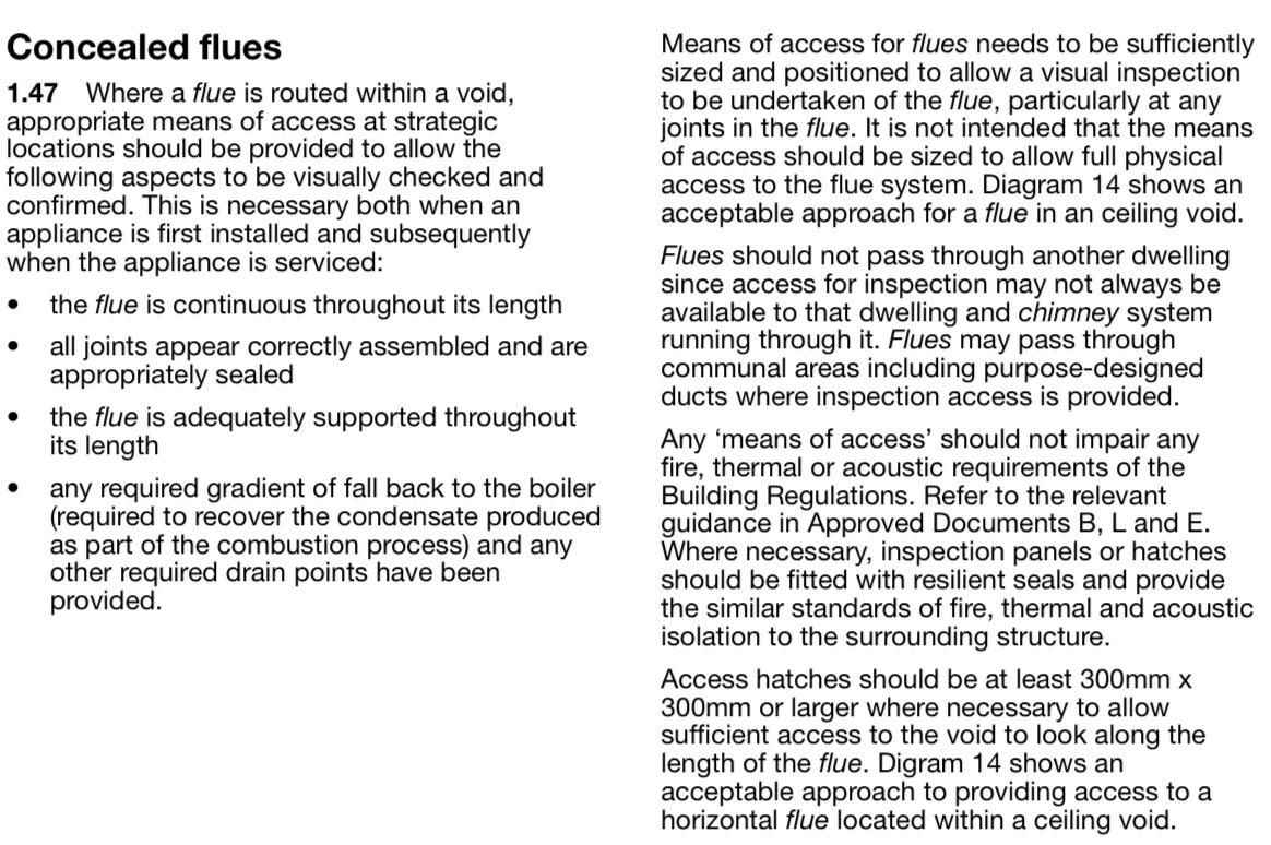

Assuming an insulated flue pipe can be used I could still maybe conceal that flue pipework in between the rafters as long as it’s boxed in with an air gap inside the box?
I attach what I think may or may not be relevant:
