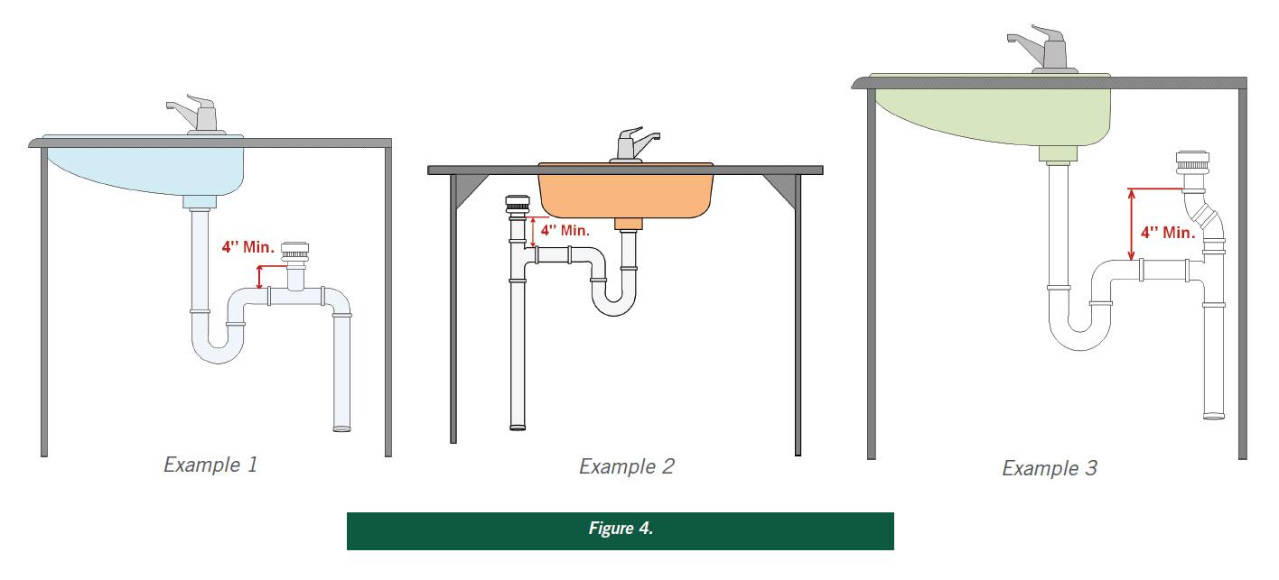

Adsibob Posted August 4, 2021 Author Posted August 4, 2021 Thanks @Temp maybe I will fit an AAV. Does that create any air tightness issues for the MVHR system? I also wonder whether another solution might be to use a standard trap but locate it a bit further away from the sink's exit point so that I have more space for it. For example if directly under the exit point I have a right angled bend, that would take the waste water to the adjacent cupboard which is a cupboard rather than a set of drawers. Plenty more space there to locate a standard bottle trap. Or is that a no no because the trap must always go directly under the sink's exit point (as shown in the attached picture, which also features an AAV)?
Temp Posted August 4, 2021 Posted August 4, 2021 I'm not aware of any issues with AAV and MVHR. 3 minutes ago, Adsibob said: For example if directly under the exit point I have a right angled bend, that would take the waste water to the adjacent cupboard which is a cupboard rather than a set of drawers. Plenty more space there to locate a standard bottle trap. I think that's fine.
