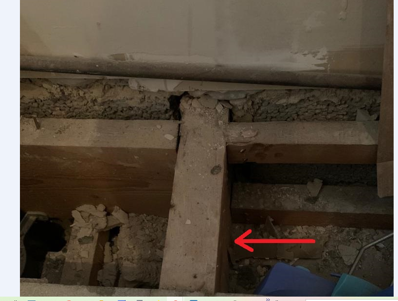

Putting a hole through a joist
I want to put a hole through the joist in the narrowed position in order to run a 50mm shower waste through to the stack
its a 63X200 joist and from what i can measure under the floor broads is at least a 3m span.
Its close to the end of the joist which is my concern.
Was wondering if it might be doable if i reinforce the joist either side with thick ply, glued and screwed in place before drilling through the joist and ply
Not a problem drilling 50-60mm hole in a 200mm joist as long as it is mid depth. A bit of reinforcement won’t do any harm.
