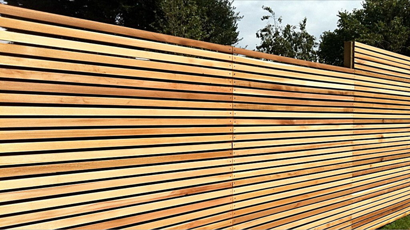

Calvinmiddle Posted March 16, 2017 Posted March 16, 2017 (edited) You we want to build a screen like the photo to cover the back (the side with the battens) of some panel fencing and concrete posts. We have some larch left over from the build and plan to cut it down from 145 and 95 to approx 45mm. But I'm trying to decide how to attach it to the existing fence. The panels are approx 30mm back from the front of the concrete posts and my initial thought was to fix 50mm square battens at 600 centres and nail the larch onto them. The panels sit on concrete gravel boards and are well clear of the soil by at least 150mm. But doing this means the panels are holding all the weight, and although they aren't the big shed rubbish panel than is still a lot of extra weight. Altrnative is to screw a batten onto the concrete posts and let them take the weight with a couple of thicker battens on the fence to make sure they don't sag. There will be some 'making good' needed on the fence to get the batten perfectly straight and vertical as fence was replacing a holly hedge and the roots gave us some problems, though that maybe avoiding the concrete posts might make that stage easier Any thoughts? Edited July 29, 2017 by Calvinmiddle Typo

Calvinmiddle Posted March 17, 2017 Author Posted March 17, 2017 Unfortunately new posts aren't an option, not enough room and to be honest, the house has taken 2 years to build and 4 years before that to get planning. I don't have the energy to start digging holes and getting posts. Needs to be either on the fence panels (least work) or if that won't be strong, on the existing posts (as you say a pig of a job drilling into the posts)
Ferdinand Posted March 17, 2017 Posted March 17, 2017 36 minutes ago, Calvinmiddle said: Unfortunately new posts aren't an option, not enough room and to be honest, the house has taken 2 years to build and 4 years before that to get planning. I don't have the energy to start digging holes and getting posts. Needs to be either on the fence panels (least work) or if that won't be strong, on the existing posts (as you say a pig of a job drilling into the posts) If you have to go on the existing posts then you are into long screws through the arris rails to mount vertical "ties" to put your planks on, or screw the planks directly to the verticals. I suppose you could also strap wooden posts to the existing posts. I think that in any of these cases, you will be redoing it before too long. The other option is to buy premade horizontal-plank panels and save your wood for something else.
Calvinmiddle Posted March 17, 2017 Author Posted March 17, 2017 3 minutes ago, Ferdinand said: I think that in any of these cases, you will be redoing it before too long. I was thinking of drilling 3/4 holes into the front of the post putting a wall plug in and then screwing on a 25-50 batten and nailing the slats onto them. Don't have arris rails to go through as they are standard 'H' profile posts that panels slide into. Wouldn't that work? Why do you think I'd have to redo it before long? Rot? Not holding?

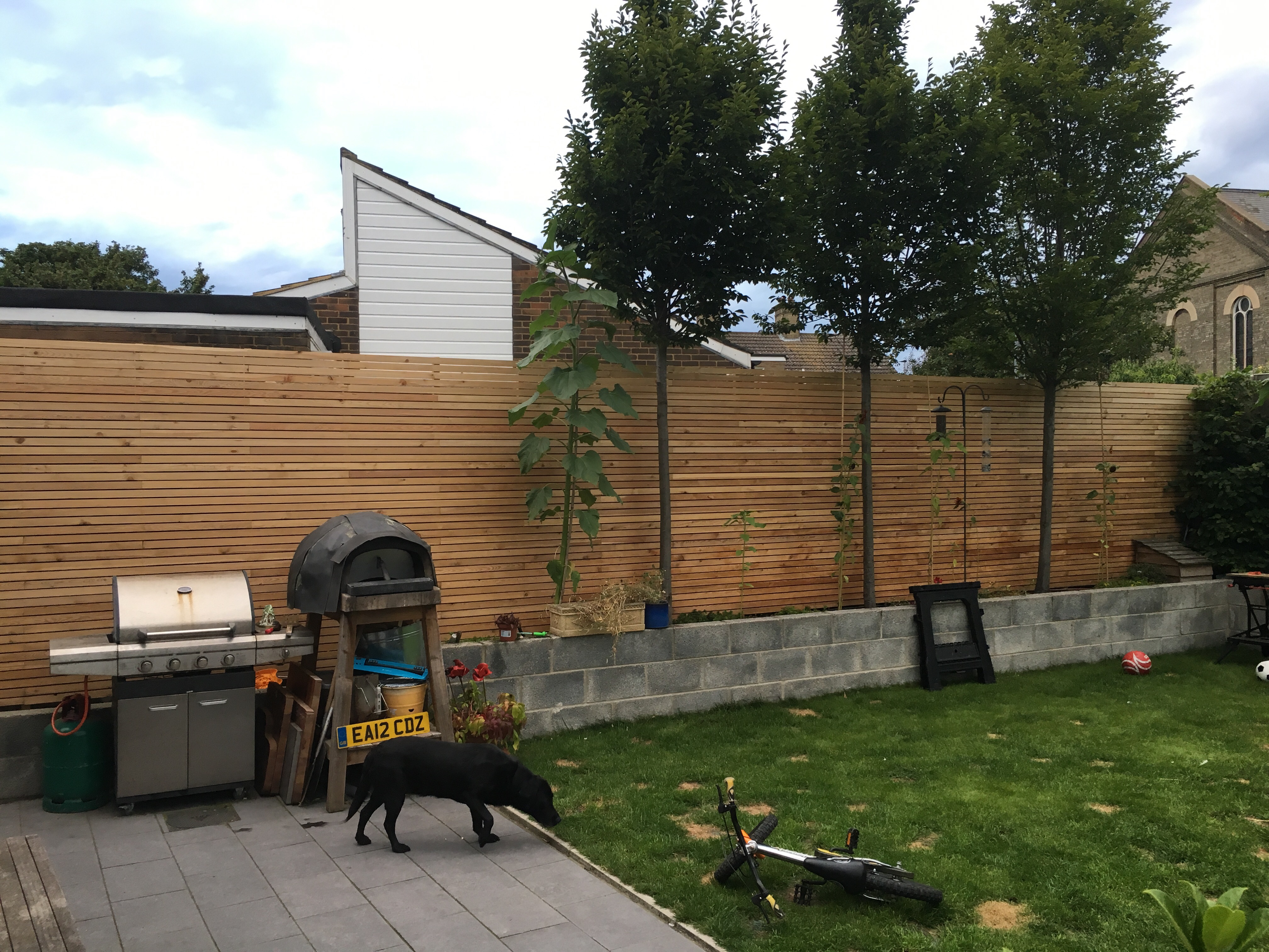

Calvinmiddle Posted July 29, 2017 Author Posted July 29, 2017 As mentioned earlier I decided to use 50x50 posts concreted into the ground to take the vertical load and then screwed into the existing fence panels to help keep it upright, got a the bottom third of one fence done with the old sanded back Larch and the new Larch arrived next week so dining the posts on the other fence. These posts have been a pig to do as trying to keep the holes small in diameter (10-15cm) and 30-45cm deep and also tight to the exist fences concrete gravel boards. As we discussed over on this thread about used a vacuum cleaner to clean the holes out I can say it works a treat! We have very compact clay soil, nice a fine once to get it broken but hard to do that with a trowel like I've hard to do, but a couple of bangs with the chisel end of the crowbar to break the soil and then the vacuum to clean it out has seen me just do 4 holes in the time it was previously taking me to do one. So can confidently say that using a vacuum cleaner to clean out holes is a great plan and works fantastically
Calvinmiddle Posted August 14, 2017 Author Posted August 14, 2017 Just to round things out, here is a picture of the finished fence, well one side, got another 12m of fence to go 3
