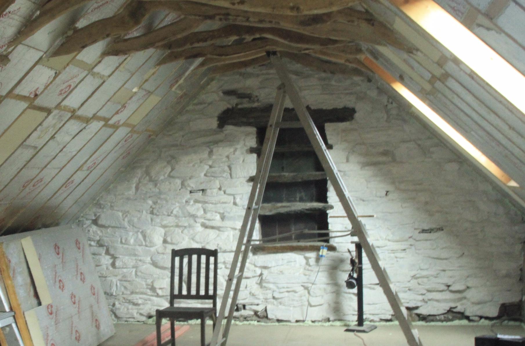

On 13/07/2021 at 14:06, Oxbow16 said:
I'm hoping to clean the stonework up afterwards and re-point (with lime) if needed.  Prefer the natural look, and love the history of the place.  Prefer a cold bedroom too before anyone mentions insulation ;)
I am at this point right now, I have a cottage that I am going to convert for my parents, it’s always had exposed stone walls but I am looking at insulating them all……. I will have the conversation with them but I just don’t like the idea of huge cold bridges sucking out the heat….. I repointed them so carefully years ago and it’s going to be a shame to loose the “look” but great to see my electric bill go down !
i like to really show the stone of when pointing and brush back the mortar, I prefer to paint it afterwards as I don’t like the natural look !
