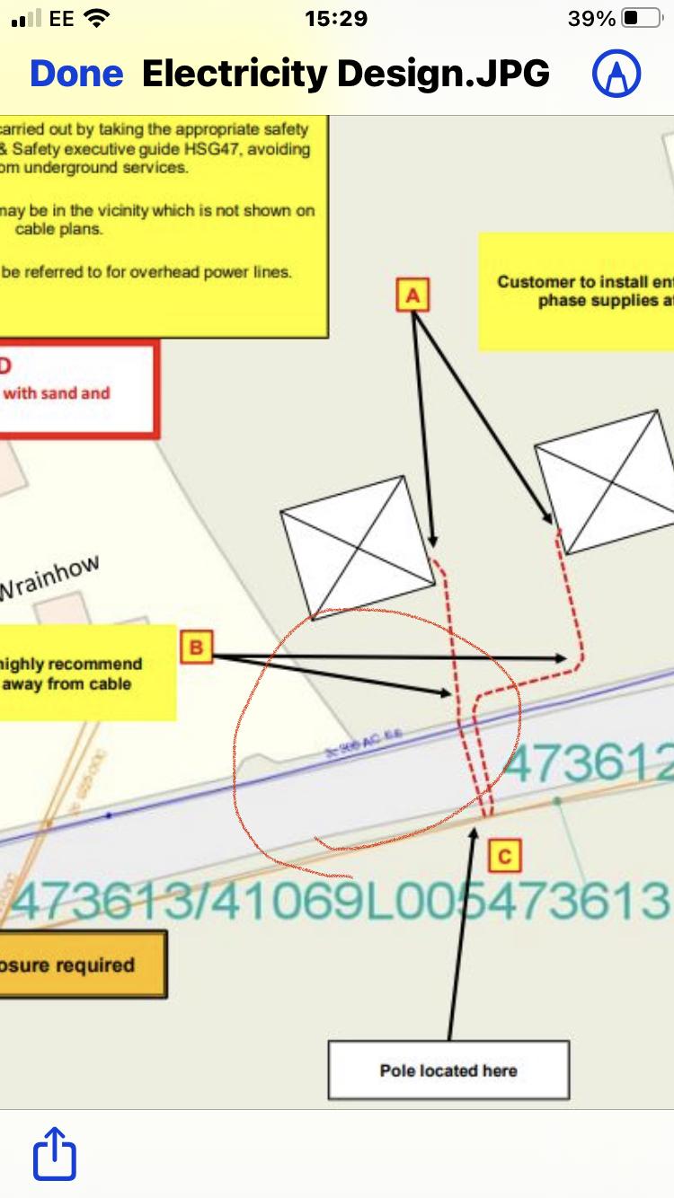

nod Posted July 9, 2021 Share Posted July 9, 2021 Could someone identify the cable circled pls Link to comment Share on other sites More sharing options...
ProDave Posted July 9, 2021 Share Posted July 9, 2021 What the blue one? What does the text say? It's a bit blurred when i enlarge it. What features does the blue one connect to (out of this shot) if any? Link to comment Share on other sites More sharing options...

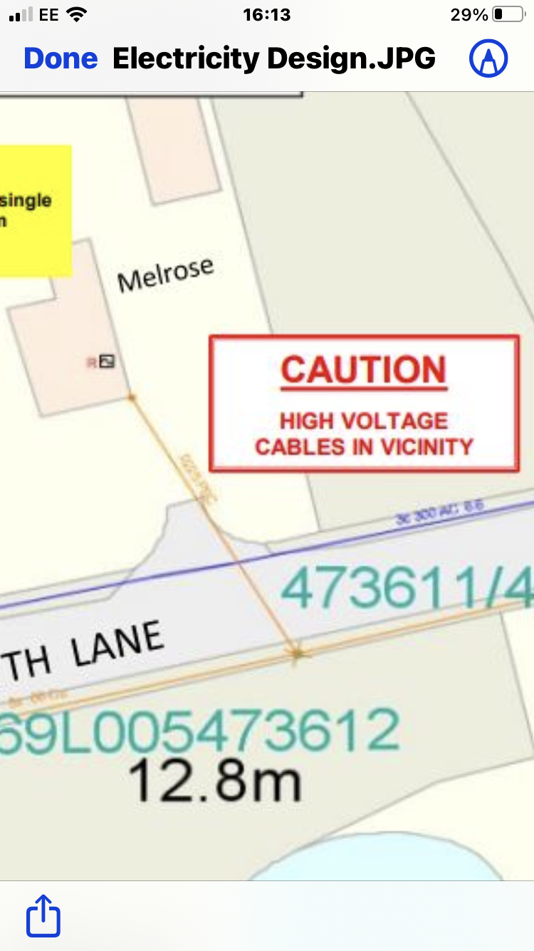

nod Posted July 9, 2021 Author Share Posted July 9, 2021 (edited) The one far right looks like 3c 300ac 8.6 The one on the left looks like 300 ac It doesn’t seem to run to either property Just runs along the lane As you can see our new supply like both properties will come from the overhead across the road Edited July 9, 2021 by nod Link to comment Share on other sites More sharing options...

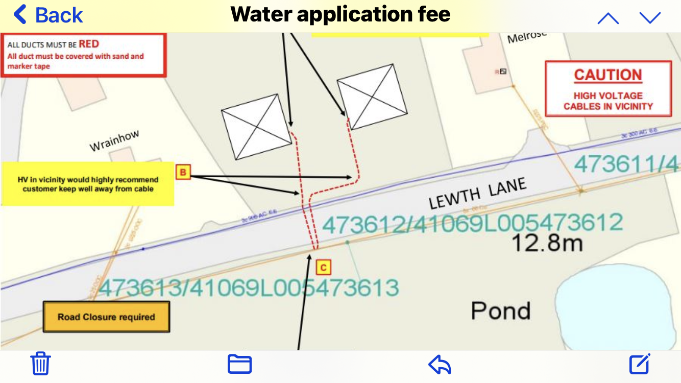

nod Posted July 9, 2021 Author Share Posted July 9, 2021 Link to comment Share on other sites More sharing options...
ProDave Posted July 9, 2021 Share Posted July 9, 2021 Now we see the big picture "HV cables in vicinity" The blue cable will be 11Kv or 33KV. That's why you can't connect direct to it. It will feed a transformer in the vicinity that feeds the LV overhead cable you are connecting to. Be VERY careful digging anywhere near the edge of the plot. Try and be present when the mains supply is laid in as they will almost certainly locate the blue HV cable (it will in fact be black of course) and it would be a good time to put some stakes in to locate it precisely so you know to avoid it. Link to comment Share on other sites More sharing options...
nod Posted July 9, 2021 Author Share Posted July 9, 2021 (edited) That’s good advise Thanks Dave Its looking like the water main follows the same line Edited July 9, 2021 by nod Link to comment Share on other sites More sharing options...
