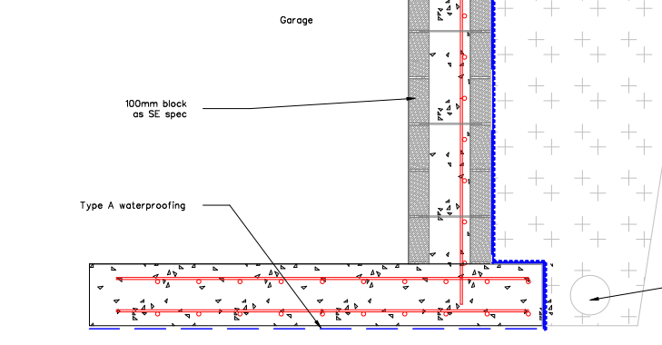

Moonshine Posted June 21, 2021 Posted June 21, 2021 Does anyone know of any guidance on how high each pour of a core filled (200 mm) masonry wall should be? 2 blocks, 3, 4, more? The walls will be tied, but they won't be supported from the outside.
markc Posted June 21, 2021 Posted June 21, 2021 Difficult one as there are a lot of variables, number and type of ties, mortar mix etc. but i would be working on around 1m per pour with unsupported walls
Mr Punter Posted June 21, 2021 Posted June 21, 2021 You will need to compact the concrete with a poker which is where it can go wrong. 900mm would be the max I would go to but if 450mm is practical then even better. Leave for a few days for the mortar to go off before pouring.
Moonshine Posted June 21, 2021 Author Posted June 21, 2021 6 minutes ago, markc said: Difficult one as there are a lot of variables, number and type of ties, mortar mix etc Just to help, 10.4N blocs, M6 mortar, ties at 600mm cts horizontal, 450mm cts vertical.
markc Posted June 21, 2021 Posted June 21, 2021 That should be a pretty tough wall, as above give the mortar time to go off and bring the level up slowly and evenly - assume you are using a pump so work your way around and bring level up approx 1 foot at a time, this means you can be less harsh with the poking.
