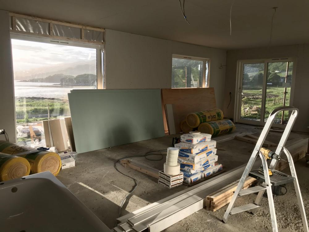

Grian Posted June 20, 2021 Posted June 20, 2021 Very exciting, house is really getting there now! Have discovered things I overlooked and among these - access to the loft. Foolishly didn't give thought to loft hatch size and the one that came with our (Scotframe) kit is too small for regular use. We have little storage and plan to use the uninsulated attic as a big cupboard so will access it perhaps every couple of weeks. Don't want to create a cold spot in the ceiling so am looking for a well insulated hatch with a good seal, preferably with a good quality ladder. Max length 1150. Budget is tight! Any advice appreciated. Thank you.
