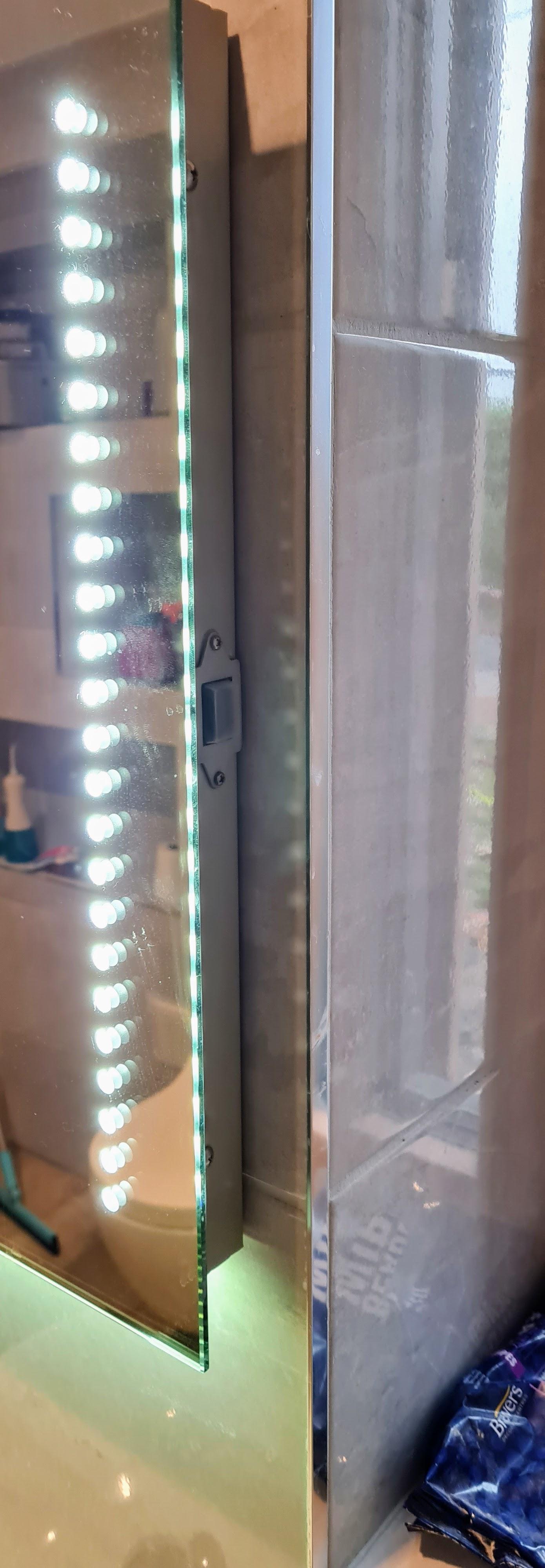

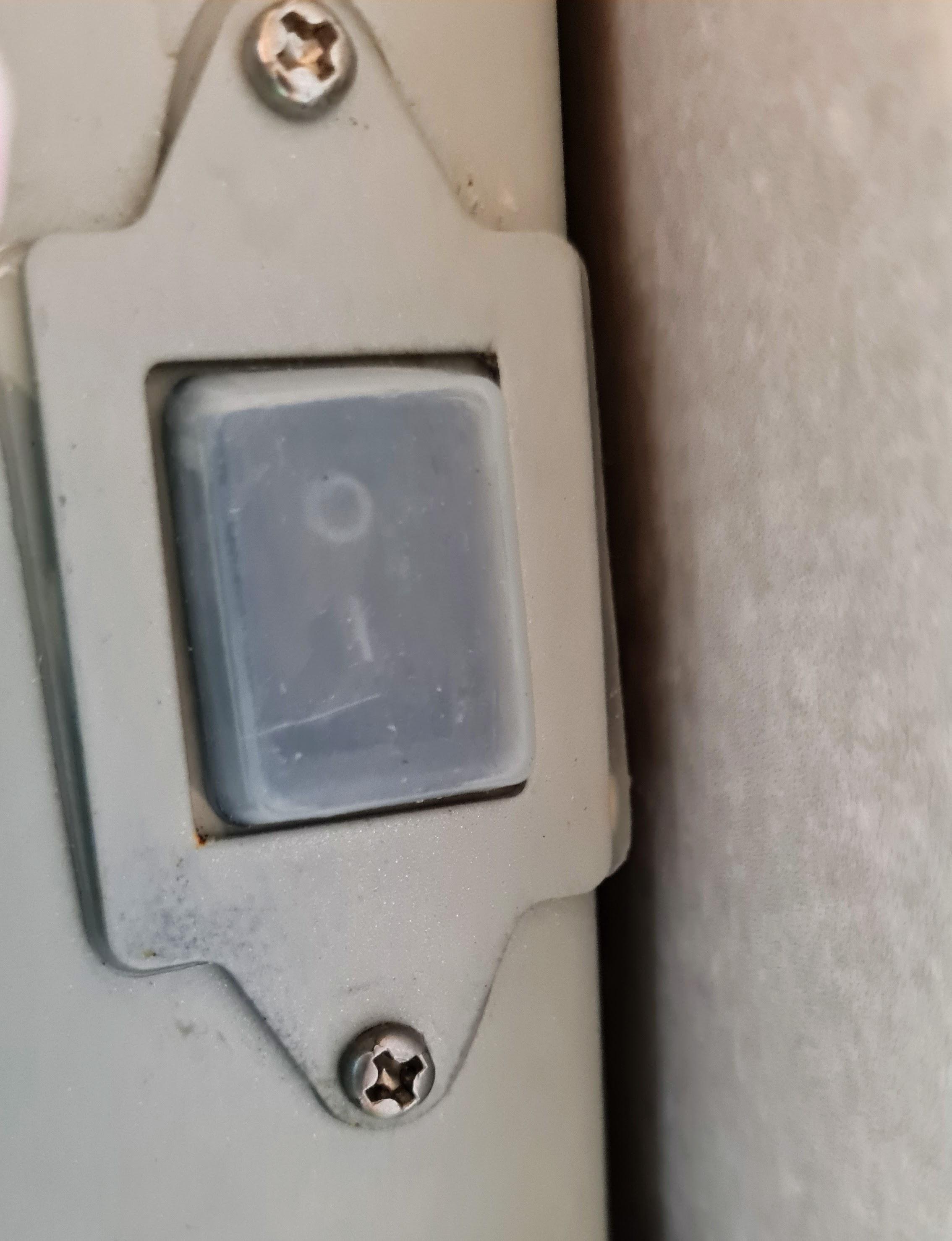

ToughButterCup Posted June 11, 2021 Posted June 11, 2021 (edited) We have a heated bathroom mirror. Its excellent. But there's one little thing I'd like to improve if I can / am allowed to. Heres trhe mirror... Its the switch for the de-mister that concerns me, this little fella; Its hidden from view (tucked in behind the mirror surface on the right hand edge). And so if anyone switches it on by accident - and then doesn't switch it off - it remains 'ON' for extend periods. Because there is little need for the demister function we rarely see mist on the mirror anyway. So the heating element can be on for extended periods, and nobody is the wiser. Short of taking the switch out, is it allowable to fit a replacement illuminated switch (if such a thing exists) ? Edited June 11, 2021 by ToughButterCup
dpmiller Posted June 11, 2021 Posted June 11, 2021 (edited) No reason why not. It looks like the smaller of two standard sizes so something like this: https://www.ebay.co.uk/itm/123755047151?hash=item1cd06028ef:g:n9gAAOSwtxNczJm9 Edited June 11, 2021 by dpmiller
Temp Posted June 11, 2021 Posted June 11, 2021 +1 I'd take the cover off and either measure the switch or estimate the size of the panel cut out. Compare with dimensions on ebay.
ToughButterCup Posted June 11, 2021 Author Posted June 11, 2021 (edited) 1 hour ago, dpmiller said: No reason why not. .... Thats what I wanted to hear, and 1 hour ago, Temp said: ... I'd take the cover off and either measure the switch or estimate the size of the panel cut out. Compare with dimensions on ebay. thanks for the nudge @Temp It's on a switched fused spur of its own , so even I can operate safely. Now all I need is a bad weather forecast for a day. (Indoors Only jobs list) Thanks @dpmiller if only for the name to search for Quote DPST Illuminated Mains Rocker Power Switch 6A 250 VAC with Red Neon I mean who'd'a guessed DPST Illuminated Mains Rocker Power Switch indeed..... After I've fitted it, whassa chances she will take any notice of the red light being ON ? .... ?. Not going to stop me trying, though. Edited June 11, 2021 by ToughButterCup
