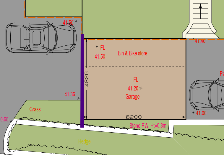

I am proposing an outbuilding that is going to be on the boundary of the plots
Due to it being on the boundary it need fire protection and BC approval, this would usual be done with block.
However i want to build out of timber with insulated walls, speaking to building control i can line the internal with fireboard, and the outside with a product like cedral.
Though interestingly the BCO said that i could have this one boundary wall as block and the rest as timber.
any ideas?

I asked the question and they said no on timber frame, it would need to be a product like cedral on the timber frame.
The reason i want timber frame it to maximise the internal space and have the insulation within cavity. If i use block then i will have to have internal insulation, and lose a bit of space.
