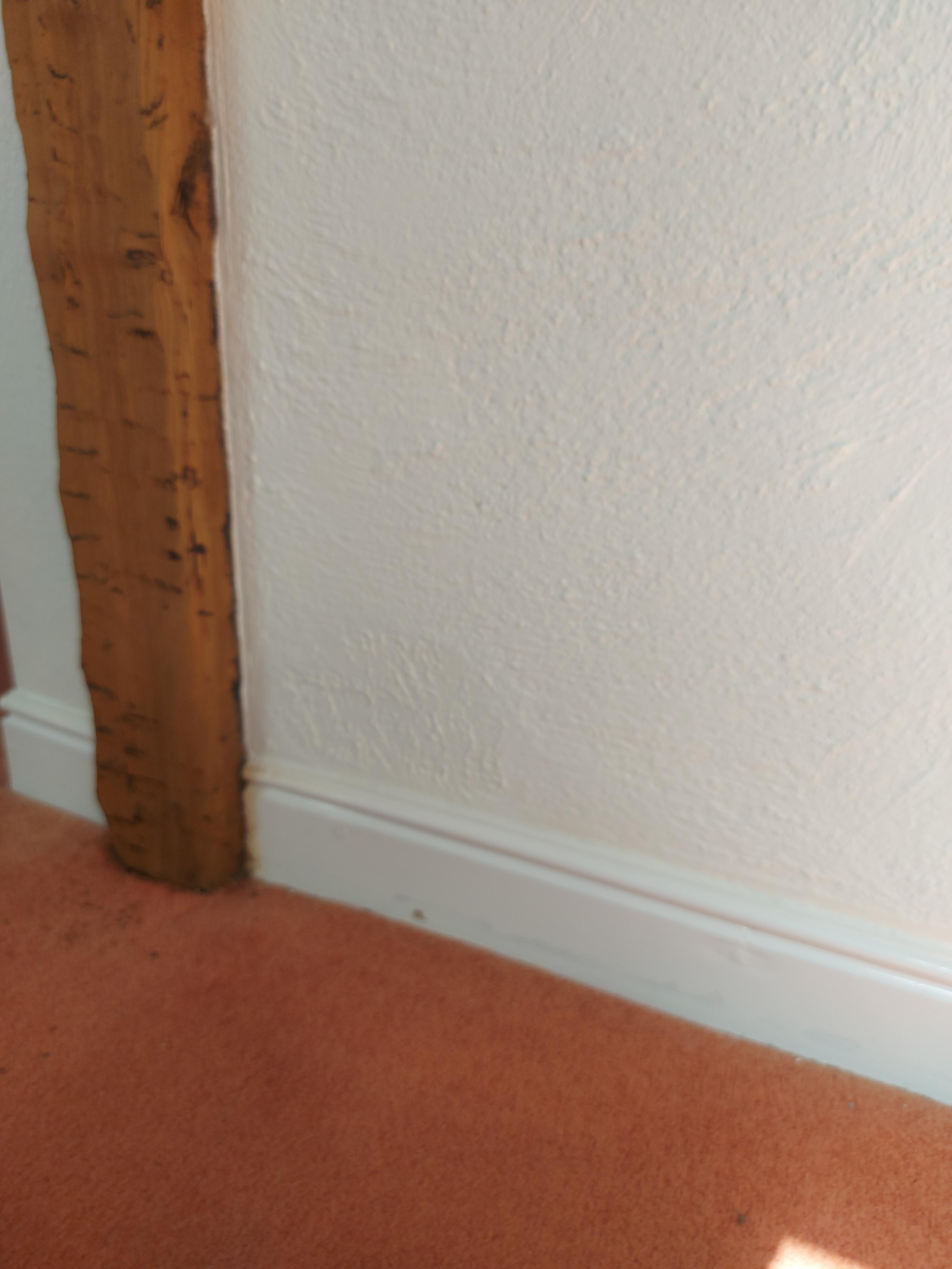

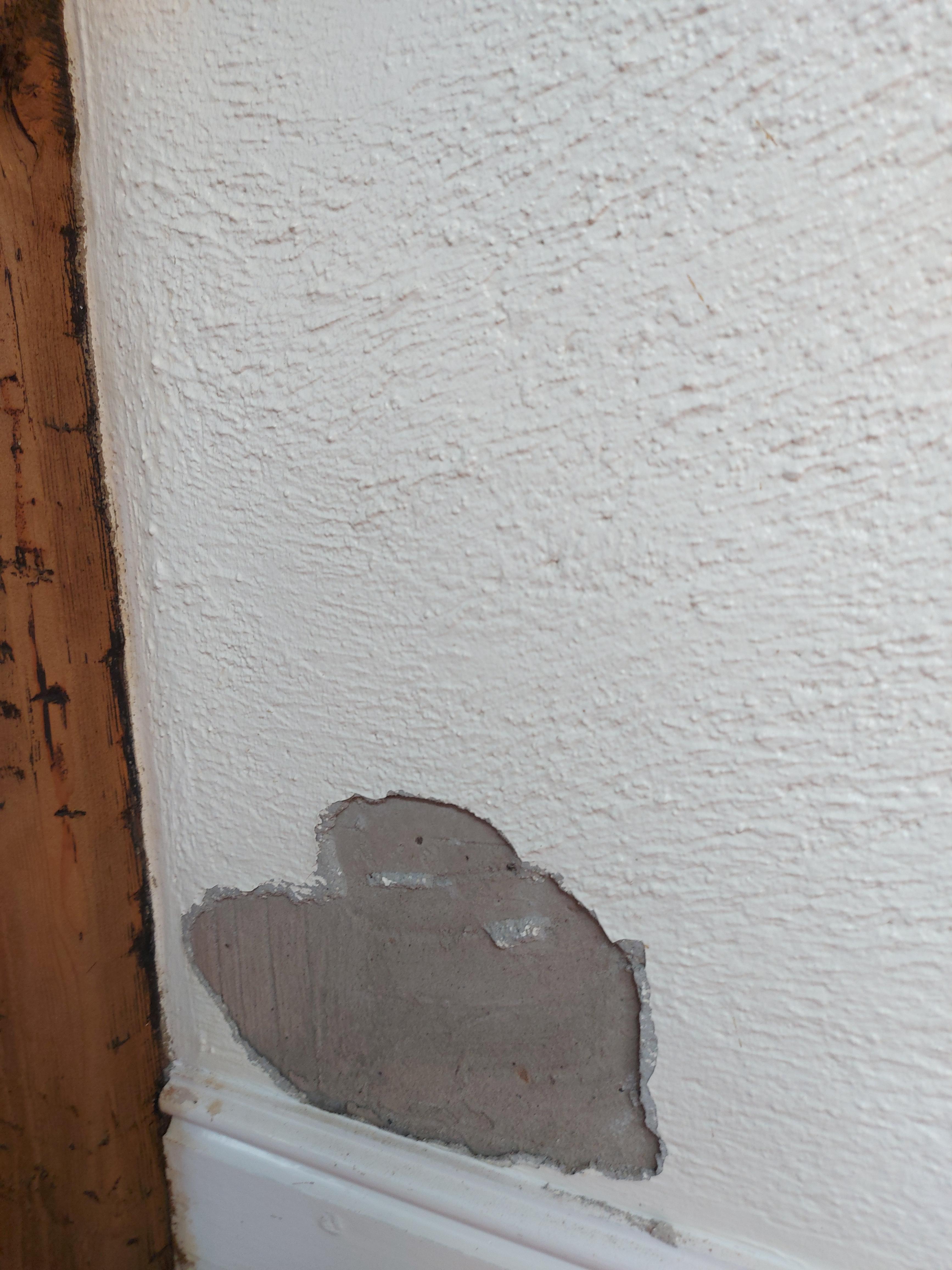

iSelfBuild Posted May 2, 2021 Share Posted May 2, 2021 I have just sandblasted our beams in the new house and manged to blast off some patches of plaster. The finish appears to be lime based with some sort of grit in? It seems to have flecks of vermiculite in it as well? Is that a done thing or am I imagining that being in the mix? I imagine that they let it go off partially and polish off the top layer to expose the grit? Any ideas on how to recreate this? I was thinking thistle bonding coat might be a good option and getting it level then adding a slurry mix on top and using a stipple roller to blend in? Any other ideas? Link to comment Share on other sites More sharing options...
Marvin Posted May 2, 2021 Share Posted May 2, 2021 Looks like a smooth coat of plaster and rough painted white sandtex textured masonry paint on top. That's my guess from the photo. But it could also be some form of artex, or plaster rough finished and painted over. But the best advice I can give is to have a practice on something else until you get the best match. As long as it matches you could use plaster of Paris, lime morta and a garden fork. I have had similar fun fixing holes in artex ceilings... Good luck Marvin Link to comment Share on other sites More sharing options...
iSelfBuild Posted May 10, 2021 Author Share Posted May 10, 2021 Hardwall taken flush then filler stippled on once set. Near enough the same ? 1 Link to comment Share on other sites More sharing options...
SteamyTea Posted May 10, 2021 Share Posted May 10, 2021 On 02/05/2021 at 14:17, Marvin said: But it could also be some form of artex, Let's hope not, could have long term ramifications for whoever shot blasted it. Link to comment Share on other sites More sharing options...
Marvin Posted May 10, 2021 Share Posted May 10, 2021 7 hours ago, iSelfBuild said: Hardwall taken flush then filler stippled on once set. Near enough the same ? Nice job! Link to comment Share on other sites More sharing options...
