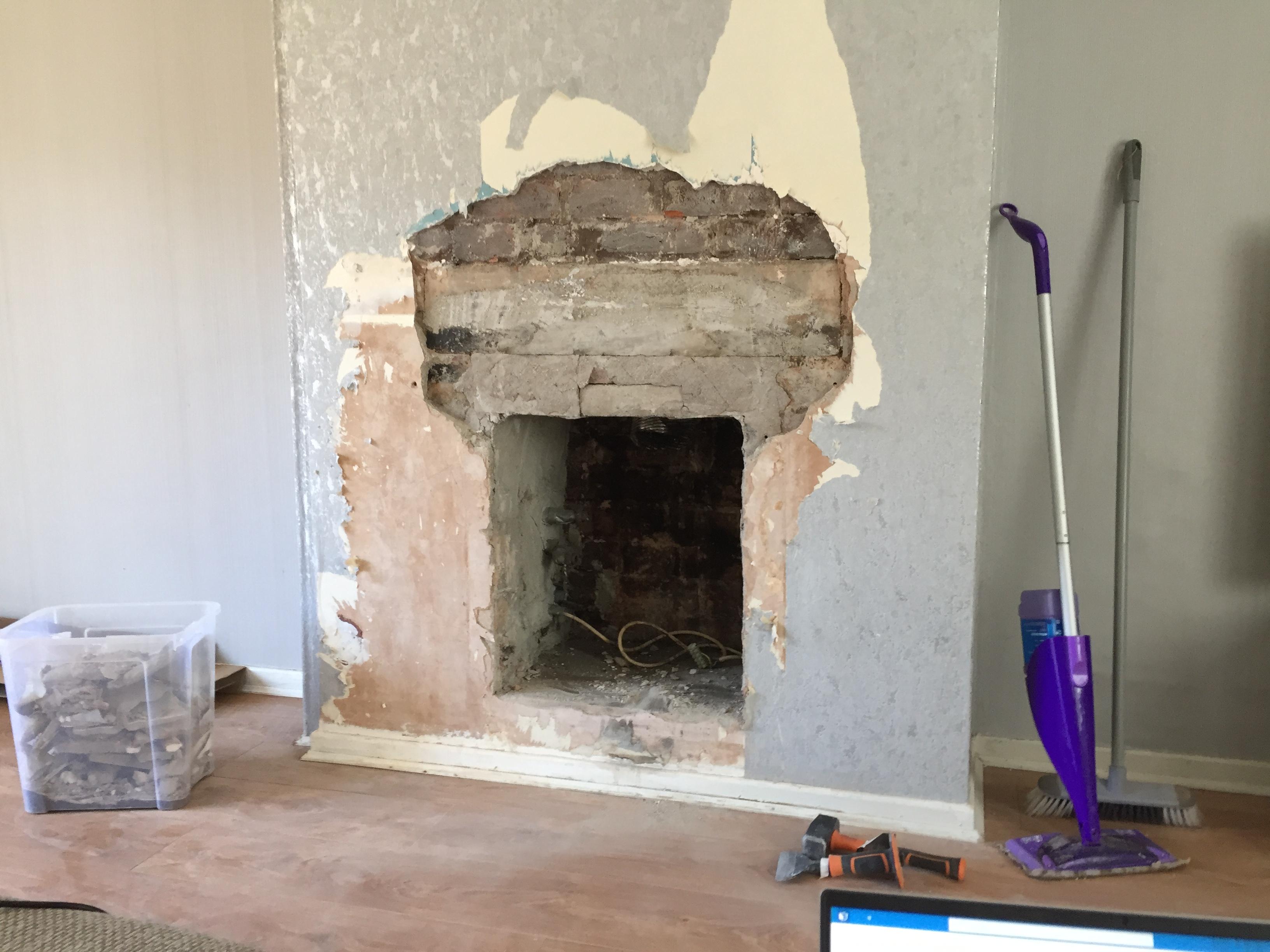

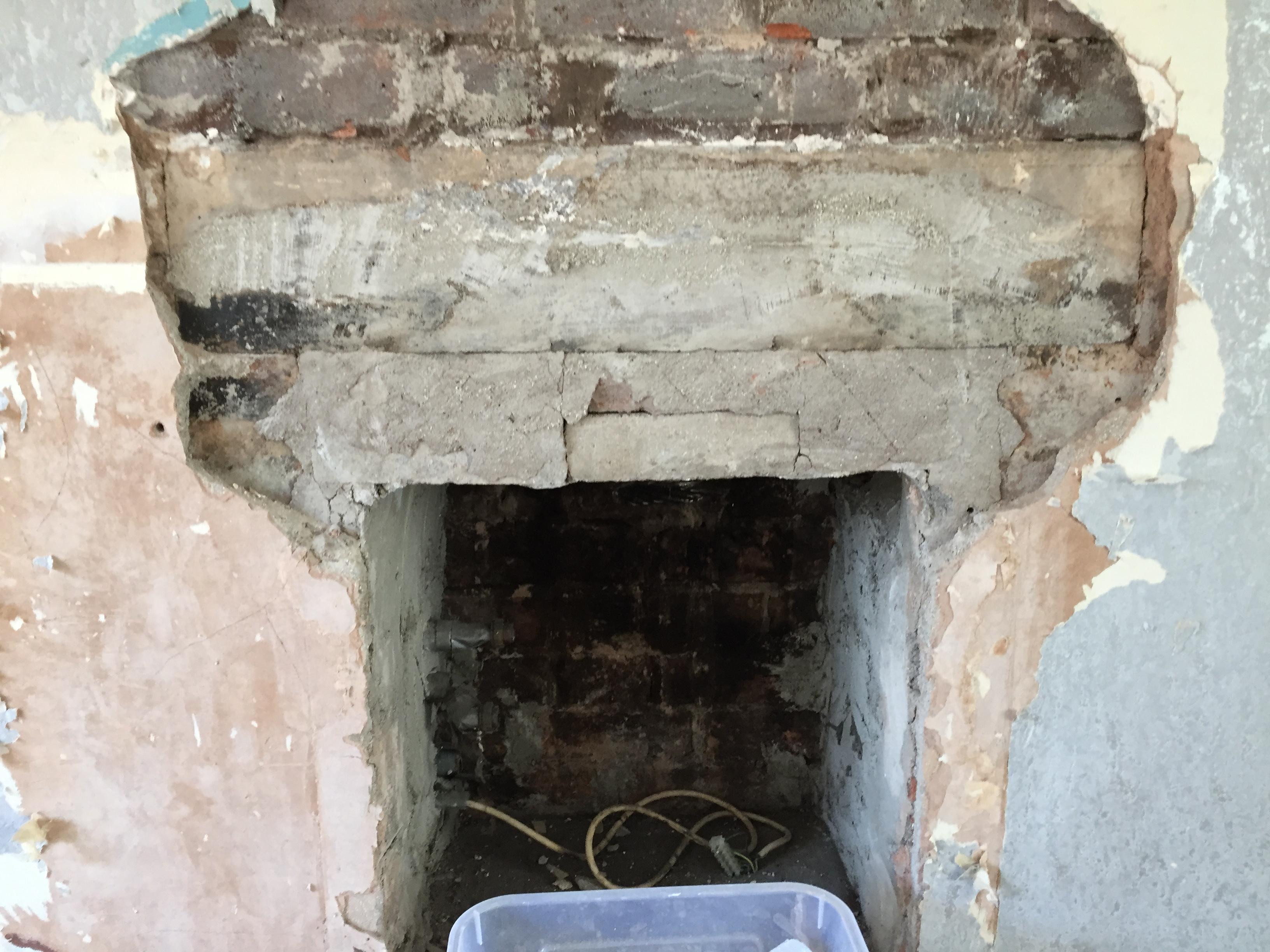

Craigbillo Posted April 29, 2021 Share Posted April 29, 2021 Hi all, I'm currently opening up my fireplace for a burner to be fitted. I think I have found the lintel. Any advice on if I can now remove everything below the lintel? Thanks! Link to comment Share on other sites More sharing options...
joe90 Posted April 29, 2021 Share Posted April 29, 2021 The lintel will still require at least 3 inches of brickwork to rest on and you can only remove those two rows of bricks below it, that lintel looks like wood from the picture, is it? If so you should replace it with concrete or steel. If that is the case make the opening as large as you want by moving the lintel upwards. 1 Link to comment Share on other sites More sharing options...
Temp Posted April 29, 2021 Share Posted April 29, 2021 (edited) Well you obviously have to leave the ends of the lintel supported so not "everything". Bearing ends are normally 100-150mm long. edit: posted same time as @joe90 Edited April 29, 2021 by Temp Link to comment Share on other sites More sharing options...
jfb Posted April 29, 2021 Share Posted April 29, 2021 Seems pretty straightforward to me - already has a decent bearing. Just take out the two courses below and make good. If the lintel is wood I would have thought you could clad the underside with some hardibacker or something like that. I used hardibacker as the register plate for my burner. But it looks like concrete lintel to me. Link to comment Share on other sites More sharing options...
Craigbillo Posted April 29, 2021 Author Share Posted April 29, 2021 Thanks all,appreciate the advice! Lintel is concrete, I've now removed the two rows of brick below and will take it from there. Link to comment Share on other sites More sharing options...
