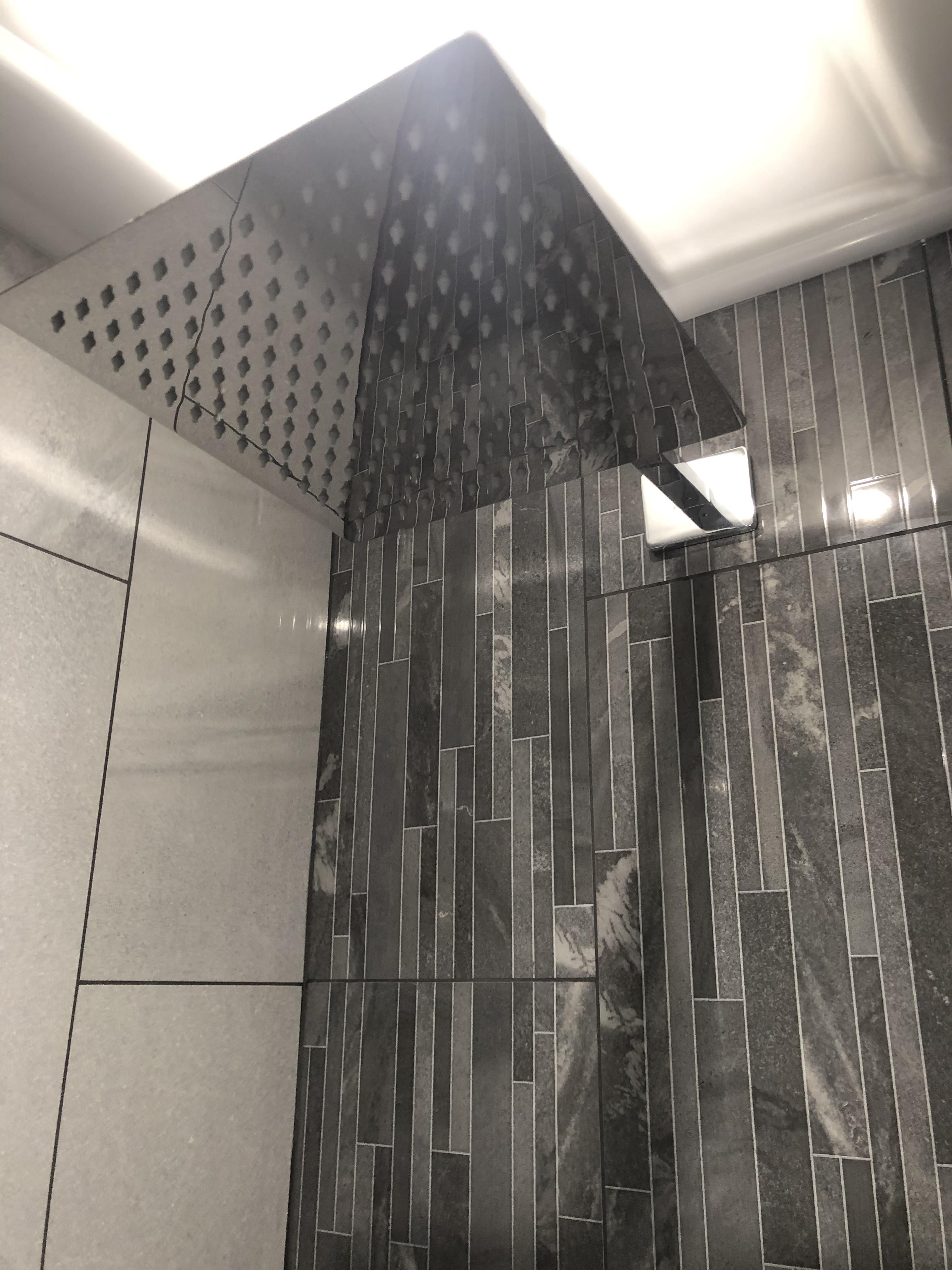

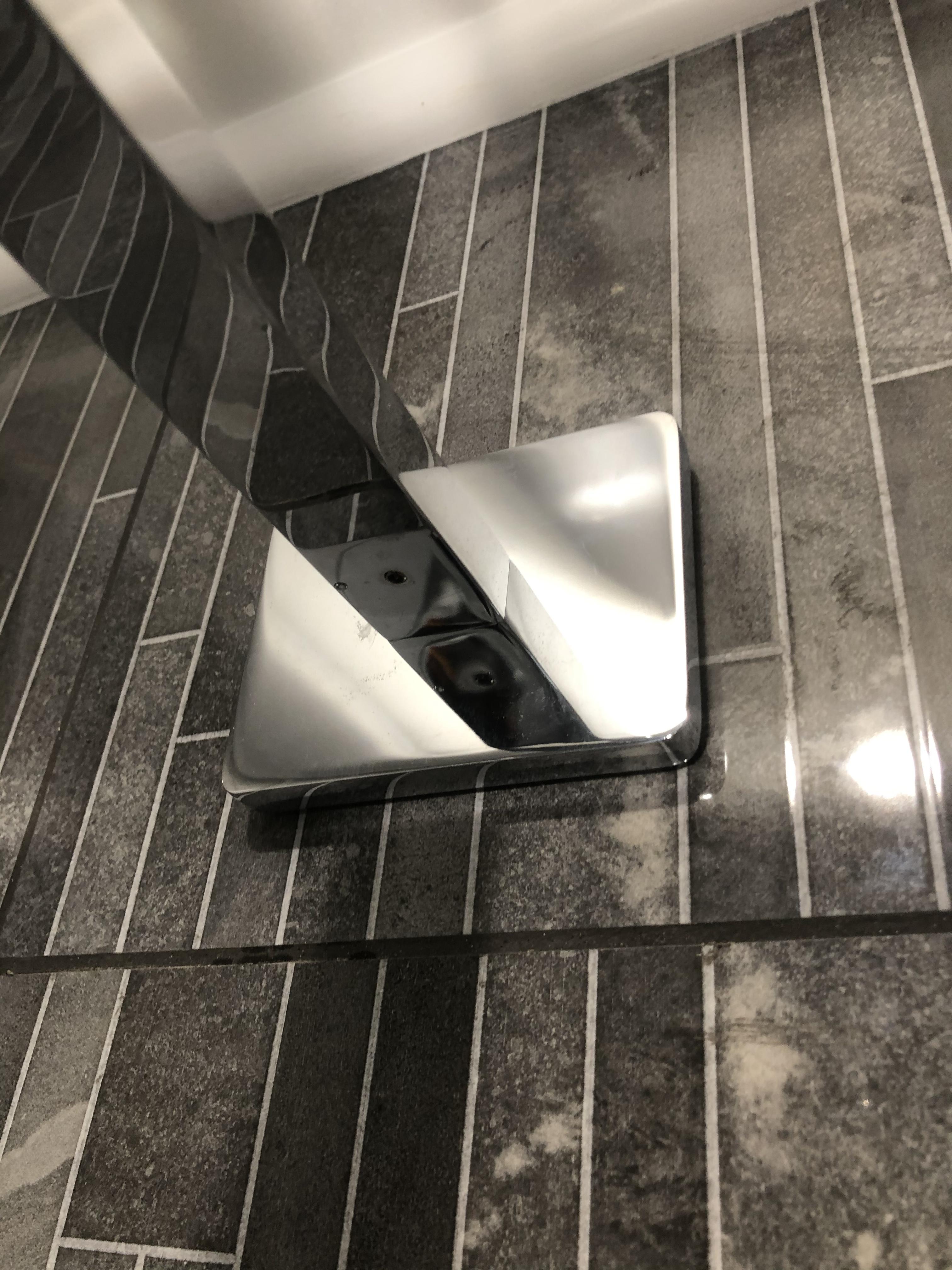

Tested the main bathroom shower . Was going to say zero leaks then noticed a patch underground ( tiger seal on order ) . Rainfall shower head seems leak free ( have the back wall exposed so can be certain ) . Notice the stupid nano size grub screw drips though !! . This common on this type of fitting ?? . I can live with it !!

That means the o-rings are not in place properly inside as that shouldn’t leak from there.
Ok . So the ‘arm ‘ for the shower head isn’t on far enough ? I.e tight enough to the fitting ... ?
Your ring isn't tight enough...
If the sticky out bit that the arm slides over is too short you MIGHT get away with a good slug of Jet Blue Plus at the interface.
Should the grub screw engage in a groove?

My rings always tight - you know that .
I think from memory there is a grove .
I can only access from the rear ( how many times have I said that ) . So might cut the supply hep20 . Then I’m free to move / bodge / professionally alter the fixing to suit .
Finally !
Taken all morning to fiddle with shower fitting , packing , plumbing .
At last a leak free grub screw !
Quite how you are meant to get that mm accurate from the front (I.e before tiling ) seems impossible too me !!

Inspired by my “skill “ I decided to take the back of the wall off where the shower hose elbow is . It’s to far forward by maybe 3 mm .
Mission Abort !!!
For reasons I’ll never know I had screwed pipes and clips to that board . So impossible to get off !!
Quickly put back on wall and screwed in . I’ll live with 3mm error - was going to silicone it anyway ?
