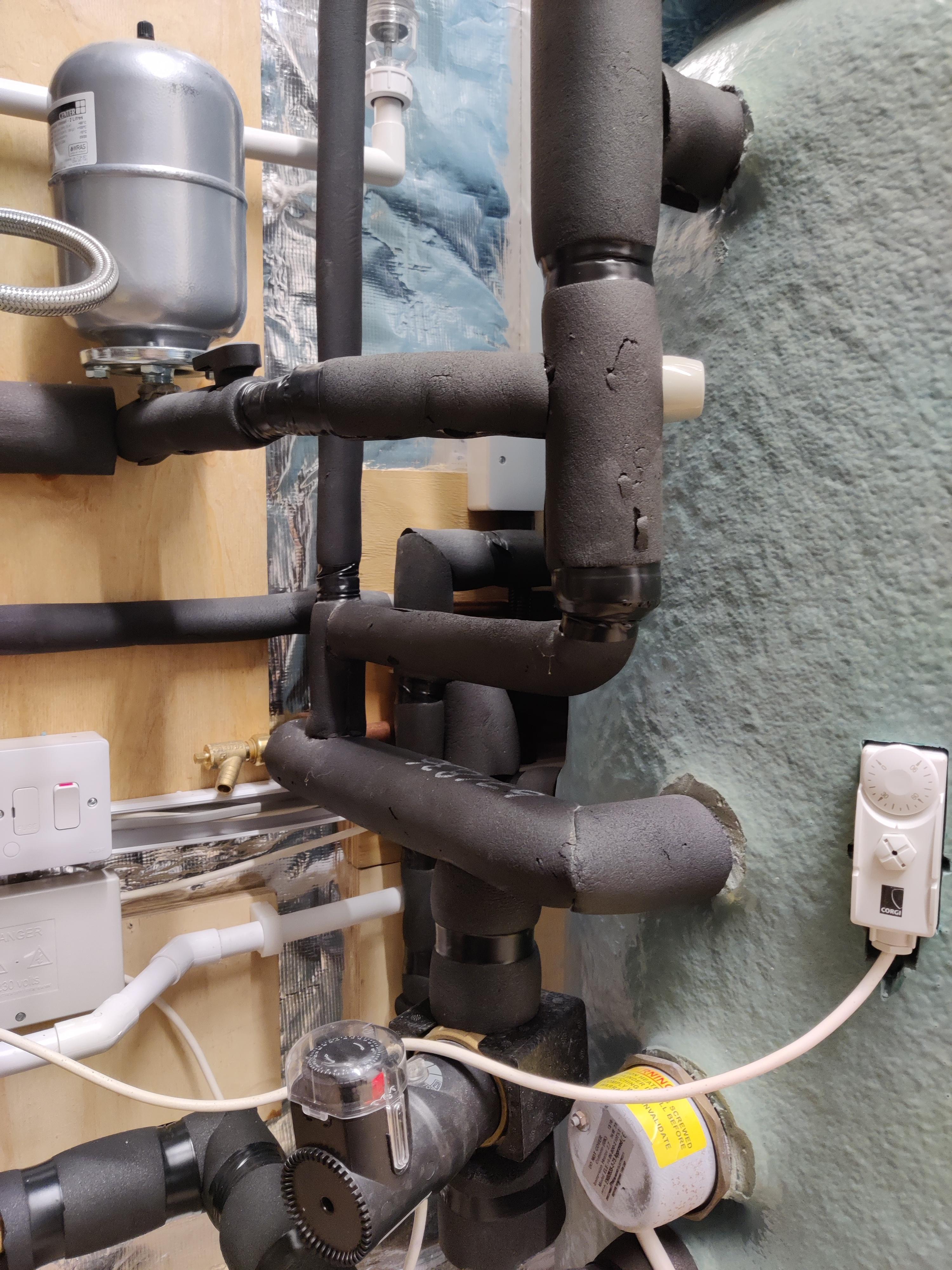

JohnMo Posted October 18, 2021 Share Posted October 18, 2021 It may be a bit late, but just commissioned a system similar to what you are looking at, here is what I have, after a few changes. Atag combi boiler, Telford thermal store (acting as a buffer with benefits) with boiler heating coil, DHW heating coil, mixing valve at outlet. Thermostat (middle of tank) set at 45 degrees, to reduce heat loss. UFH running at 30 degrees Solar PV Hook up, cold water to DHW coil, this passes through TS, and into combi, if it is hot or cold, the Atag boiler is designed to take pre heated water, so boiler doesn't care, the boiler only puts the energy it needs to the correct outlet temp. Upside, if preheated, you get great hot water flow. In the summer solar PV should do a lot of preheat. Have a secondary circuit, pump with simple timer at the out DHW outlet, so it can pick up hot water from TS coil or pass through the combi. Boiler was short cycling connected direct to UFH, so the UFH manifold now has mixer valve and pump added, this is connected direct to thermal store. Boiler connected direct to TS heating coil, boiler temp set at 50 degree. Advantages, boiler is always in condensing mode. Simple hook up, low standing losses as the tank is no hotter than 45 to 50 degrees. Link to comment Share on other sites More sharing options...
Olf Posted October 21, 2021 Author Share Posted October 21, 2021 Thank you, that is an interesting concept! How exactly is the secondary circuit connected, if your DHW goes through combi? And can combi really modulate so low, that it even with TS at 40-ish deg it does not complain when only low flow requested? I guess that below some cut-off point it will just pass lukewarm water from TS? Link to comment Share on other sites More sharing options...
JohnMo Posted October 21, 2021 Share Posted October 21, 2021 The cold water enters the combi via the TS DHW coil. The recirculation pump is on the cold side of the coil. Check valves force the recirculation return flow though the DHW coil and to the combi. The pump is the bit with the shiny plastic top, next to the immersion. Have tried lots of running curves and the 50 degree one is about as low as I can go. The pump runs for about 10mins every hour or so. The combi basically runs until the return flow is just about the same as delivery flow. Link to comment Share on other sites More sharing options...
Olf Posted October 21, 2021 Author Share Posted October 21, 2021 6 hours ago, JohnMo said: The recirculation pump is on the cold side of the coil. I get it now 6 hours ago, JohnMo said: The pump runs for about 10mins every hour or so So in effect tops up the TS via DHW side of the combi in the process Link to comment Share on other sites More sharing options...
JohnMo Posted October 21, 2021 Share Posted October 21, 2021 The pump runs for about 10mins every hour or so So in effect tops up the TS via DHW side of the combi in the process I have written that incorrectly. Should have said boiler runs for about 10mins per hour. That is the central heating runs for about 10 mins per hour. The secondary return, will pick up heat from the store if it's available, the boiler will fire the DHW as required. I only run the secondary return for an hour in the morning and the same at night. Link to comment Share on other sites More sharing options...
