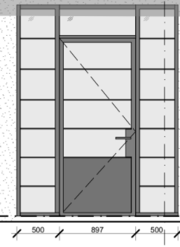

Adsibob Posted April 20, 2021 Share Posted April 20, 2021 I'm looking to buy a double glazed steel door with sidelights and top lights that looks like this drawing. I've got a couple of quotes but none of them are PAS24 rated (although they can provide toughened - but not laminated - glass and they can also provide multipoint locking). Based on my reading of Approved Document Q, it doesn't have to be PAS24 rated but it does need to have one of the other security ratings mentioned as an alternative to PAS24 which are one these: STS 201 Issue 5:2013 LPS 1175 Issue 7:2010 security rating 2 STS 1175: issue 3: 2011 burglary rating 2 LPS 2081 issue 1:2015 security rating B. Does anybody know if toughened glass and multipoint locking is sufficient to satisfy one of these ratings? If it is is not sufficient, can anybody recommend a door company that could supply what I need? A few people here have recommended Lathams but they make doors with much less glass than steel, so not quite the style I'm looking for. Link to comment Share on other sites More sharing options...
