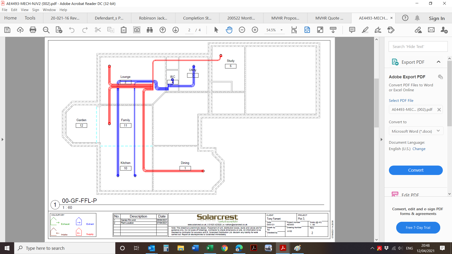

Danny68 Posted April 12, 2021 Share Posted April 12, 2021 Good evening hubbers, While I wait for planning to validate our plans ( 2 months tomorrow) I've been scribbling runs for the MVHR . I fully intend to get it sized by a professional but was just wondering if its imperative to have the same amount of outlets as inlets for balancing. Also would it be prudent to have double outlets on the shower room ,we're an all adult family of 5 and the current bathroom often has the look of a sauna . Also although a second bathroom upstairs is included i don't expect that to be hardly used but the downstairs kitchen although open plan will be quite large so possibly double up there as well Any thoughts ? Link to comment Share on other sites More sharing options...

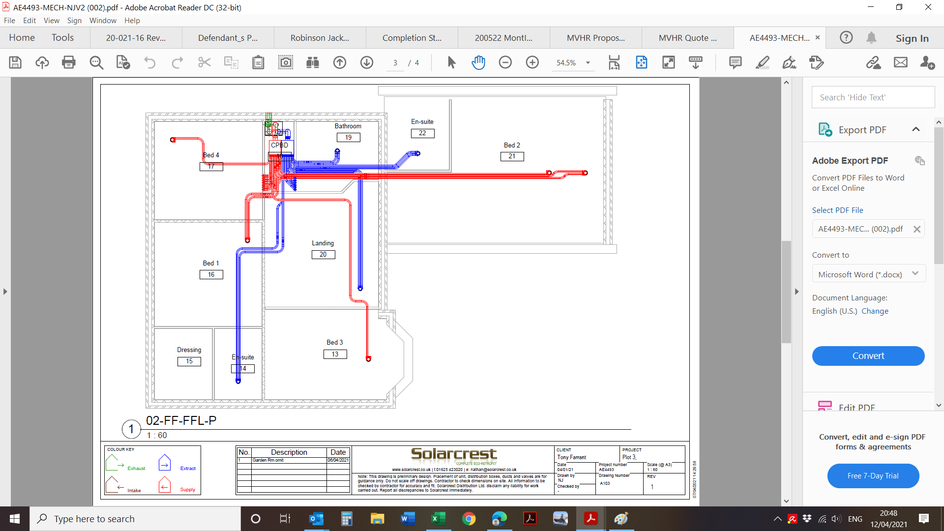

Faz Posted April 12, 2021 Share Posted April 12, 2021 Here is my layout designed by Solarcrest if it helps mate. Link to comment Share on other sites More sharing options...
