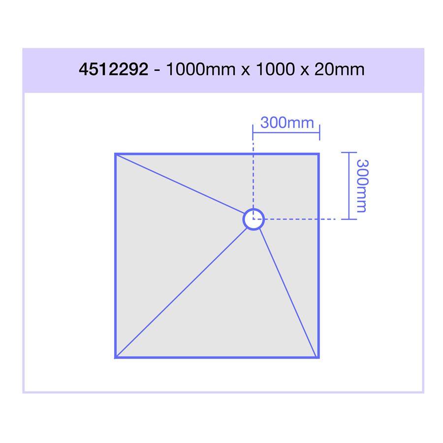

Triassic Posted April 11, 2021 Posted April 11, 2021 I’ve got a shower room with a curved wall, into which I want to install a walk in shower. As the curve won’t take a standard quadrant shower tray I’m thinking of using a square, 20mm thick, Jockoboard shower tray former and radiusing the corner opposite the waste outlet to form the quadrant. Has anyone done this and will it work?
Oz07 Posted April 11, 2021 Posted April 11, 2021 Why wouldn't it. I used some of that board it's nice to cut. You must be a sucker for punishment curved wall on a shower!
Triassic Posted April 11, 2021 Author Posted April 11, 2021 11 minutes ago, Oz07 said:You must be a sucker for punishment curved wall on a shower! That’s why we’re into our fourth year of our self build !
nod Posted April 11, 2021 Posted April 11, 2021 As above easy to trim to a curve Curve walls in showers look great We do lots in high end homes ? Seriously like look fab with mosaic tiles Some pics as you go will be nice Hoping my wife doesn’t follow this thread As I’ll have loads of my own pics to put up
