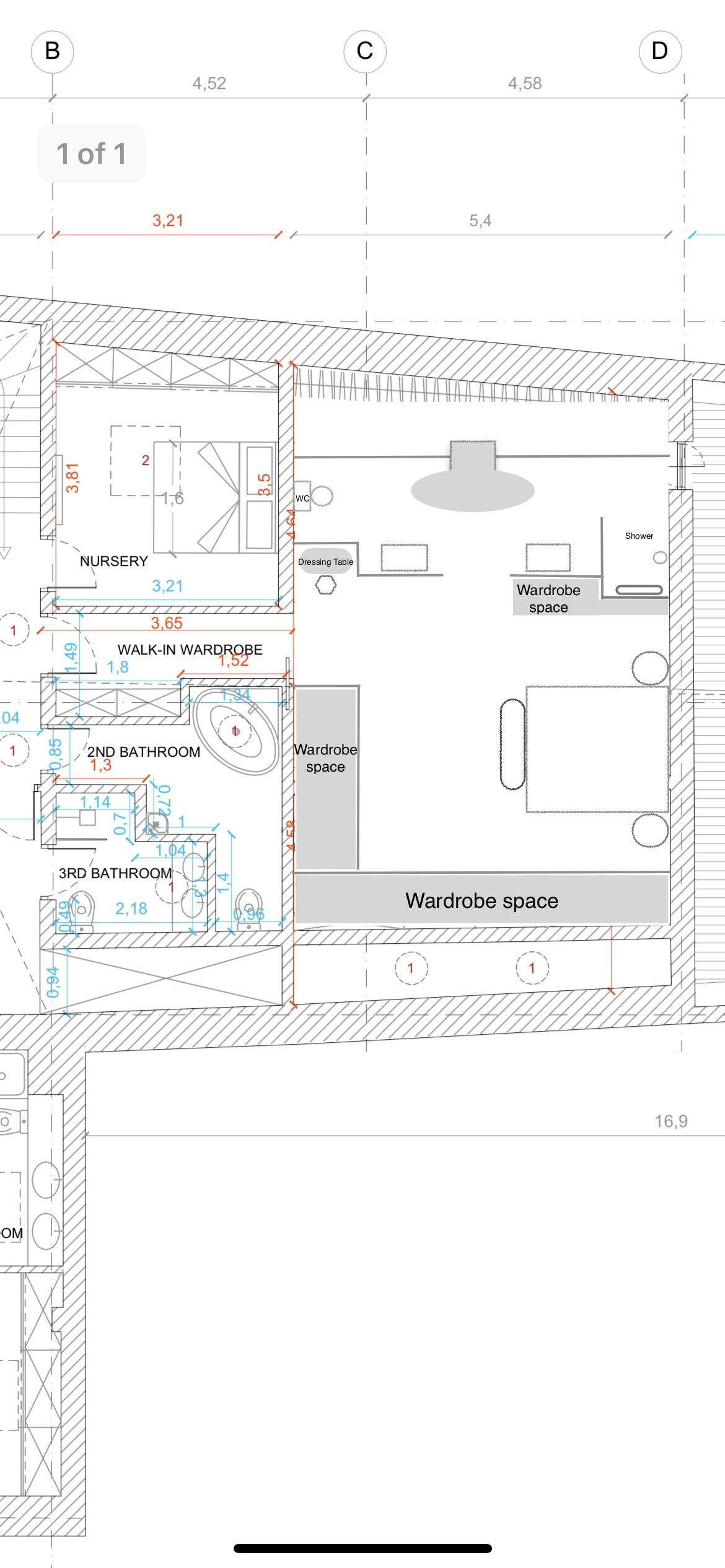

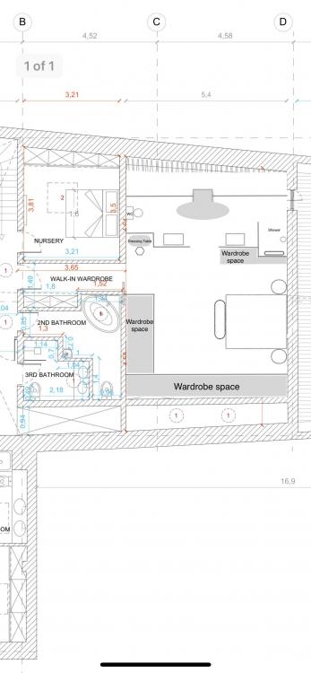

ashthekid Posted April 10, 2021 Share Posted April 10, 2021 I'm told I definitely need an escape window in the master bathroom which is just off the bedroom in the top right bedroom and the top hung Velux window is directly above a bath. this is required to be no more than 1100mm from FFL. My question is: I'm not quite sure if the Velux window in the nursery bedroom requires an escape window as well because the room is directly accessed from the landing/top of the staircase. Is this correct or do I still need one? I would prefer not to as the vaulted ceiling is quite low and would be annoying to have to put another escape window in so low in there. I just wanted to check what the building regulation was on this? I assumed the master bathroom needed it because it was a room within a room that didn't have direct access to the staircase, whereas this nursery bedroom does. Link to comment Share on other sites More sharing options...
nod Posted April 10, 2021 Share Posted April 10, 2021 Your building control should be pretty clear on this ALL Rooms above ground floor will need an escape Bathrooms are exempt I wouldn’t of though the landing would need an escape either I know I didn’t bother Link to comment Share on other sites More sharing options...
DevilDamo Posted April 18, 2021 Share Posted April 18, 2021 As above. All habitable rooms on the first floor would require a window or door that is suitable for means of escape. A connecting door between two adjacent rooms is also deemed acceptable subject to one of those rooms being provided with an escape window/door. If you are unable to provide escape windows/doors to the habitable rooms that require it, you will need to provide a protected staircase with a door leading to a final exit. You do also have the option of providing a secondary means of escape but this is very rare for dwellings. Bathrooms and En-suites are not habitable so do not require an escape window/door. Ask your BCO where in the BR’s it states this as a requirement? Link to comment Share on other sites More sharing options...
