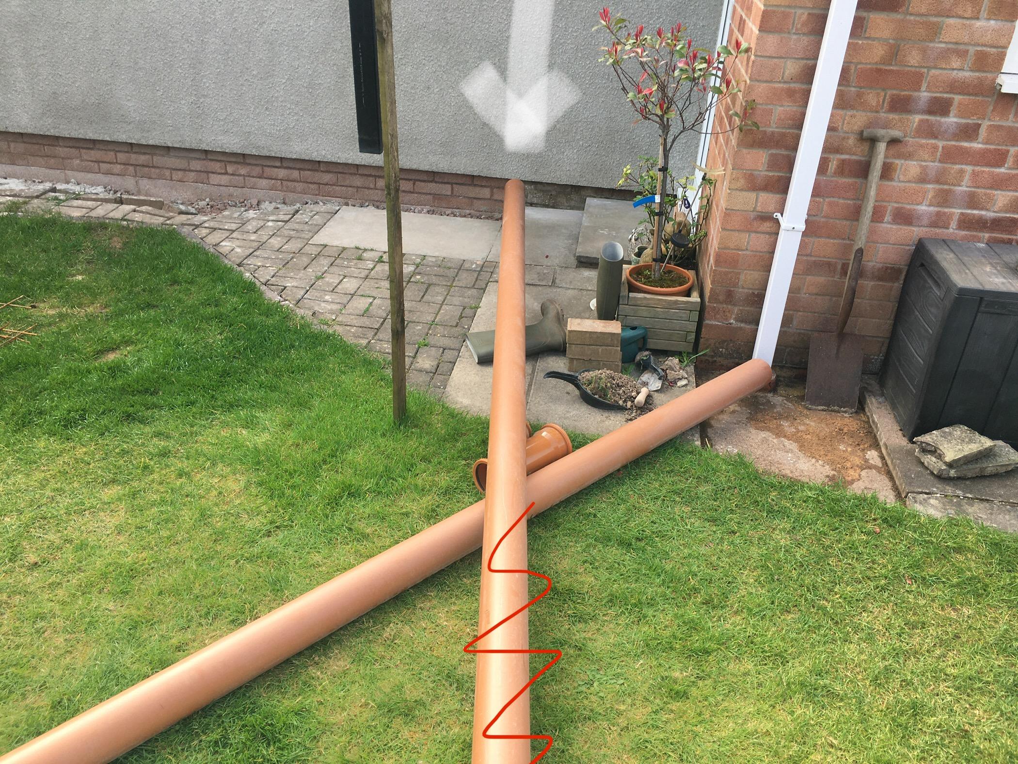

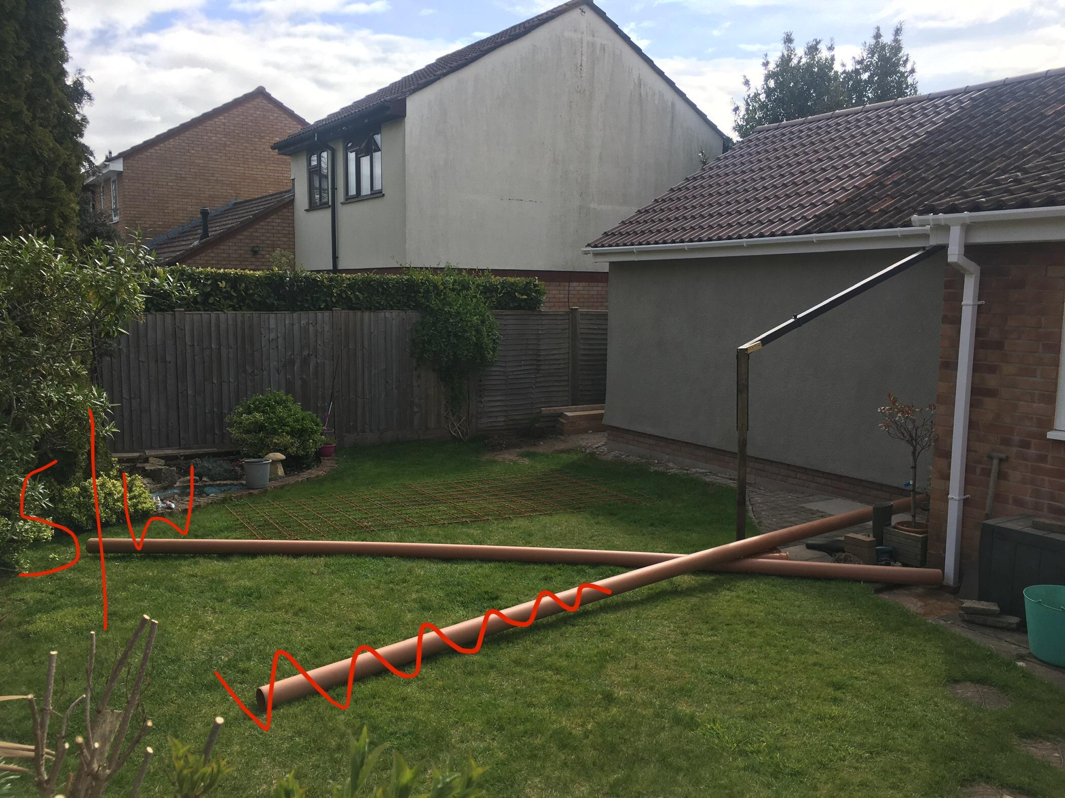

I am going to dig a soakaway fed by 2 rainwater down pipes.
I’m looking to branch off using a 45degree fitting as shown below.
Each down pipe will enter bottle gullies. Is a 15 degree bend a common angle to connect to each gully to give me the fall?
My entry points are fixed. Is there another way to achieve what I need that I have overlooked, perhaps running 2 straight pipes in to the soakaway to avoid the branch?

You need about 3° fall not 15° unless you like digging deep holes ..!!
Geotex provided is fine - it’s just to stop soil getting into the crates.
Posted
Don’t want to dig anymore than I have to! ?
Perhaps adjustable bends are the way forward!
