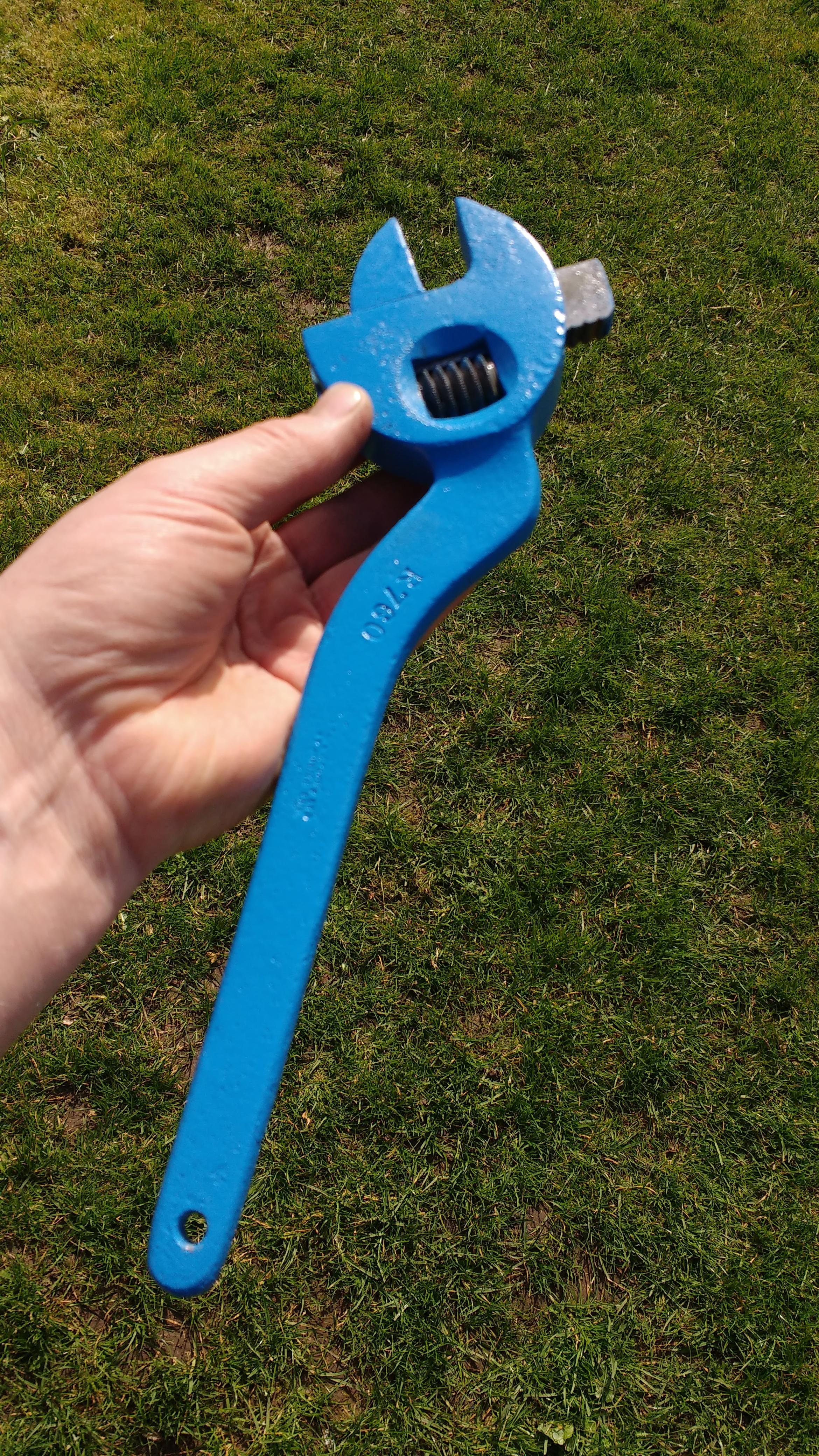

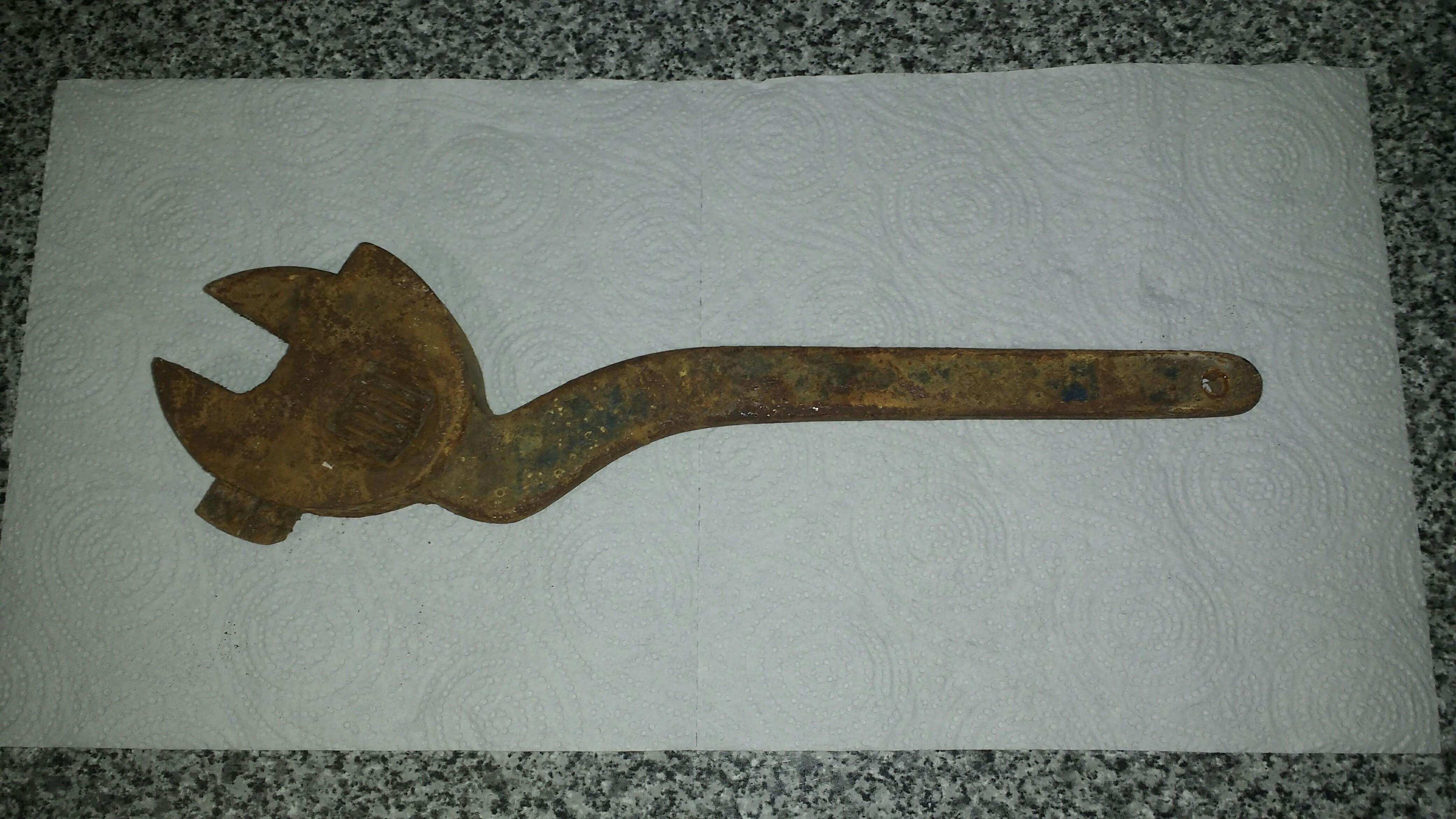

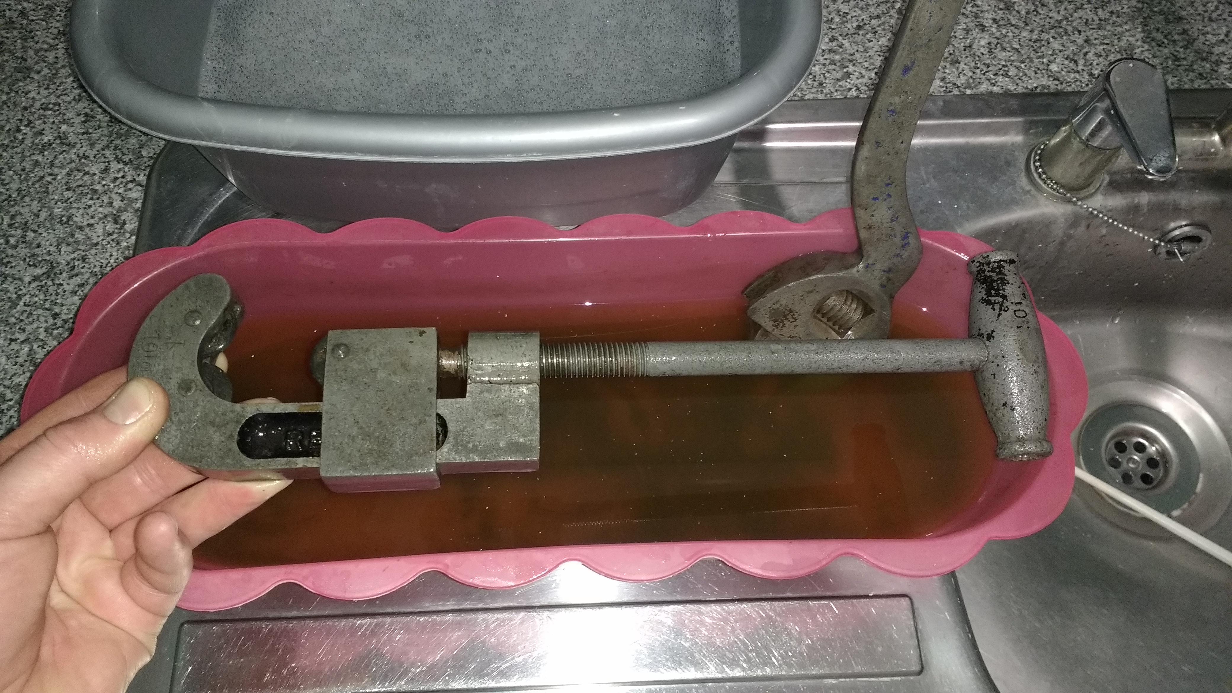

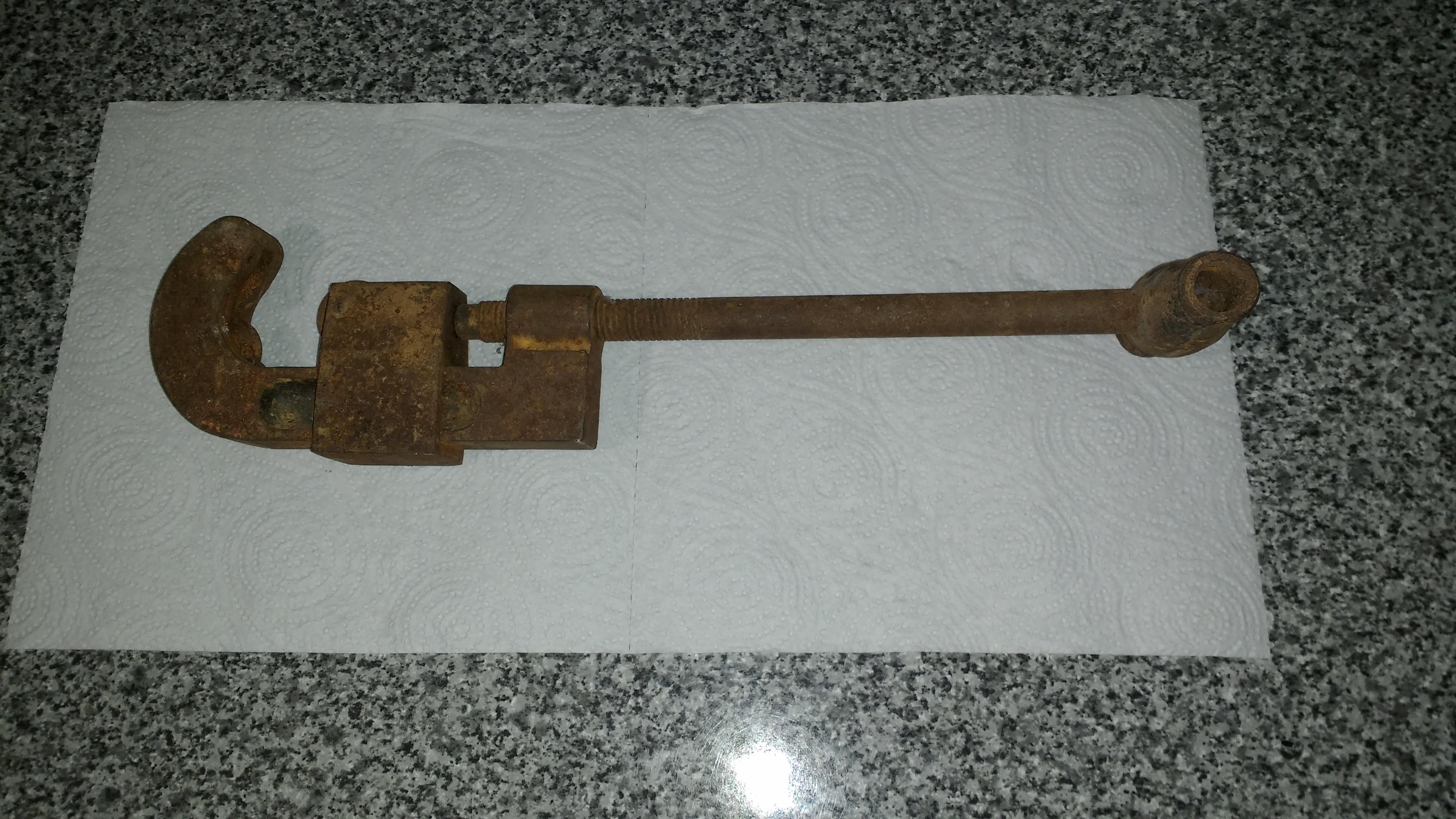

I've been restoring some old tools salvaged from a house clearance.
After a hot detergent wash then some time in a hot citric acid bath I've etch primed and given the adjustable a quick coat of acrylic:

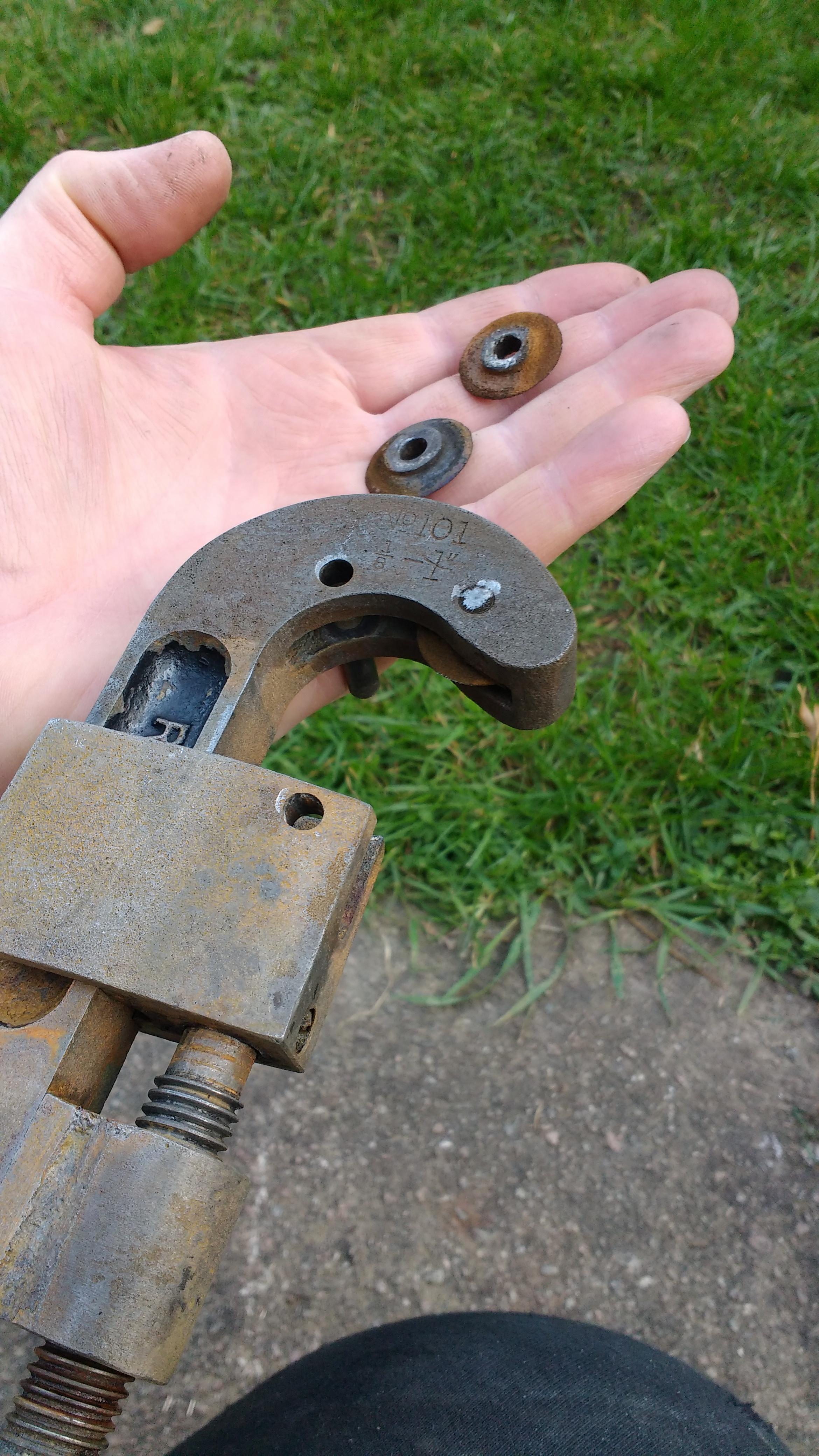

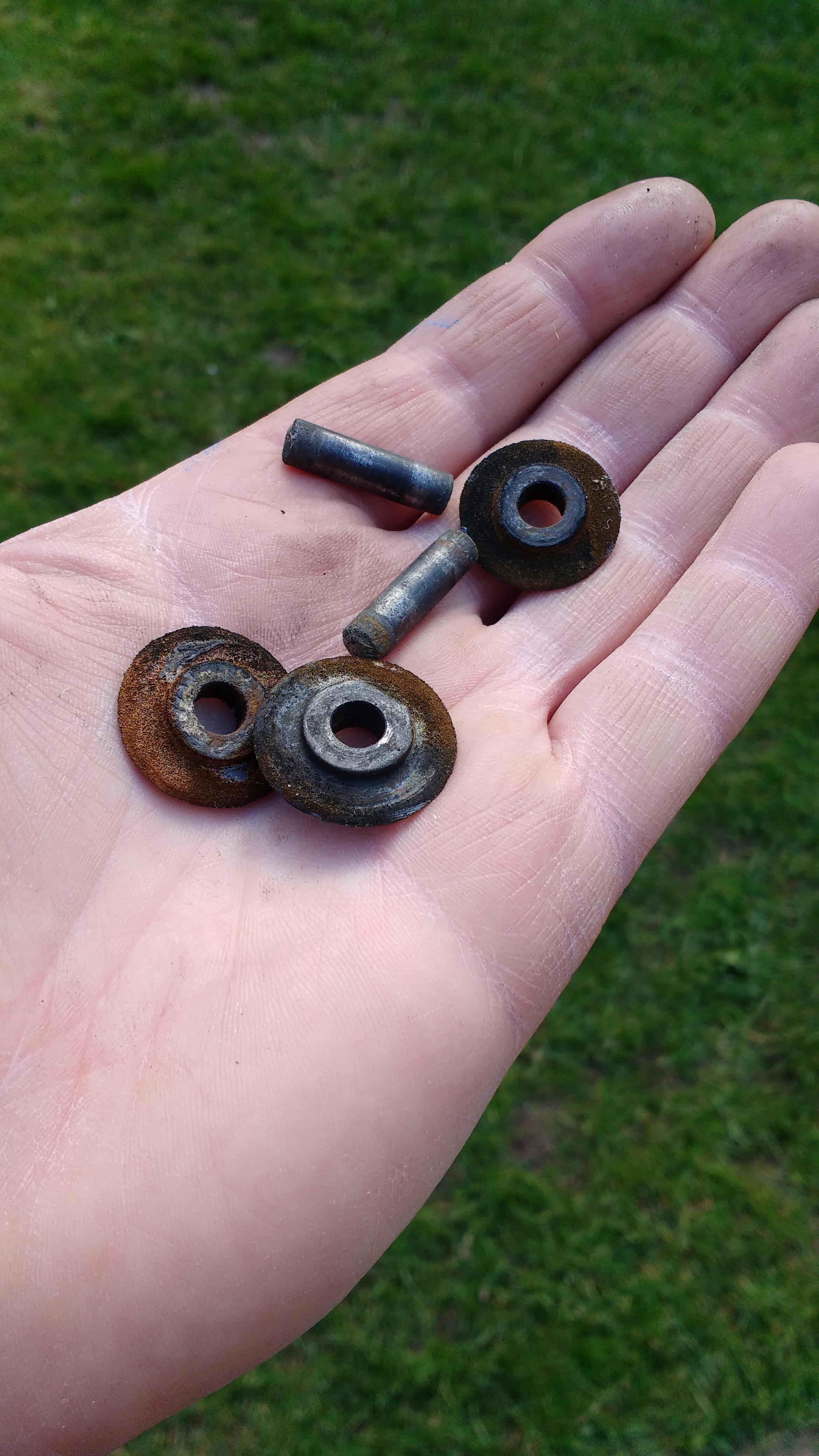

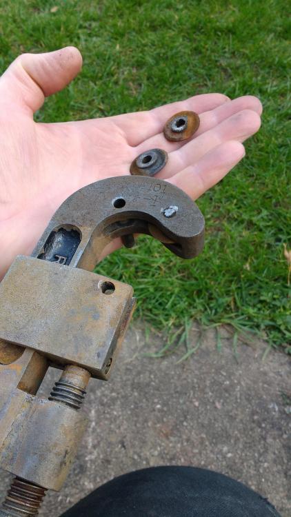

Anyone know where I can get 3 wheels and pins for the Record No.101 pipe cutter? (I just lost one pin).

For a different model, but try contacting this one and see if they are the same size  https://www.ebay.co.uk/itm/Joblot-Record-104-steel-pipe-cutter-wheels-and-pins-3-wheels-3-pins/254912533367?hash=item3b59f89377:g:ZJYAAOSwUj5gWKoQ
