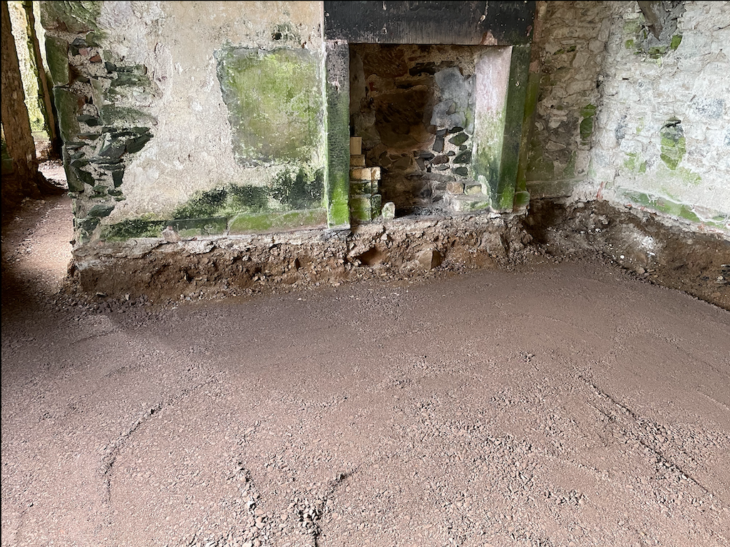

NWGEAR Posted April 1, 2021 Posted April 1, 2021 The scenario is a barn conversion with 50cm thick stone walls. Internal structural timber frame is specified demoting the stone walls to a facade rain shield. The architect notes specify application of Sovereign Hey’di K11 to the internal stone surface to mitigate damp issues. The builder "ain't seen this before" and doubts the effectiveness given the timber frame has the usual comprehensive DPM and vapour barrier 50mm stand-off from the stone walls. The 50mm cavity is to be ventilated. I support the builder's pragmatic view, but I'd like something on the stone wall, not least to prevent debris falling into the cavity off the stone wall (natural stone with lime pointing). The question for you lot is whether to go ahead with the K11 tanking or don't bother. The builder showed a couple of other jobs drawings where it's not specified. Perhaps a case of belts and braces from the architect. An aside is the following pic, finally getting started on the build, floor dug and prepared waiting on steel mesh and sub-floor. ? (builder also reckons mesh is overkill +£500)
PeterW Posted April 1, 2021 Posted April 1, 2021 I like your builder. Mesh in solid floors especially where they are on solid bases is pointless until you get over around 30sqm and even then adding fibres is simpler and cheaper. Architect has specced a pointless product too - I assume you’ve read the BBA Cert..?? Sovereign Hey’di K11 is a salt resistant cementitious tanking compound for the protection of structures against water from the ground and which maybe potentially subject to hydrostatic pressure. So basically it’s only designed to protect from ground water ie below ground installs, and you’ll probably create more problems than you solve.
