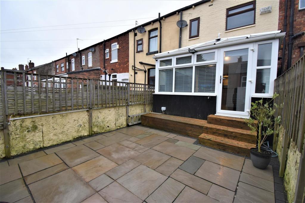

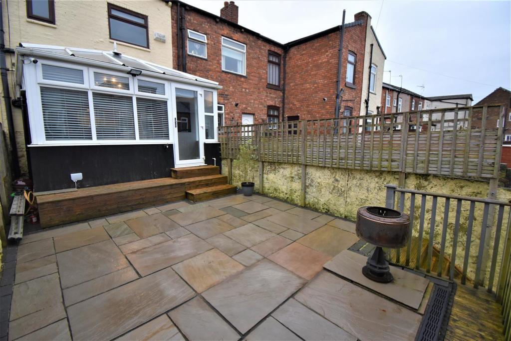

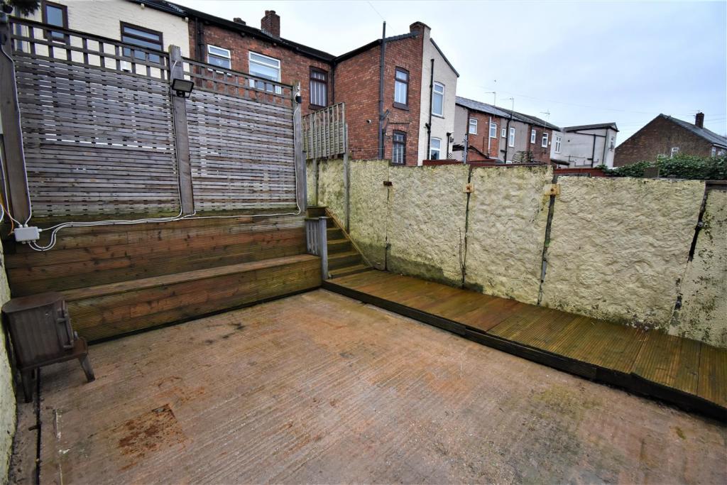

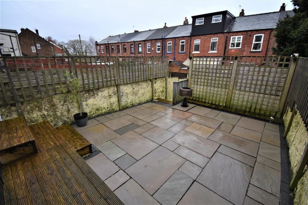

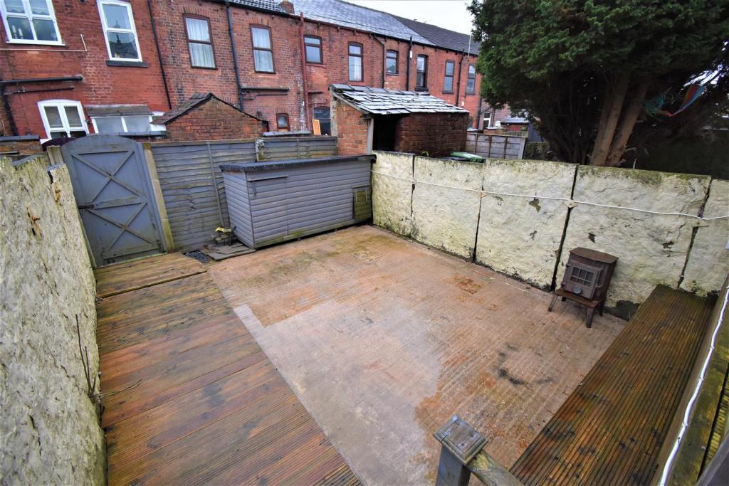

Jack__ Posted March 31, 2021 Share Posted March 31, 2021 Hi everyone. I am moving into this house soon and the surrounding stone walls are a real eyesore. Does anyone have any ideas as to how heavy these walls will be and how much of a hassle they will be to take down. I am planning on replacing them with standard wooden fences. But is it worth the time and money or would it be best to just try and cover them? Please and thanks Link to comment Share on other sites More sharing options...
dpmiller Posted April 1, 2021 Share Posted April 1, 2021 who owns the walls, and what height is the ground behind them? Link to comment Share on other sites More sharing options...
Gone West Posted April 1, 2021 Share Posted April 1, 2021 Looking at the steps going down there are different levels so are the concrete panels acting as retaining walls. Link to comment Share on other sites More sharing options...
Mr Punter Posted April 1, 2021 Share Posted April 1, 2021 You could screw these https://www.forestgarden.co.uk/product/1-8m-x-1-2m-pressure-treated-contemporary-slatted-fence-panel/ to the front, painted if you want. Cheaper from other retailers. Link to comment Share on other sites More sharing options...
