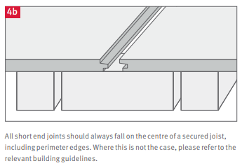

SimonD Posted May 10, 2021 Posted May 10, 2021 51 minutes ago, PeterW said: 18mm OSB is support all 4 sides even with T&G 18mm OSB only needs support at short ends on joist, no extra framing required.
PeterW Posted May 10, 2021 Posted May 10, 2021 But if the short edges are not supported or land between then you need to nog it out.
SimonD Posted May 10, 2021 Posted May 10, 2021 2 minutes ago, PeterW said: But if the short edges are not supported or land between then you need to nog it out. Yes, of course, but isn't that the case with any floor board? And surely you'd frame your floor to avoid that problem.

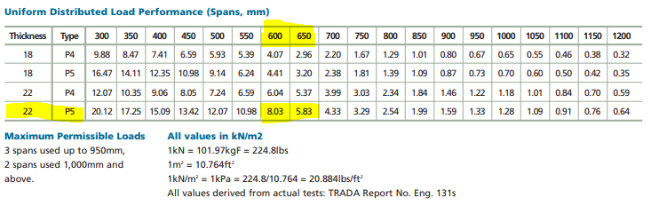

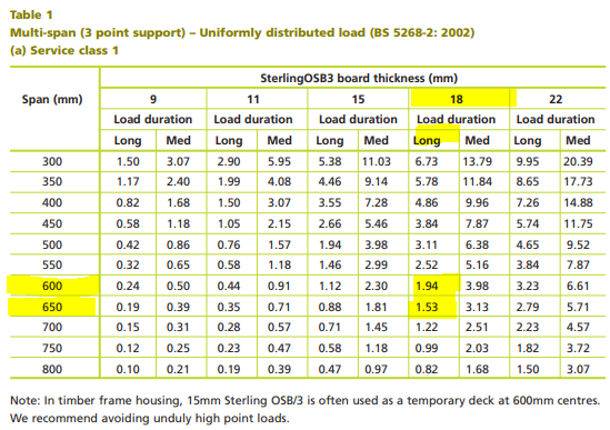

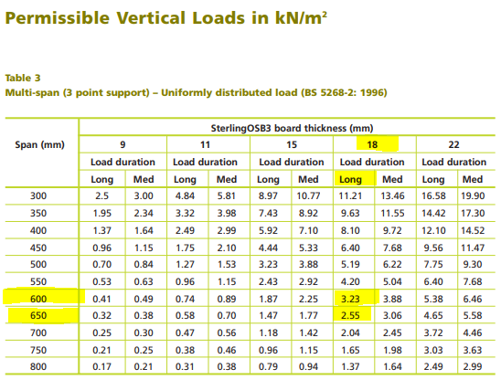

MortarThePoint Posted May 11, 2021 Author Posted May 11, 2021 Squareness tolerances are generally quite poor: 3mm/m I'm a bit confused by the tables below as they suggest P5 has much higher UDL capacity than OSB3. The P5 DOP has a Bending Stiffness of 3500N/mm2 and a Characteristic Bending Strength of 11.7N/mm2. The OSB3 DOP has Bending Stiffnesses of 4930N/mm2 along one axis and 1980N/mm2 on the other axis and Characteristic Bending Strengths of 14.8 and 7.4 N/mm2. OSB3 (2008 I think): link CaberFloor P5: link
MortarThePoint Posted May 11, 2021 Author Posted May 11, 2021 On 10/05/2021 at 10:49, PeterW said: But if the short edges are not supported or land between then you need to nog it out. I believe you need to do this with all P5 including Egger Protect: https://www.egger.com/get_download/17e6c5ab-960a-4e7d-99ee-c46608c62f3a/Flyer_Advanced_Structural_Flooring_System_Fitting_Guide_UK.pdf On 10/05/2021 at 11:20, PeterW said: No - 22mm Egger can land anywhere and is self supporting. Do you have a reference?
