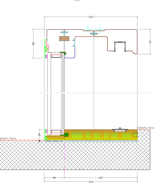

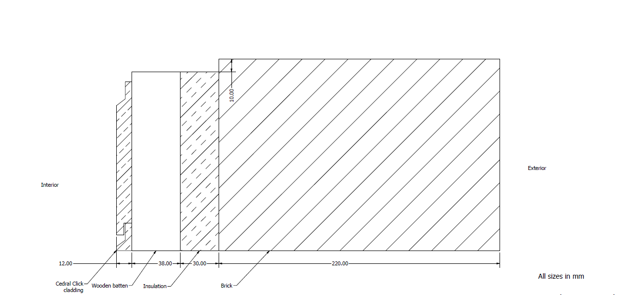

Pep Posted March 25, 2021 Share Posted March 25, 2021 Hello everyone, I am planning to install a lift and sliding alu-clad timber window in my property. I have attached a vertical cross section of the wall on which the lift and sliding window is going to be mounted. The window will be installed on the outer edge of the wall however I am not sure what sill/drainage system should be used in front of the window so that water is drained away and prevented from coming into the space between the cedral click and the outer edge of the wall? Any ideas/thoughts would be greatly appreciated as I cannot find any solution online that would work for me. Thank you. Link to comment Share on other sites More sharing options...

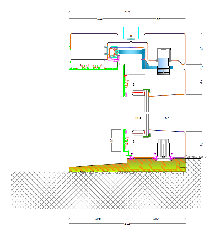

Pep Posted March 29, 2021 Author Share Posted March 29, 2021 Craig, Thanks for your message. Currently looking into the system as per the attached files. I've uploaded drawings of the fixed and the movable sash cross sections. In my case, the threshold would be removed on the movable sash picture. Thanks again. Link to comment Share on other sites More sharing options...

craig Posted March 30, 2021 Share Posted March 30, 2021 If I'm not mistaken, it's an Italian system? I'm thinking Pavanello Serramenti but they may be sticking in my mind because they were chasing me to be a UK distributor for them. Details look a little different but definitely Italian. If removing the front section on the moveable (sliding sash) side), then you're left with a straight edge and what appears to be exposed timber? You need to be able to catch the water that runs down, I'm presuming hardwood if it is timber? If timber, I'd be wanting a small rebate in it (4mm minimum) so that an external alu cill can be fitted and when the water runs down, it doesn't get behind the cill and drains properly. Link to comment Share on other sites More sharing options...
