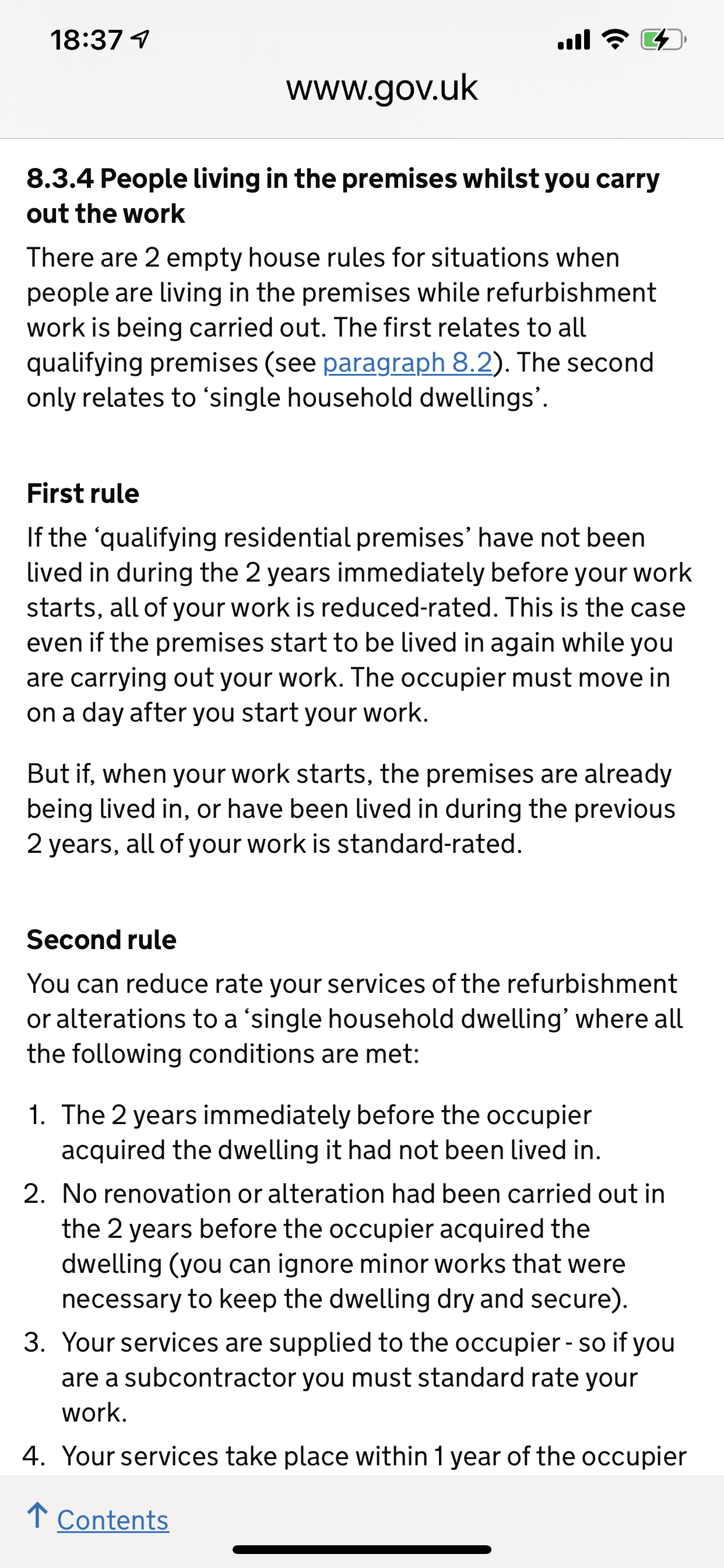

newhome Posted March 22, 2021 Share Posted March 22, 2021 First of all you need to read the following to ensure that you retain the ability to pay 5% VAT on any work done by VAT registered builders. This is from VAT notice 708. I don’t believe that you can use your Ltd company to put through purchase of building materials through for the following reasons: You would have to pay the going rate for work done through a Ltd company that would need to be put through as income on which you would be charged Corporation Tax. If you are talking about charging the going rate through your company this might be a possibility. If you do the work for free or almost free, and only repay the cost of materials this isn’t legal as you are not then buying the materials for the business. A ltd company can’t be used as a halfway house to avoid paying VAT. If there were a sudden increase in purchases without a corresponding increase in sales this may appear suspicious and could leave you open to an inspection which would be very tricky to negotiate. They have 6 years to open a case so this approach is not recommended and no sane accountant would advise you to do this. For an IT company to suddenly start building transactions might be a bit suspicious. You definitely need professional advice on this. Link to comment Share on other sites More sharing options...
