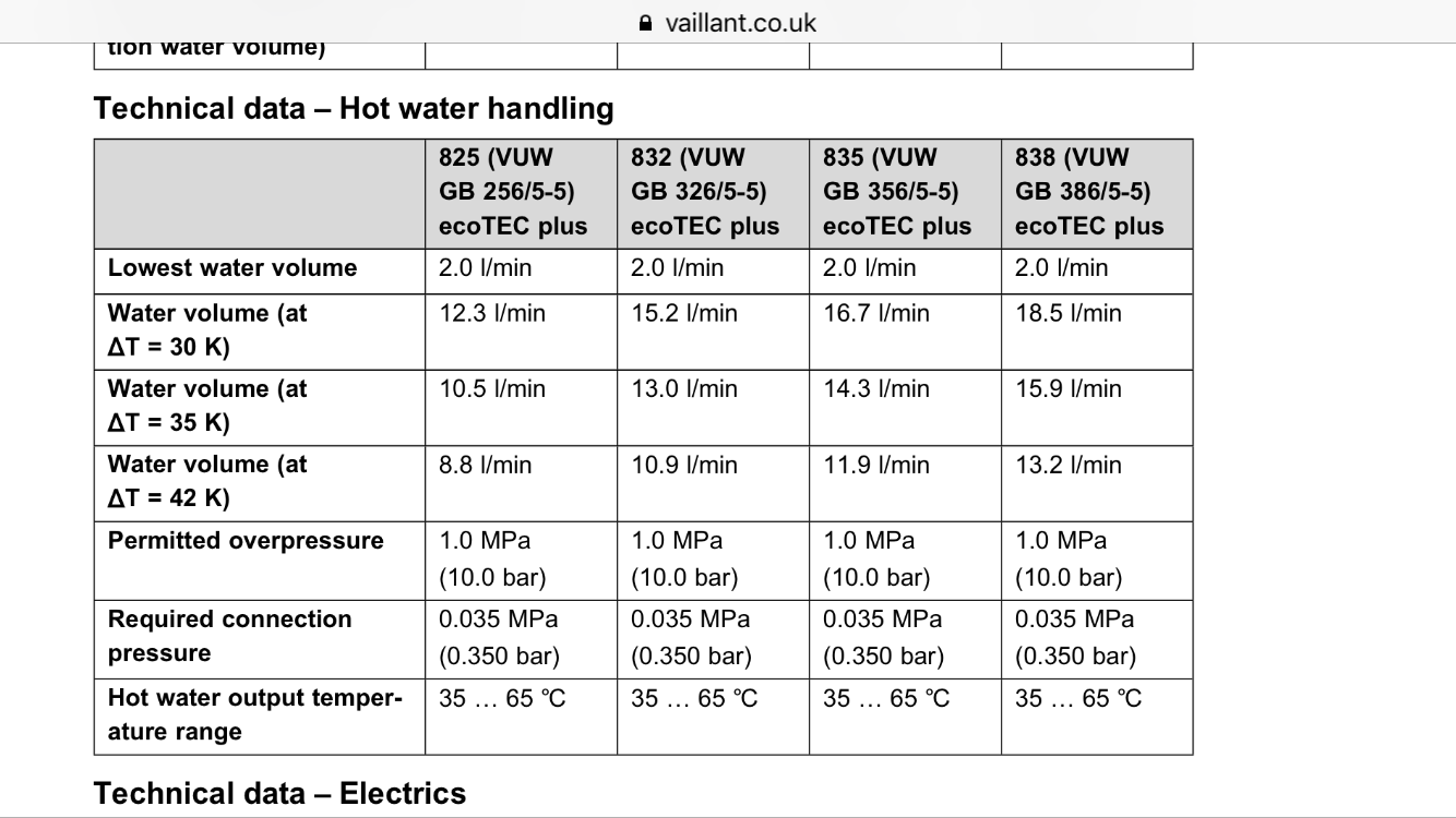

I've been trawling through old posts as I remembered a certain model boiler being recommended. Turns out it was the EcoTec 938 (38kw).
Looking at Vaillants web site that is one hell of a chunk of boiler, 60kg and 600mm projection. I assume these specs come from the fact that it has the "reservoir" of stored hot water.
Would I be correct therefore in assuming that the 838 is basically the same boiler but considerably lighter/smaller because it lacks this facility.
And if so what are your thoughts on the 838???
Thanks for any enlightenment.

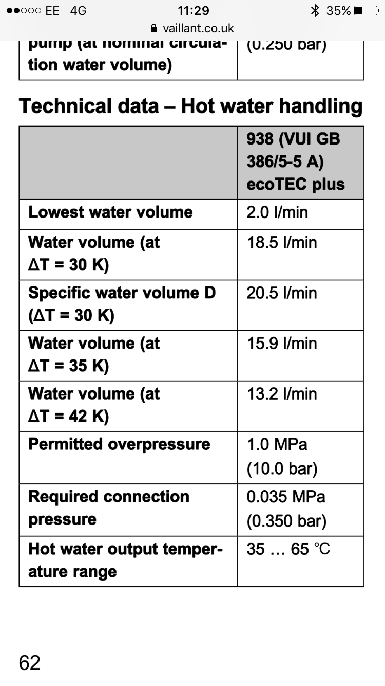

Thanks for that Fallingditch
I have just been comparing the spec sheets for the 838 & 938. The only differences I can see are the obvious weight/dimension and the maximum electrical power consumption differs by 20w.
The flow rate is the same for both boilers.
So it looks to me that if you forego the "instant" hot water element you get a smaller boiler that should still run two showers simultaneously.
Can anyone see ant flaws in my thinking??

Dhw specs of the 838
and 938
For running 2 showers, the 938 is far better imo. Very much similar results to having a 200ltr UVC as the stored water blends in to reinforce DHW delivery from the plate heat exchanger.
Benefit with the 938 Is also when the house is occupied throughout the day and lots of small amounts of DHW are being drawn off, washing hands after loo / swilling the odd dish etc, as there is no delay in getting the hot water to the outlet other than the pipe run.
Both good machines, but if you want as near to UVC performance as you can get without having a cylinder, it's the 938 all the way. For a combi the DHW delivery is quite remarkable, but remember it's cold mains dependant so a crap cold mains = crap DHW, ( REGARDLESS of the boilers capability to provide it ). ;)
