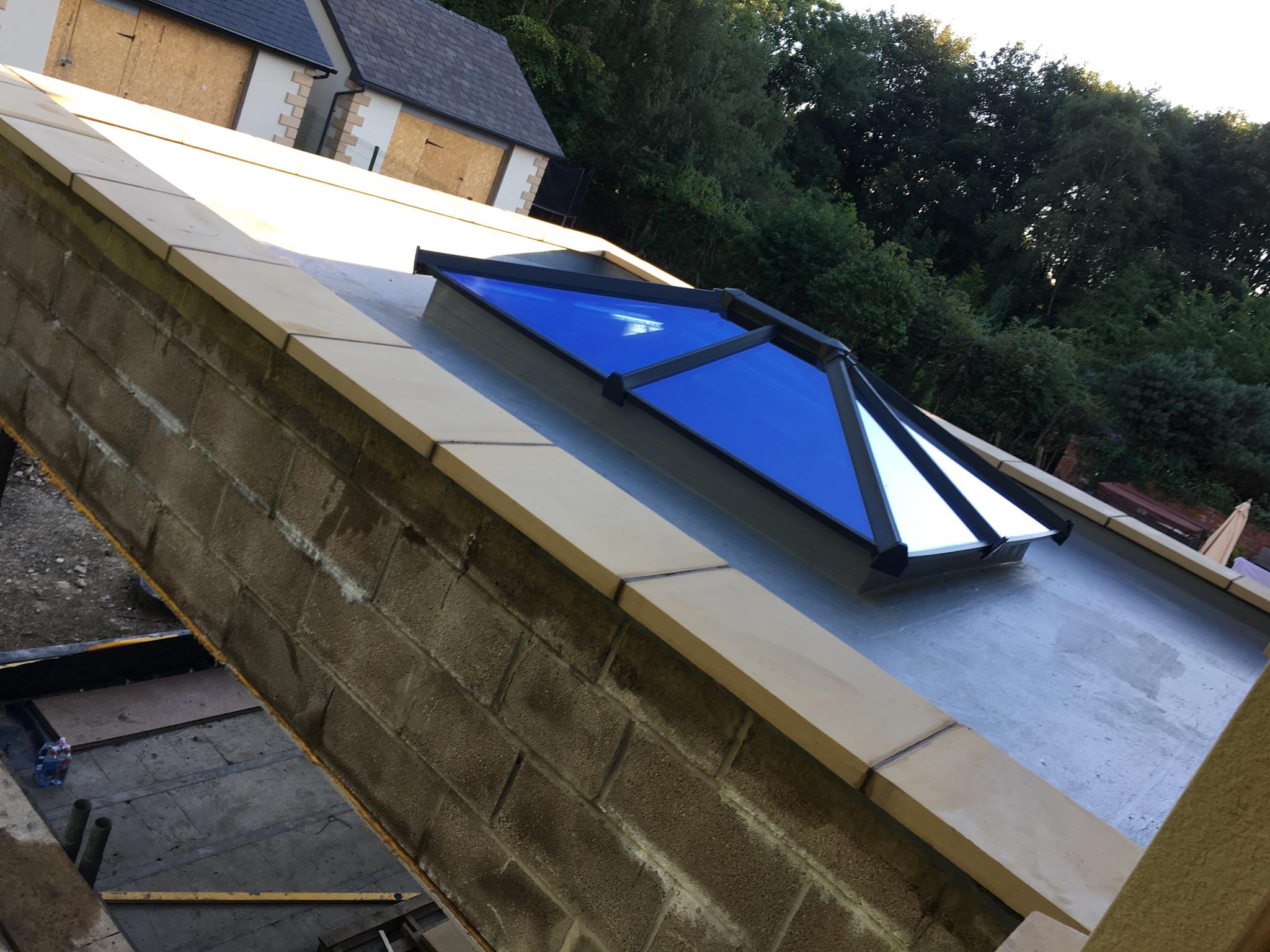

Porcelain would be fine
I wouldn’t rely on a capping to seal the parapet
I fixed ply on the top of the parapet and returned the fiberglass over the top of the ply and the stone coping just became decretive
If yours is more like a balcony with brickwork showing
You can do the same with a 50 mil lap and trim

So no concerns with the thickness or them being flat on a parapet wall? Unfortunately they don't do once weathered. My theory is that with membrane up and under copings on one side and a DPC in place on the other extending 5mm past brickwork, as in your case if the copings do let some water through, it shouldn't have anywhere to go.
The below gives you a visual of what is in place currently... It leaks!
The old copings are being removed and replaced with the flat porcelain ones. The roof membrane is being replaced and taken up and under the lower parapet wall. The higher parapet wall would look horrendous if we were to take the membrane up and under so a DPC protruding 5mm either side will hopefully suffice. Lead saddles to be used at abutments (none in place currently)
Membrane to run up higher than it does at present on other walls.
