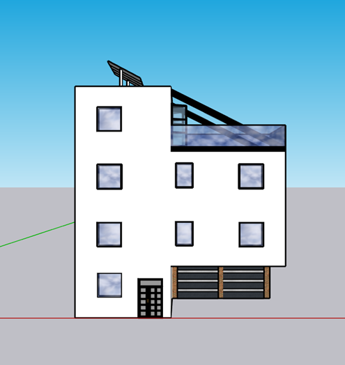

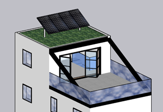

JJD1 Posted March 6, 2021 Share Posted March 6, 2021 Hi, I am planning a self build project in London which is on a constrained site (11x6m) and initial designs include a cantilever. It's likely that the supporting 'column' will be 5m wide, whilst the cantilever will be 6m, which complicates things somewhat. My question is, can this be done with a timber frame? I have had a few conversations with timber framing companies... one wouldn't deliver inside the M25 (so didn't consider whether it's possible), another said they wouldn't take it on and I am yet to hear back from the others. To note, a supporting column on the right hand side of the building is unlikely to be possible. I'm considering steel frame construction at the moment as those who I have spoken with have all deemed it possible, albeit I recognise the disadvantages of residential steel frames. Have you carried out a timber frame build with a cantilever? If so, would you mind sharing your experience with your timber frame provider? I would really welcome recommendations of any timber frame companies and/or structural engineers who might work in London and you have experience with. Thank you. Link to comment Share on other sites More sharing options...

SimonD Posted March 7, 2021 Share Posted March 7, 2021 I have some cantilevers within my structure which are entirely timber, but they're not multistorey. You'll most likely get a structure that includes a steel frame component as part of the timber frame, like @Bitpipe has said. I didn't use a timber frame company but built the whole frame myself. Link to comment Share on other sites More sharing options...
Bitpipe Posted March 7, 2021 Share Posted March 7, 2021 13 hours ago, JJD1 said: That's great, thanks Bitpipe. How far does your cantilever extend from the rest of the build? Will add MBC to the list! Cheers. About a metre or so and 3 m wide. The SE will do the calcs and that will dictate the steel design. Only issue you may run into is designing the floor around the thickness of the steel beams. Also have to watch for excessive cold bridging. Link to comment Share on other sites More sharing options...
