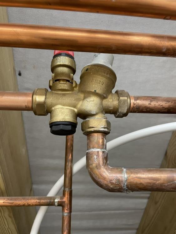

ok boost a main all installed.
Mains in which is MDPE goes into 22mm copper with a check-valve, this then goes into 22mm>28mm into the inlet of the pump.
From the pump i have a 28mm > 28mm connection to the accumulator tank.
The outlet of the pump is then 28mm out reduced to 22mm which connects onto existing 22mm PRV which then goes off to feed megaflow and balanced cold.
Pressure on PRV gauge used to be 2-2.5bar and now reads 3.5bar (this is what i set it to)

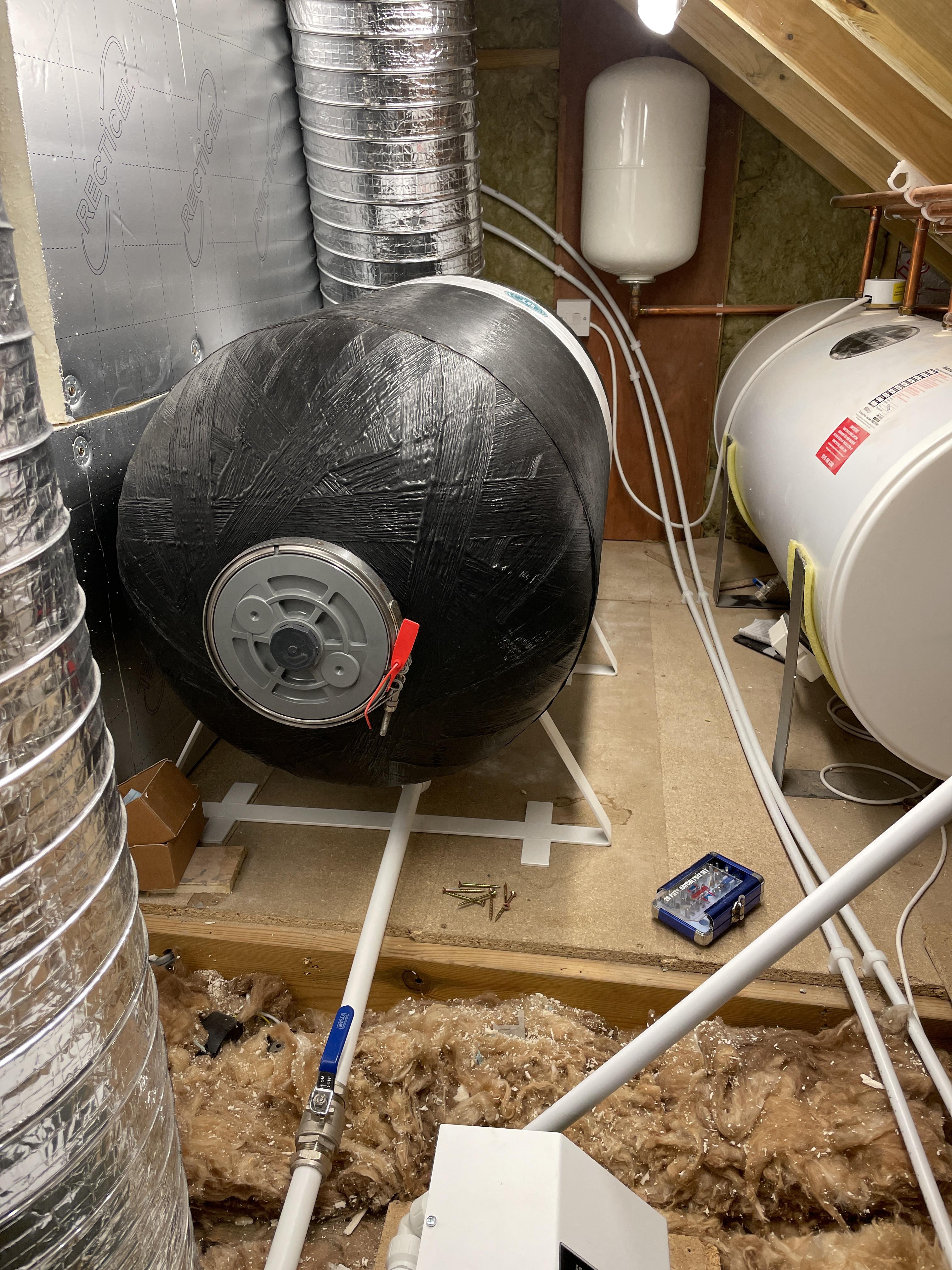

shower performance has gone up by around 30%
my PRV is set to 3.5Bar
the mains comes in from the street via a MDPE pipe which then goes into 28mm copper which then feeds directly to the accumulator pump.
The pump then pressurizes the black storage tank (as seen in photo) upto 6bar.
The pump is on a timer and set to come on 3 times a day (as its noisy even with damper matts and sound proofing)
It has made a difference as i said around 30% but its not worth the £3000 it cost.
The pressure of the storage vessel drops very quickly im trying to speak to the manufacture to see if it can be set to go upto 7-8bar so i have more pressure for longer.
On the top floor shower i renewed the pipe work from 15mm to 22mm this made no difference as the thermostatic mixer i guess still reduces everything to 15mm.
Dont get me wrong the shower "feels" stronger i just wish it lasted longer, in the rest of the house no real major difference on taps etc

On 24/07/2021 at 18:44, tomcoleman said:
ive been emailing the manufacture for weeks on how to set the pressure via the pump. Theres no controls and says its "pre set" act factory i presume if i took the cover off there would be some type of USB connector but would need the software to adjust. Out the box its set to come on and charge at 4.0bar and switch off at 6.0bar thus storing 6bar of pressurized water in the vessel.
The pressure drops rapidly from the vessel, for example on a full charged (charged to 6bar) if i have a shower for around 5-8mins it will drop below 4 bar then pump will turn on and try to start charging the vessel again if im showing in the window when the timer plug for the pump is on.
Accumulator vessel is undersized.
A pre-charge of 1.5bar vs 6bar cutoff will see the diaphragm being exercised a heck of a lot further than I would ever specify in a design for any of my clients installations tbh. The upshot of this is a lot more % of stored pressurised water vs redundant air space in the accumulator, but it will massively shorten the lifespan of the diagram ( aka bladder ) too.
I never fit less than 300L in a family home with a poor cold mains, and set it to accept 50-60% water ( max ) to give the vessel / bladder as long a life as possible.
The reason you run out of water so quickly and the pump starts up again under duress is down to incorrect specification alone. I would add at least another 1x accumulator of Dili mar or slightly bigger size to improve things.
The pump also has a limited lifespan and this cycling will ultimately see that needing changing sooner too.
FWiW I have never fitted a charge pump to a mains, even ones where I can p**s quicker than the water mains, instead just fitting much bigger acc’s and leaving them to be pressurised off the static head of the cold mains instead. Works extremely well.
In my experience of over 2 decades of installing these devices on multi-occupant dwellings with poor to very poor cold mains, I have not once fitted a pump to the cold mains, instead it’s just been down to specifying the correct size acc’s and the results have been excellent.
